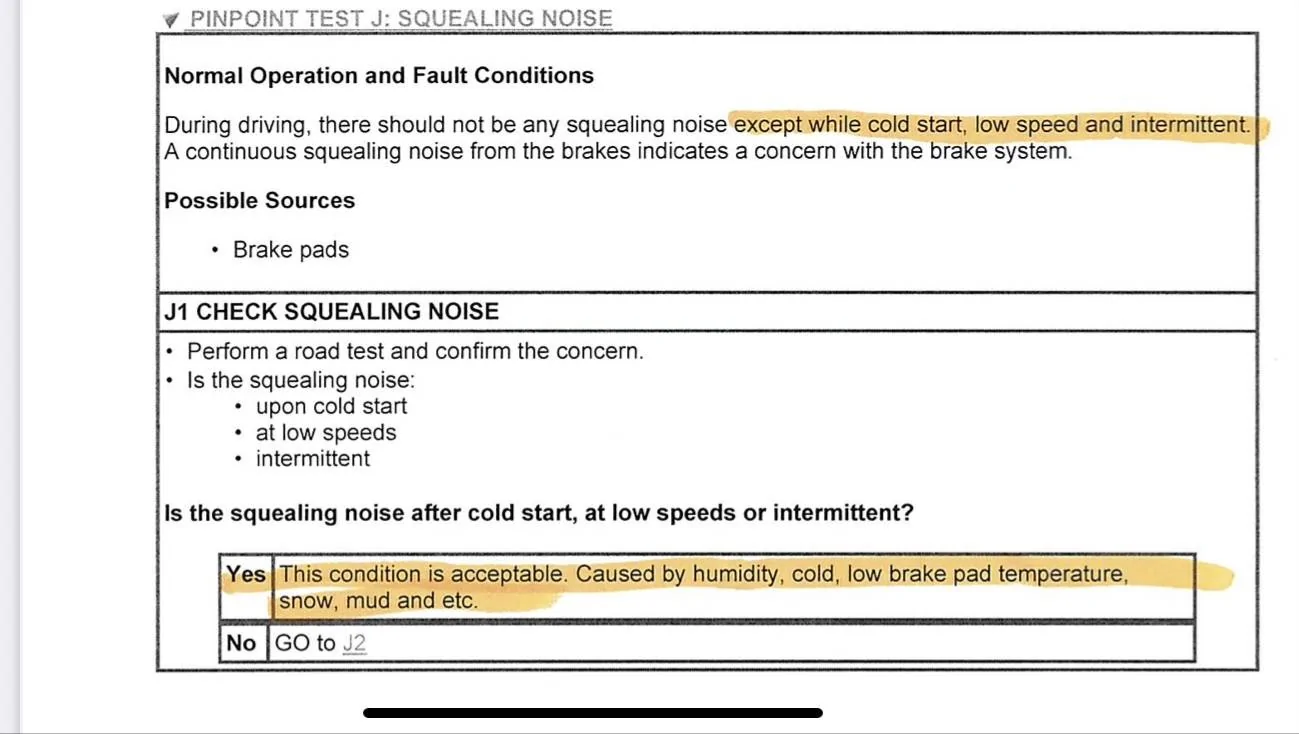

I have a 2021 Big Bend that I absolutely love, other than my rear brakes squeal like a New York bus. It only happens in reverse on start up when it is cold or wet outside (so basically all winter). At my house pulling out of the garage ever morning is one thing, but is embarrassing leaving work each day and after a Sunday morning church service.
I took it to the dealer, where they verified it. In fact, one of the service reps has a BS and she confirmed ā€œmine does it. it’s terrible, but they say ā€˜Ford states it’s normal’, but I think it will eventually be recalledā€. She even provided the attached documentation.
How can this be considered normal? My Toyota 4Runner’s brakes don’t do this. My 2012 Ford Escape’s brakes don’t do it. In fact, no vehicle I know of considers this normal. It’s worse than a New York bus on a new Bronco Sport…but no warranty repair or fix?

So intermittent basically covers ALL the time they do it, LOL. Mine does it all the time now, it used to be 'intermittent'. Hopefully they find a fix. I may try something like changing out pads and hardware on my own, Ford's answer to this doesn't really instill confidence in me regarding their ability to make fixes. Other than the brake noise, I love the vehicle.
