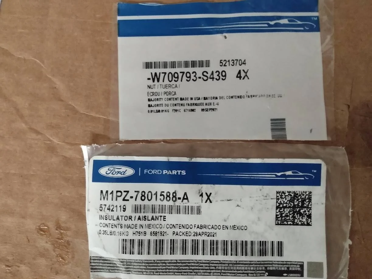

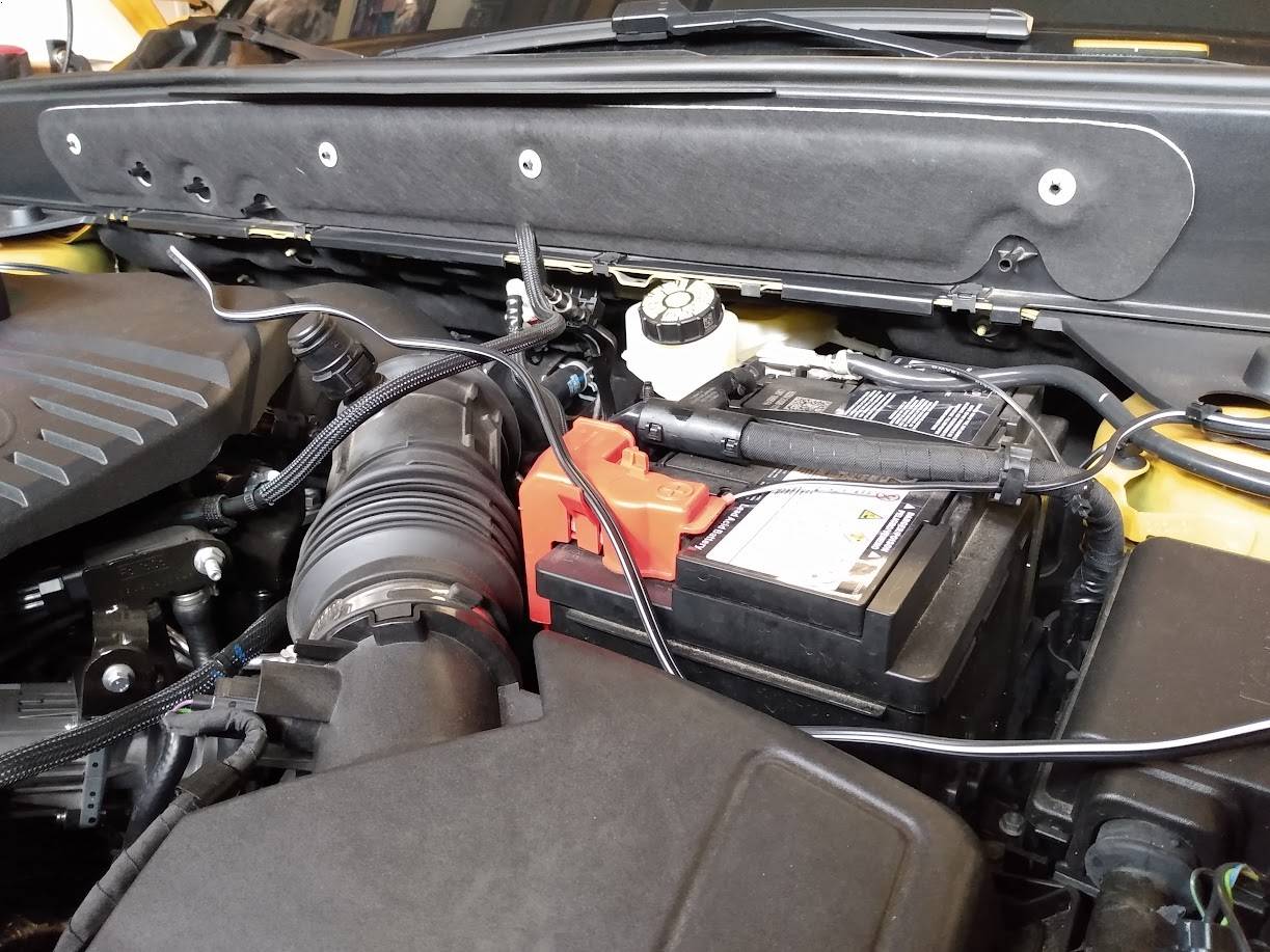

Today's change: The other, other cover.
Had the engine cover and the hood insulator from the factory. But there is another... for the firewall. As far as I can tell from research, the Outer Banks get these installed, but not other trims or packages. I expect at least +10hp and -10dB of cabin noise for the effort!
Ford Bronco Sport Project O'Bronco IMG_20220505_115018143
Ford Bronco Sport Project O'Bronco IMG_20220505_114938938
Total cost, about $50 a.k.a. 10,000 Ford Points including the push-retainer hardware.
Line up the insulator and install the 4 "nuts" to hold it. I used an 11/32" nut driver to push even and firm and save my thumbs; and also face it, what else can you use an 11/32" driver for these days?
Time required: 5 minutes.
Skill level: 1.

Is that part# for a bag of 4 nuts or do I need to order individually?

I might have missed it but what does the other insulator do?
That's a bag of 4.
Ostensibly it will soundproof a bit. Emphatically it uses those plastic posts that otherwise sit there doing nothing!
