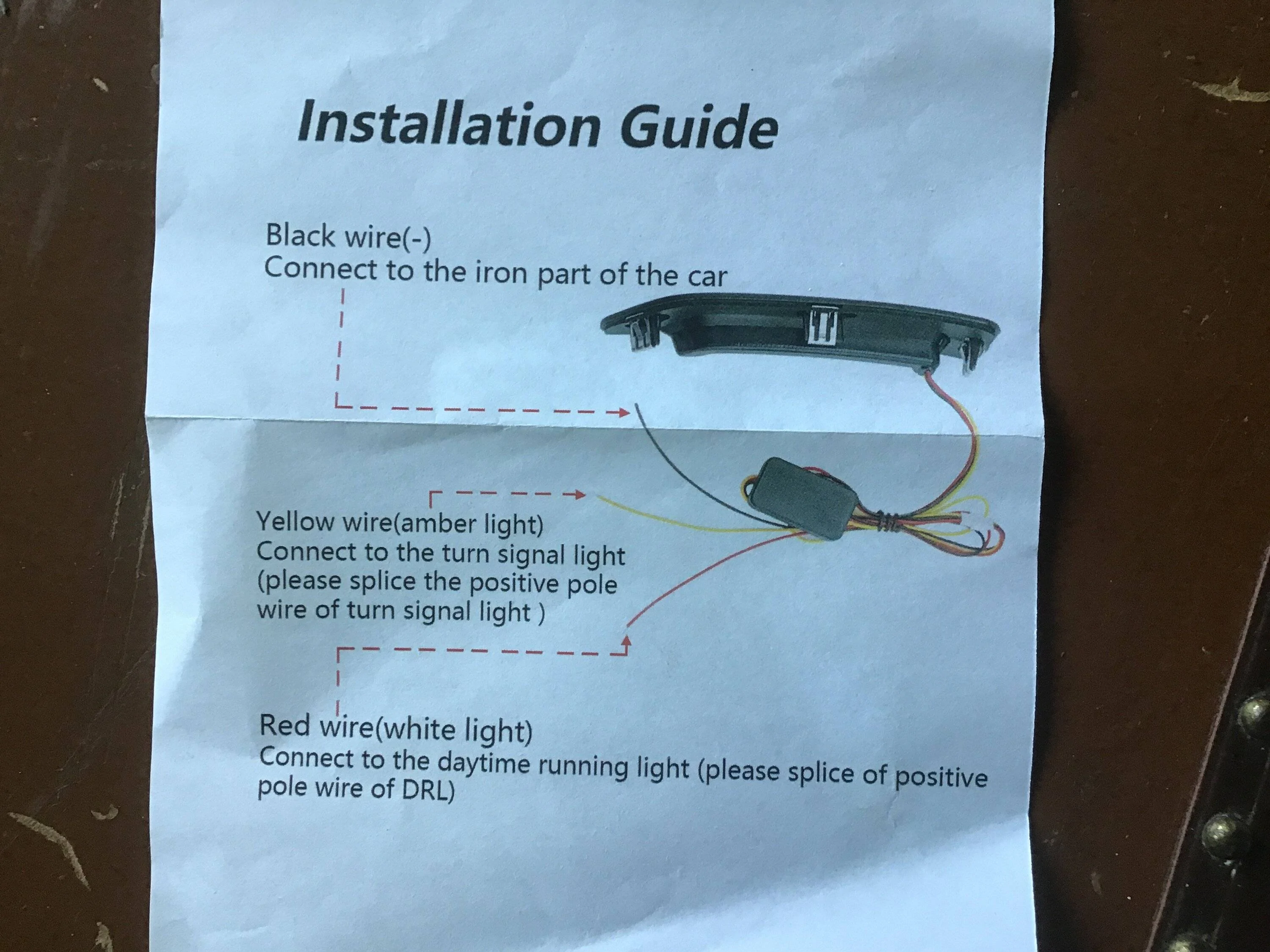

I bought the DZD marker lights with duel colour from Amazon. Mine has three wires. Black/ground. Yellow/turn signal, amber light. And red wire/daytime running lights, white light.
lhave them installed, just need to wire them in to harness. I understand my ground and turn signal but I have no idea where the running light wire of harness is?
My schematic drawing skills are rather limited.
Can someone tell me what pin # and colour the running lights are. I have the baby BS 2022

Run the red ones down the fender and connect them to the blue wire behind the lower side marker lights, those'll get you the DRLs. Went through this myself the past few weeks, this thread was super helpful: https://www.broncosportforum.com/forum/threads/tectico-led-fender-light-side-marker-install.6707/

I’ve installed these lights but mine have 3 wires. Ground and turn signals,amber and running lights,white. I know what wires are ground and turn signal but I can’t for the life of me find the running light wire to connect to. I’ve tried with the multi meter and can’t get a reading on the other wires when I turn on the running lights. Meter shows reading for signal lamps so it’s working fine.
someone suggested coming off the lower small rectangular amber running light blue wire but it seems impossible to get at without taking off bumper.
Any idea anyone which wire out of the headlamp box the daytime running light is?

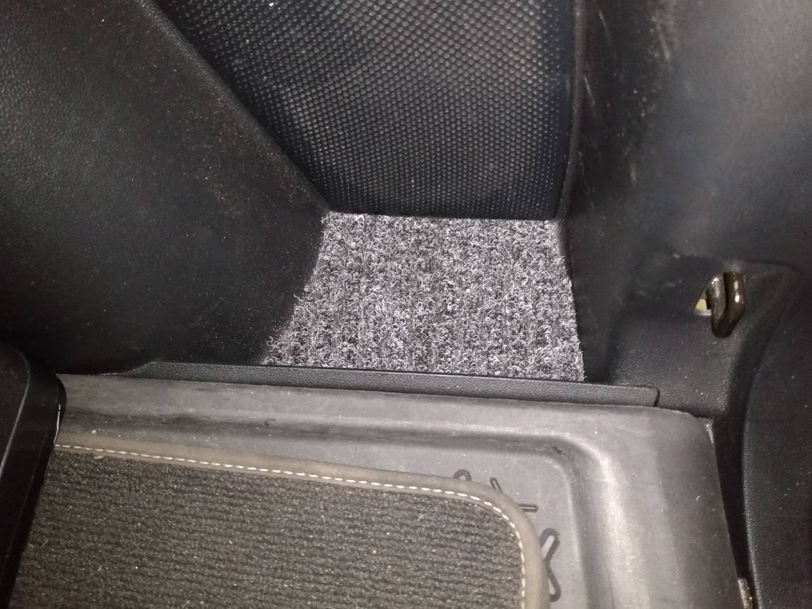

Haven't used this thread in a while but here's something easy I did today. about 20 mins invested.
Installed custom cargo area carpeted inserts. Before:
Ford Bronco Sport Project O'Bronco IMG_20230426_160038819
Scrap piece of runner on hand. Previously bought to cover the garage-to-house stairs. You can see this is about 8x10 in total and you can buy it by the foot at your favorite big box hardware place.
Jammed a piece of paper into the space and trace the edge with pencil to get a rough outline. Two sides seem to be parallels and so you really just need the front and back edges.
(Protip: you can use the pencil in the pencil holder if you have one)
Cut the shape out and drop it in to check fit. Transfer that to the runner when you are satisfied.
(Protip: check orientation before cutting or you'll mirror the shape and the two sides are not identical)
Cut with a boxcutter, carpet knife or scissor.
Ford Bronco Sport Project O'Bronco IMG_20230426_160026461
Factory carpeted mat in photo to compare. I keep a bottle of sanitizing wipes here most of the time. I don't know if anything will be quieter, but it won't be noisier.
