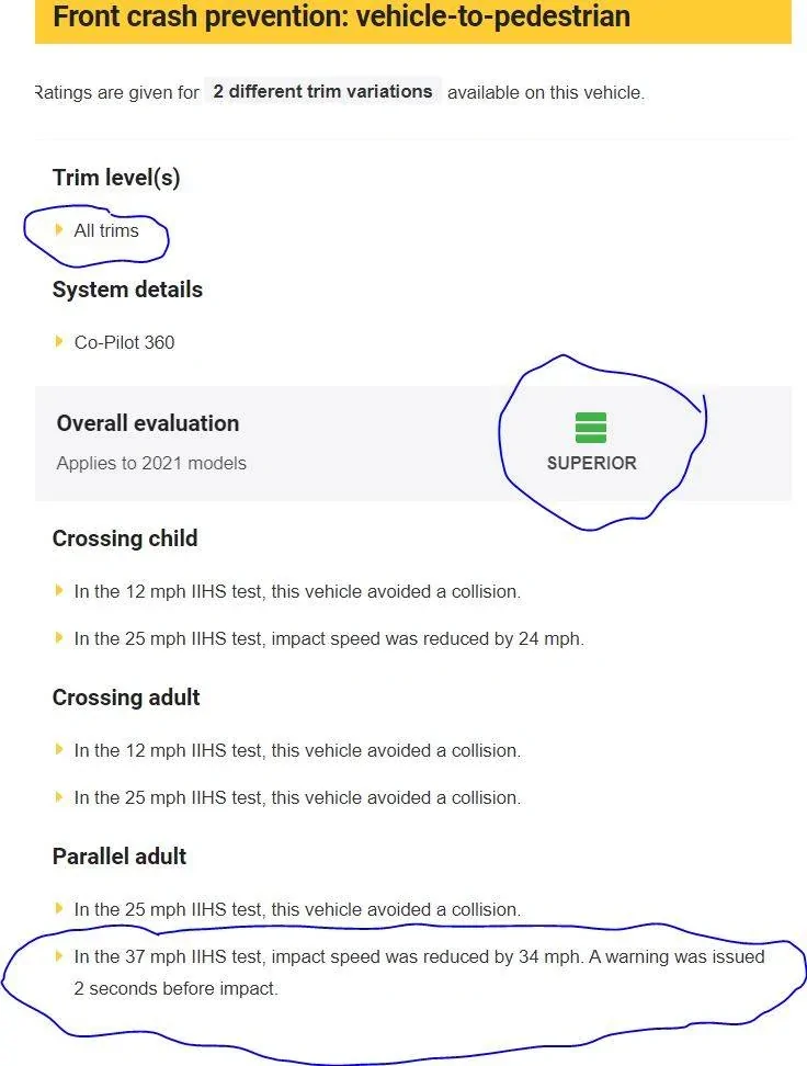

Unfortunately those videos were made before any of us knew the bronco was coming out again. You can still use the iihs site to compare but be aware they mainly test at extremely low speeds. They test at 12 MPH 25 MPH and 37 MPH. The bronco actually hit the test dummy at the 37 MPH test and we still got the highest grade. I know a lot of people are NOT going to be happy about this but the pre-collision system is a joke and these grading scales should be false advertising. This isn't just the Bronco or Ford, all of these pre-collision tests are lacking. Check out the competitors in the search box in this site.
2021 Ford Bronco Sport (iihs.org)
Ford Bronco Sport Pre Collision system is not working Capture.BRONCO.IIHS
