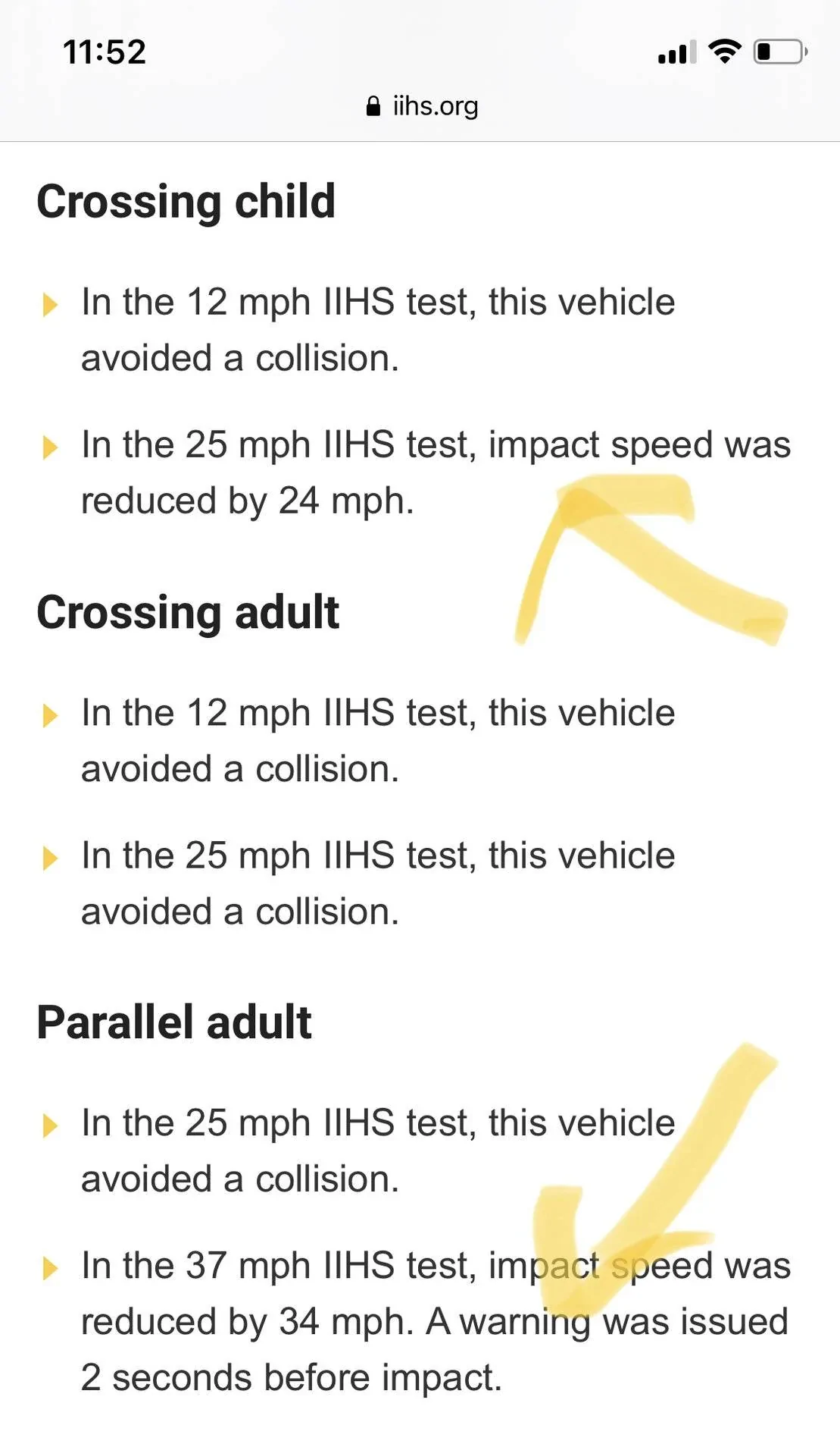

Does this mean dummy pedestrians were hit during testing?
Ford Bronco Sport Pre Collision system is not working D7F5F838-608B-4B62-A7DF-A23EBE97895E
Yes Vince and Larry took a 1 mph and a 3 mph hit but a person can survive those though. 25 and 37 mph and a person probably wouldn’t.
