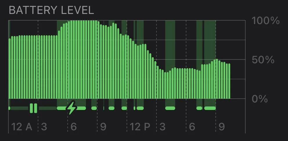

I noticed the same thing today doing some driving out of town. I took off about 10am. There wasn't much charging going on while it was plugged in and that part about 7pm looks like I lost power. I remember checking and it was about 39% and after I drove around for a few minutes and checked again, it was at 38%. I started suspecting an issue shortly before that and kept monitoring it.

My battery usage is showing Geico App used a lot of battery today. I signed up for DriveEasy to try and lower my insurance premium so that's probably adding some to it.
This is a big difference to my mom's CR-V. I can get in around 50%, drive an. hour or so with Maps and Music playing through CarPlay, and be at 100% when I get there. The same thing would happen with my Accord but I used a 12v plug adaptor.

Were you using the USB- A or C? If using the A try and use the C and see if you notice a difference. Also iPhones stop charging when they get too hot, and my iPhone 12 often gets too hot if I’m driving and I have the phone in the passenger seat in the sun. I’m in Florida so it’s pretty hot.

I was just reading where iPhones now make decisions about when to charge as an energy saving strategy. Who knows what your phone is thinking ?

I tried a USB-C cable I had laying around (bought it awhile back but don't really have a need for it). My iPhone stayed above 95% today. I tried to stress it out using Maps and watching YouTube (I was listening) while connected via CarPlay.
I don't think it was getting hot. I keep it in the cubby near the USB ports and it was pretty cool today, both inside and outside the BS. I might get a 1-foot cable to declutter and keep me from picking it up.
