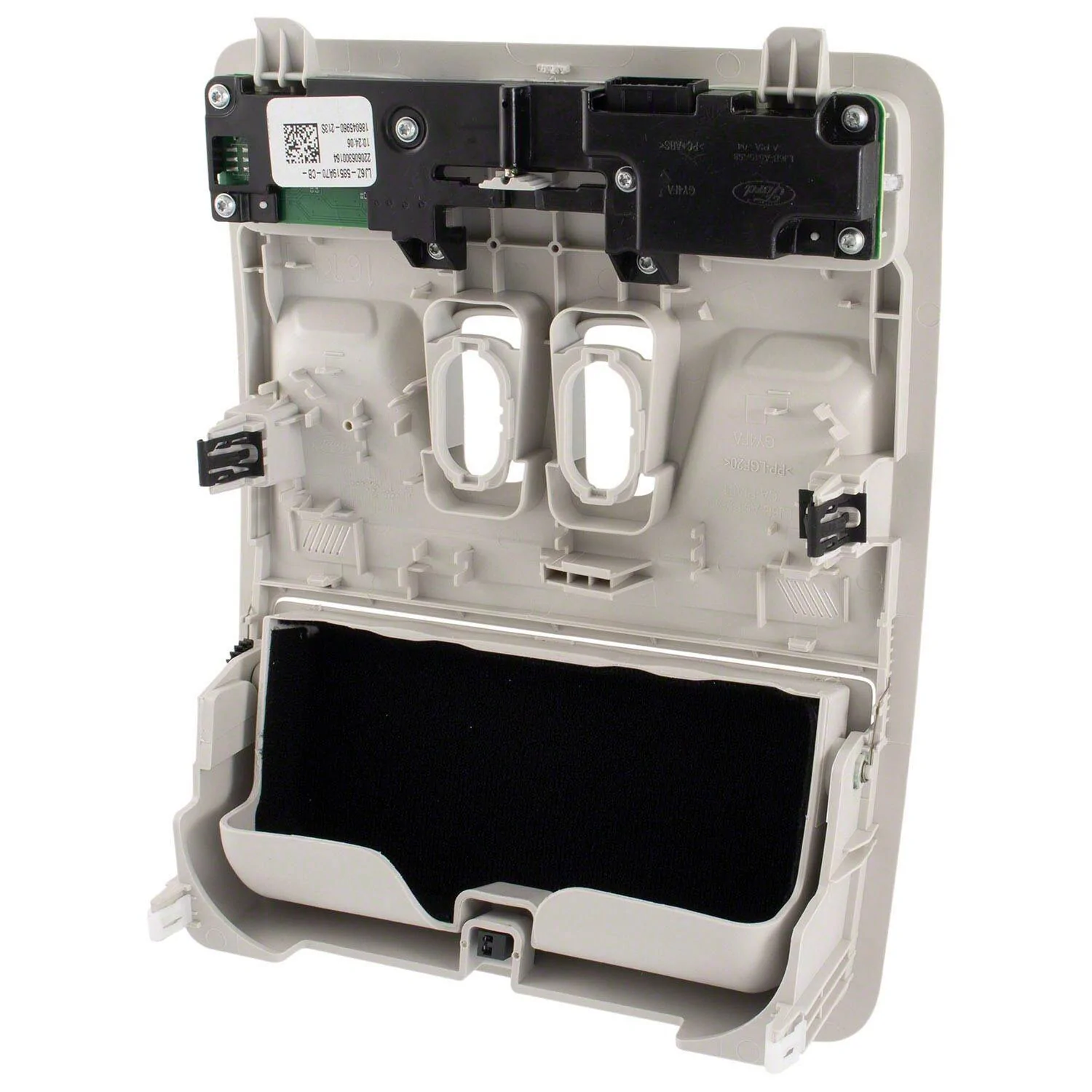

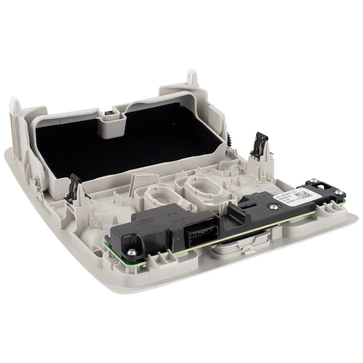

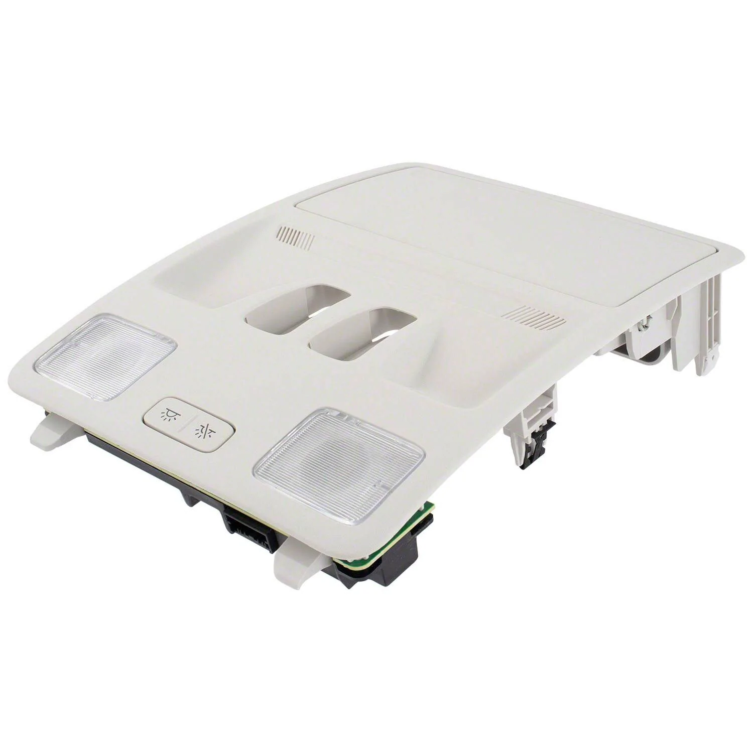

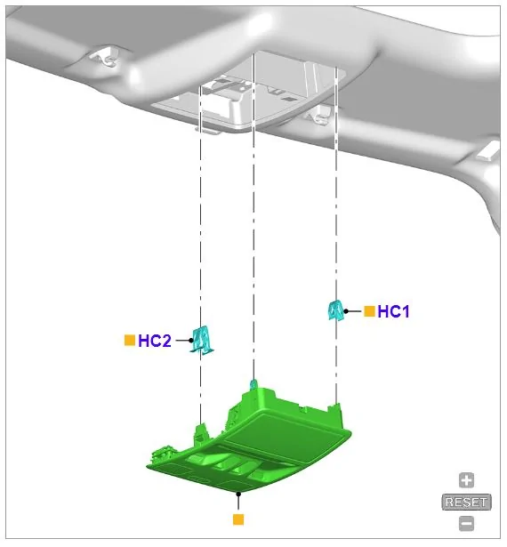

It's similar to the console I replaced in a Ranger.
There are 2 pieces. There is a cover and then a part actually mounted to the roof under the headliner. The cover pulls off. You pull at the sunglass end with a trim tool. After the retainers pop, you have to pull it back to release the front tabs. There are electrical connections so only go as far as the harness allows until you unclip the electrical harnesses.
Here are the best pics I could grab, from the Ford Parts website. I know you grabbed a stock photo with the sunroof, but both parts are pretty similar.
Ford Bronco Sport Overhead Console Removal? 453294
Ford Bronco Sport Overhead Console Removal? 453271
Ford Bronco Sport Overhead Console Removal? 452994

Question: What is the best way to release all 4 clips while keeping the console from slipping back into position? Do people use shims?
Sadly, the reason we have to remove the console is that for the 2nd time mice have made a nest up in the headliner. The first time was not bad because the nest was near the center dome light. I removed the light and a shop vac took care of the nest (the mice were gone).
This time, I see from the photos that there is a second piece above the console that is riveted in place. I'm guessing I won't be able to remove the nest material with that piece in place, but I'm not anxious to remove those rivets.
Any suggestions? Can the headliner be pulled down, away from the piece that's riveted?

I'm not convinced from that other pic the upper piece is riveted. I think the two "rivets" mentioned are actually bump stops for the glasses holder. It could be there is a plastic push pin on the harness holding it, or screws in the recessed holes? Yeah, I would use a pair of trim tools to keep the first set unclipped while getting the others.

You're correct -- the "rivets" are soft rubber bump stops for the eyeglasses holder.
I ended up discovering an easy way to remove the console using an ice scraper like this one:
Ford Bronco Sport Overhead Console Removal? 1757385304955-8s
I slipped it between the console and headliner in an attempt to create a gap to make it easier to slip a homemade tool down to the clip. I pried gently on it and the front corner popped free. So I repeated the process for the other 3, I did not use much force and everything looks good.
The mice really made a mess on the topside of the console. We got it cleaned up, but with all of those rectangular recesses it wasn't easy.
The black piece above the console appears to be glued to the headliner. That's really limits access to the area above the headliner. My wife was able to get most of the nest by sticking a crevice tool through an opening in the black piece.
