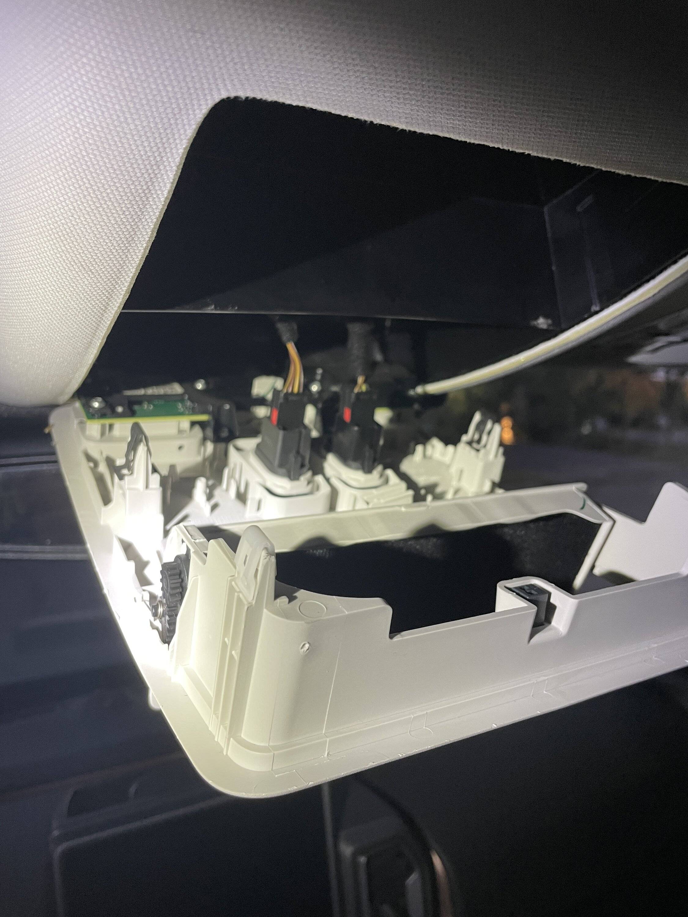

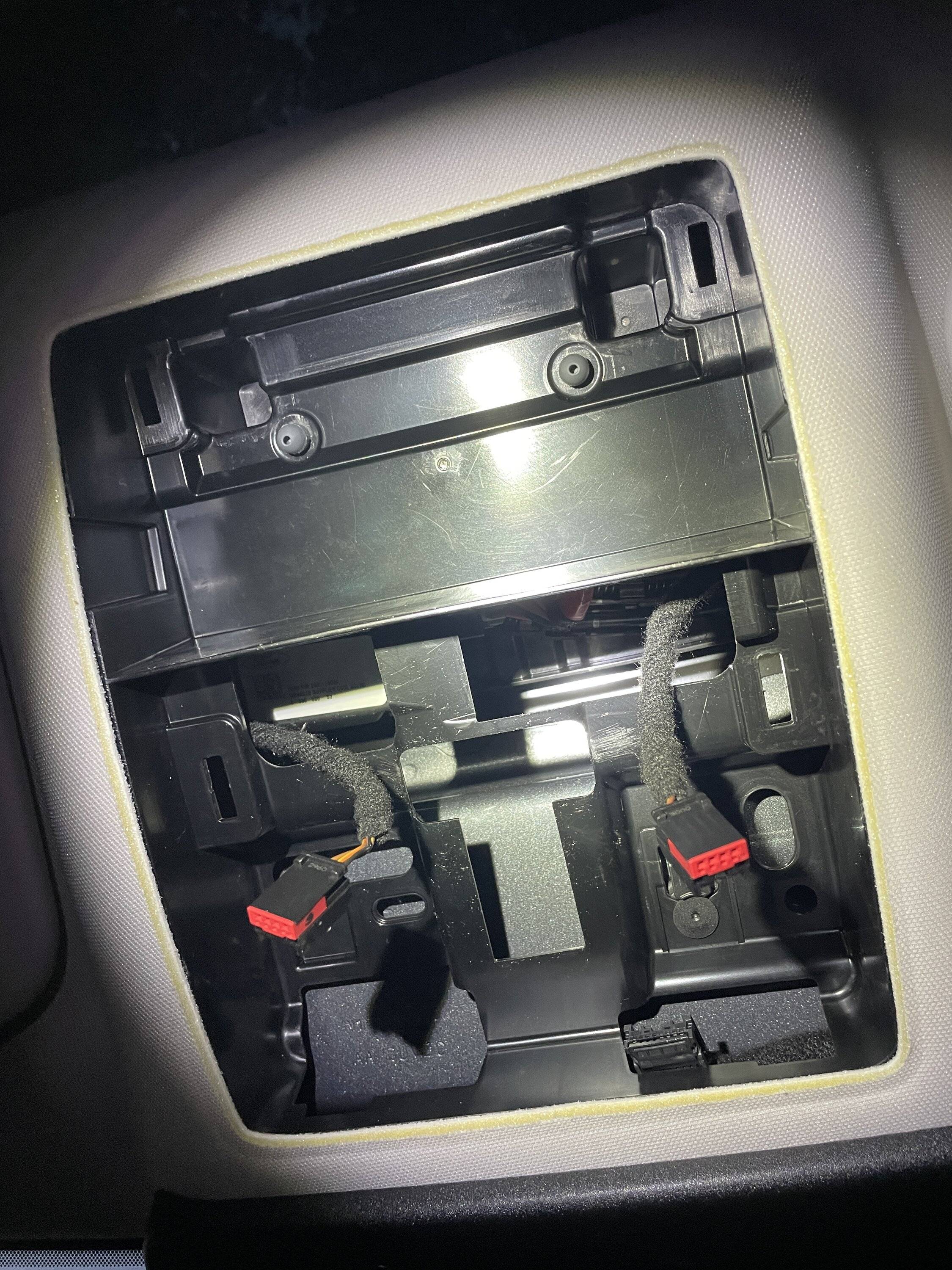

I finally got time to do this. The back clips, close to the sunglass lid, unclip easy with a trim tool. The two other ones on the sides, are a little bit harder but eventually come off and then the whole thing drops. There's 3 connectors to unplug and the whole thing slides back (Thanks Glamdring70)
The other half, located between the overhead and roof cannot be removed. It seems to be glued to the trim.
I managed to cram a rectangular piece of insulating material between the roof and the trim right on top of where the sunglass holder space is.
I used something called "Adhesive-Backed Aluminized Fiberglass Heat-Shield Barrier" that I had left from a motorcycle project. It certainly it more insulation than I needed, but I had it lying there, so...
Easy mod, good for the warm months when you leave the car under the sun and don't want to burn your face when putting the glasses on.
Happy now!

That secondary plastic piece looks to have two round rivets towards the back (front in your pic) holding it up onto a roof bracket.
Palom0
Apr 25, 2022
35
32
Argentina
Bronco Sport 2021 Wildtrak, Carbonized Gray
Could be, I didn't see them at the time. But in any case, I didn't need to take it off. You can just slide a piece of heat barrier sheet through the openings where the connectors hang.
