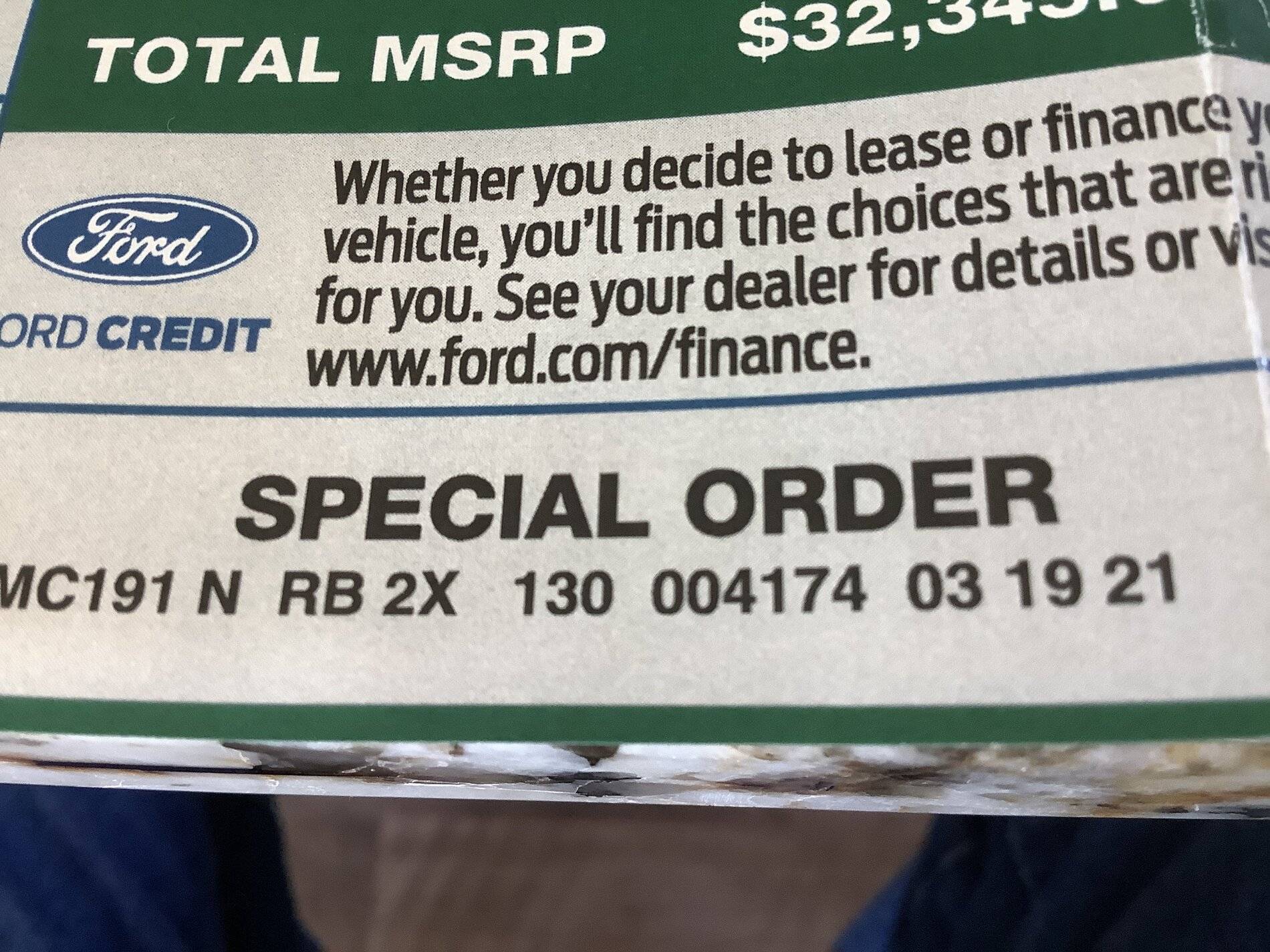

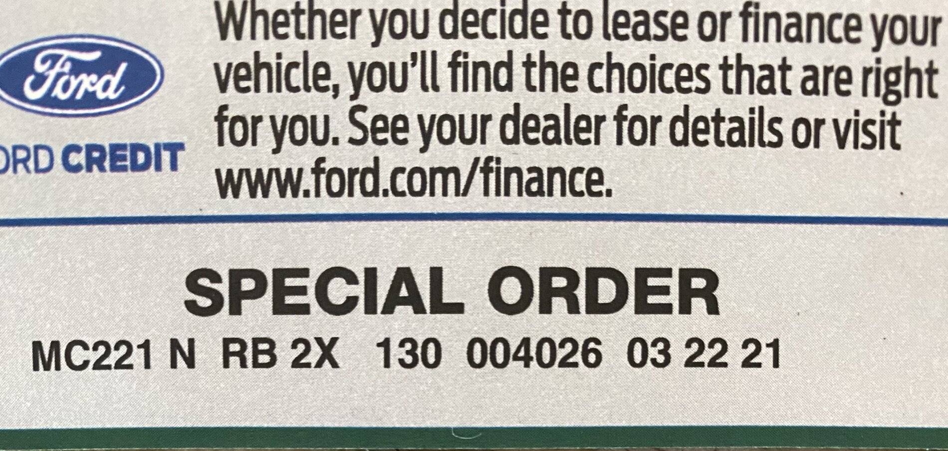

That's interesting. Mine was built three days later on 03/22/21. I wonder if there was a batch of faulty transmissions during that period. Anyone else with the "BRRRRT" noise want to provide their build date?
SilverVVolf
Rad
Apr 27, 2021
173
191
OK
If you have your window sticker at the very bottom you will find the “born on” date. Our is 3/19/21.
Ford Bronco Sport On this episode of, "Is this noise normal?"... image
Well that completely conflicts with what Ford told me mine is. That date at the bottom of my sticker, doesn't even show up on my Sport's journey.
