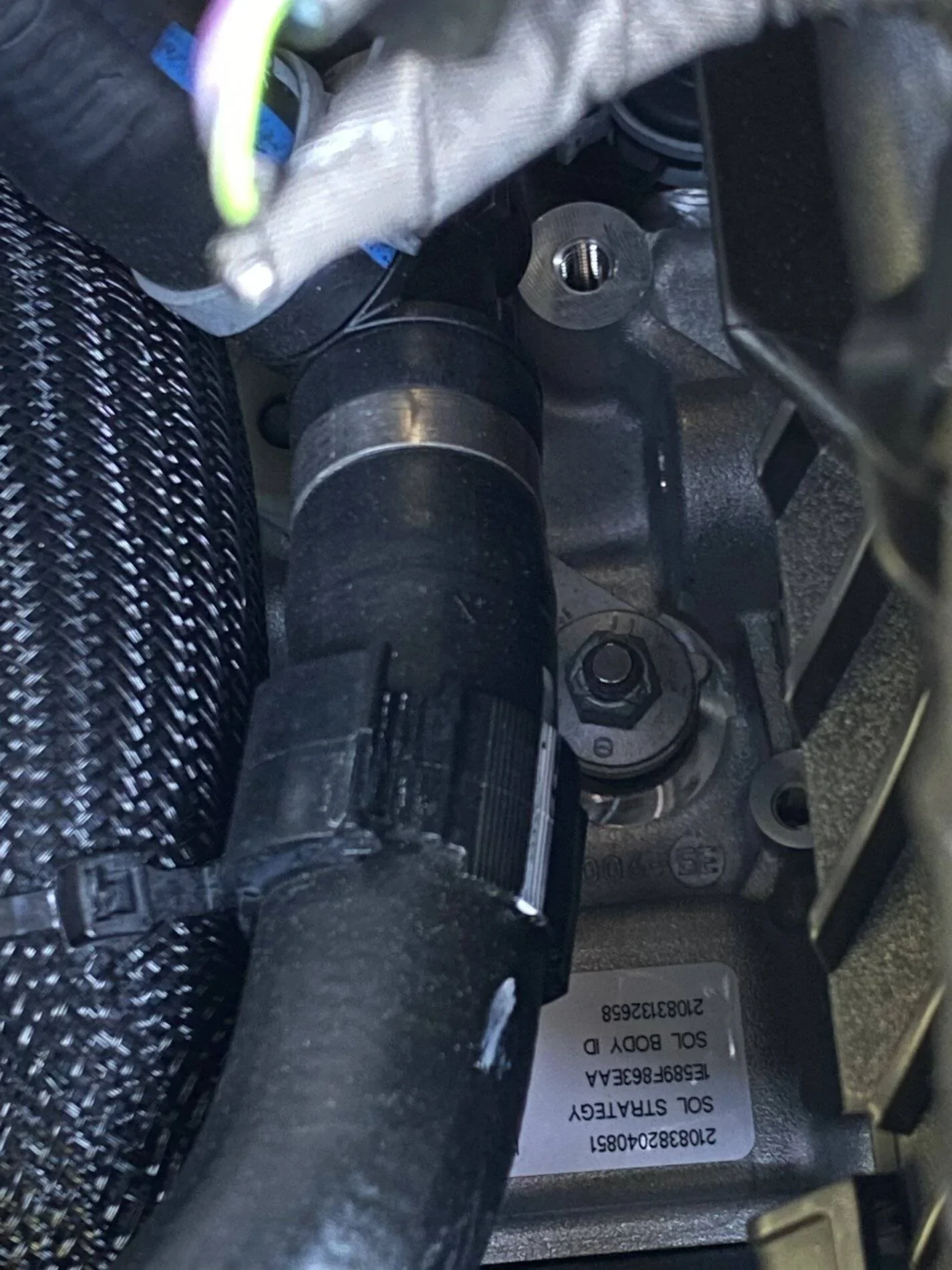

Ok went in this morning and they tightened that shift cable. It’s nice to not have that rattle. As far as the transmission it seems to shift fine. I did find a part underneath the hood that had threaded holes for bolts that are empty which I found odd. Dealer didn’t have another bronco on the lot to compare it to, so they couldn't say for sure. So I’ll probably keep my appointment at another dealer to have this checked as I find it odd. If you guys wanna pop your hoods and compare please respond. I’ll post some photos. Please share any thoughts.

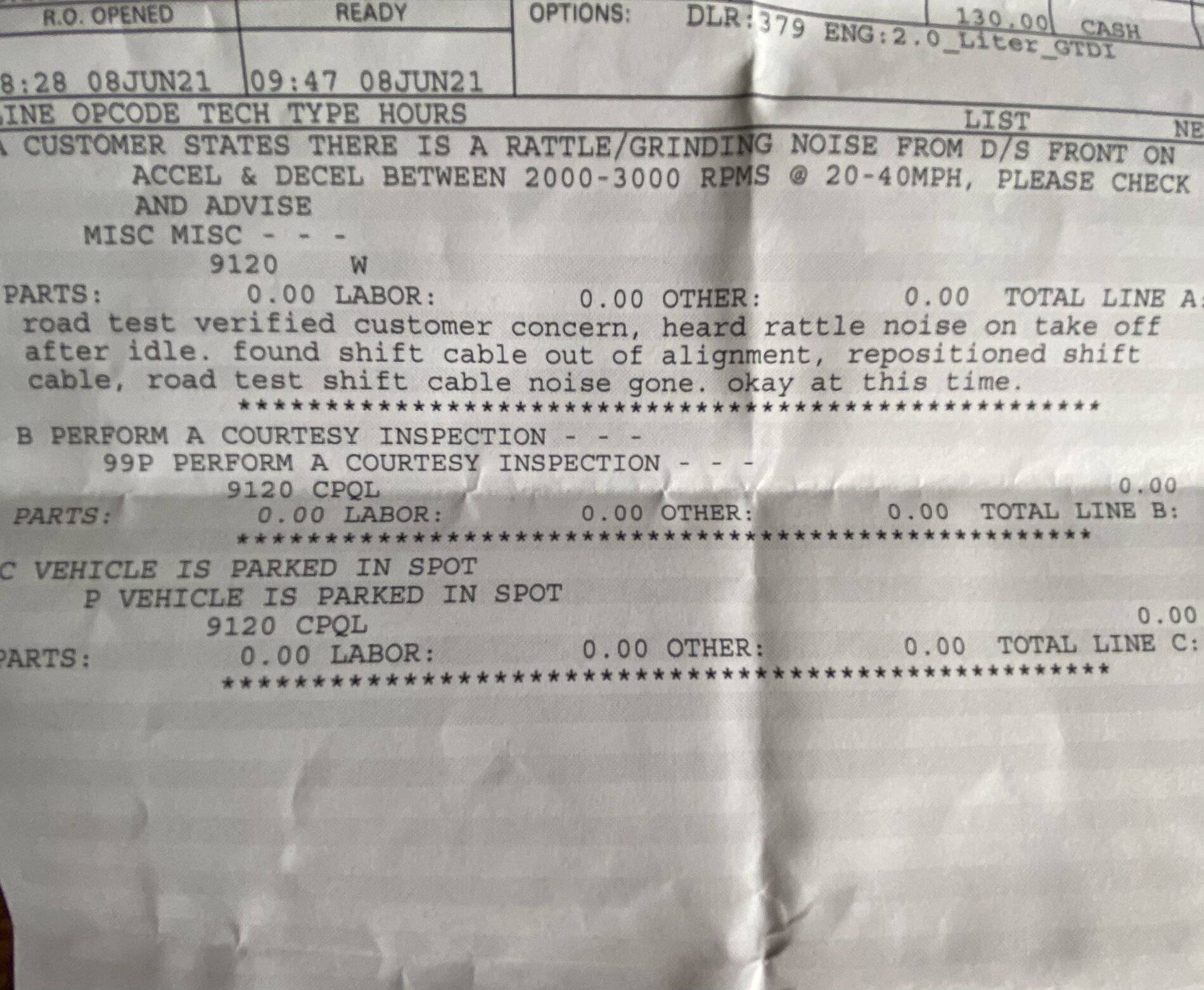

So they tighten cable now no noise?
The rattling and grinding noise while downshifting in low RPMs is taken care of I don’t hear it when I turn or anything however the general sound of the engine being ATV-ish is still there but I’m not sure if that’s me being neurotic or there’s actually a difference in the way other bronco sound they didn’t have one for me to compare to

So I went to another dealer today because I’m neurotic and checked the part with the unused holes in the top. Check, it was there in the base model i saw so they suggested that they interchange parts with the escape and to attach it to the bronco must use different holes. And he let me sit in a big bend, and then sat in mine, engines running/revving and he didn’t think there was anything going on with the sound of my engine. So I’m just nuckin futs. But hey the Badlander is all good.
Sounds like yours has a clean bill of health...great news!

Did a ride along with the tech. Didn't go like I'd hoped, the rattle was a bit softer than usual and he had trouble hearing from the passenger side (as most have been saying). The issue with th shift cable seems to be very likely, though the tech says it's not really a shift cable but a neutral cable. He popped the little access compartment to pull on the cable (under the steering wheel) and I could no longer replicate the nnoise. Said that the BS and the EcoSport share many similarities under the hood and that EcoSports are plagued by the rattle (same neutral cable feature). Said the bulletin posted for that issue on the EcoSport doesn't truly fix the issue, and it's more of an annoyance than anything. Leaving it for further inspection and to have some touchup done on chips in the paint/AeroSkin II deflector installation
