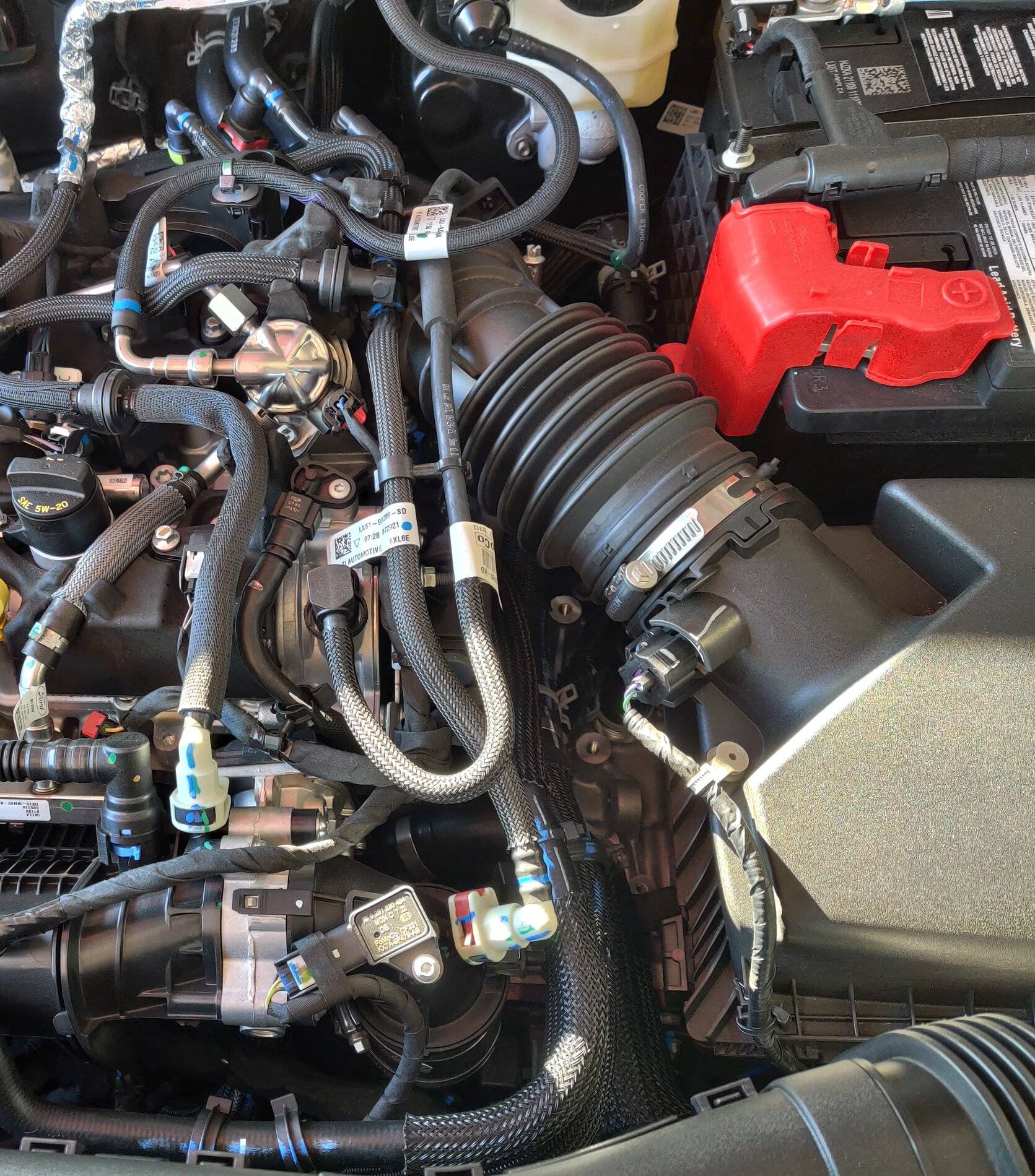

I've been having the same issue, when i start to slow down or coming to a stop i hear a grinding noise coming from the driver's side. I also hear the same noise when im doing turns around 30mph. I took it to the dealership and they didn't hear anything, they probably think im crazy. I've seen posts about disconnecting the park release cable would fix the issue. I took a picture of my engine bay, can someone please help me highlight which cable i have to disconnect? Im scared of disconnecting the wrong cable.
Thanks in advance.

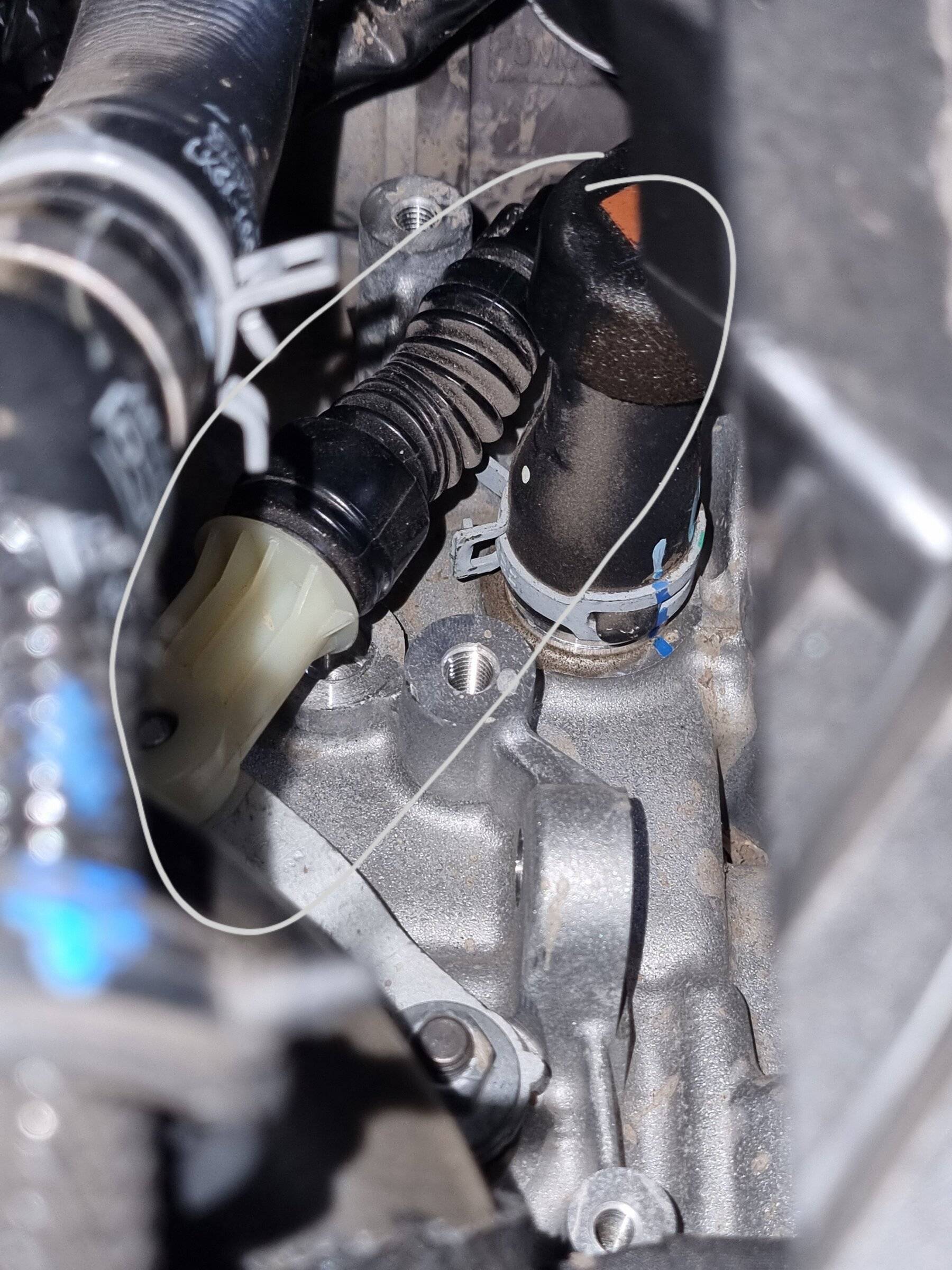

Guys the cable remarked in below picture is the one we are talking about? If it is , from which side it gets disconnected or how exactly?
Thanks in advance

Yes. That’s it. Lift upward on the end attached to the lever, which is the left side of the
Thanks in advance
Ford Bronco Sport On this episode of, "Is this noise normal?"... 20211209_175831
Yes. That’s it. Just lift up on the end attached to the lever, which is the left side in your pic. It just snaps off and on. I used a little screwdriver to gently pry it off. Noise will be gone.
Thank
Thank you! :)
