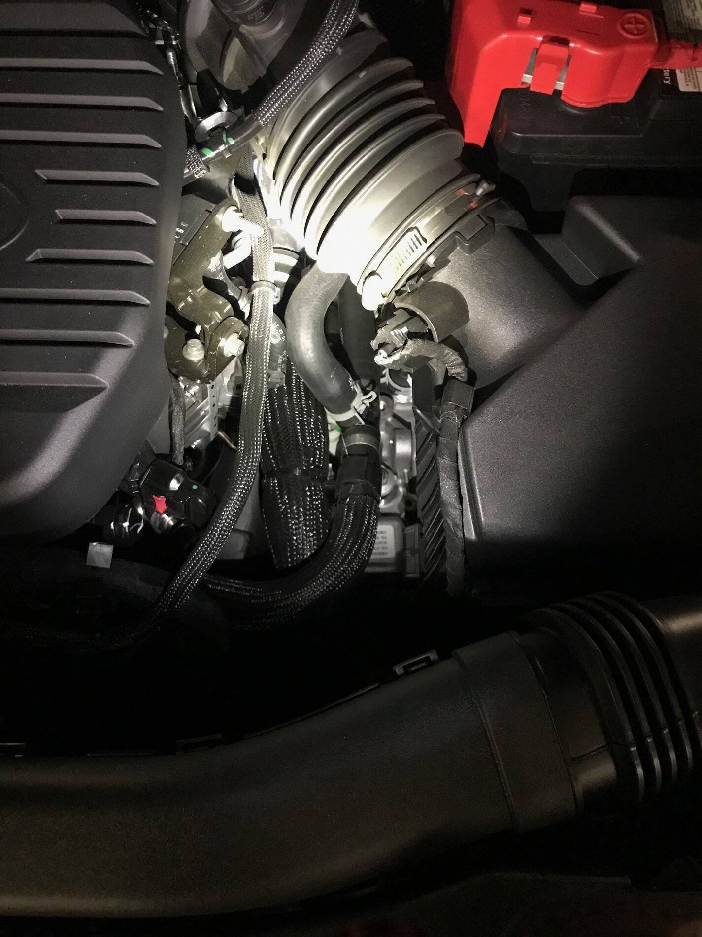

Anyone have a picture on where that noisy cable is located?
It's located under the air box and battery. If you have small hands you can reach down on the left side of the air box and disconnect the park release cable from the transmission as suggested in the TSB on the subject. It just pulls right off. If you have big hands then you need to remove the air box first.
The only reason you will need this cable is in the event you need to get the trans into neutral if need a tow and your battery is dead or some other transmission malfunction. Just remember in the event you need it you need to reconnect it quick.

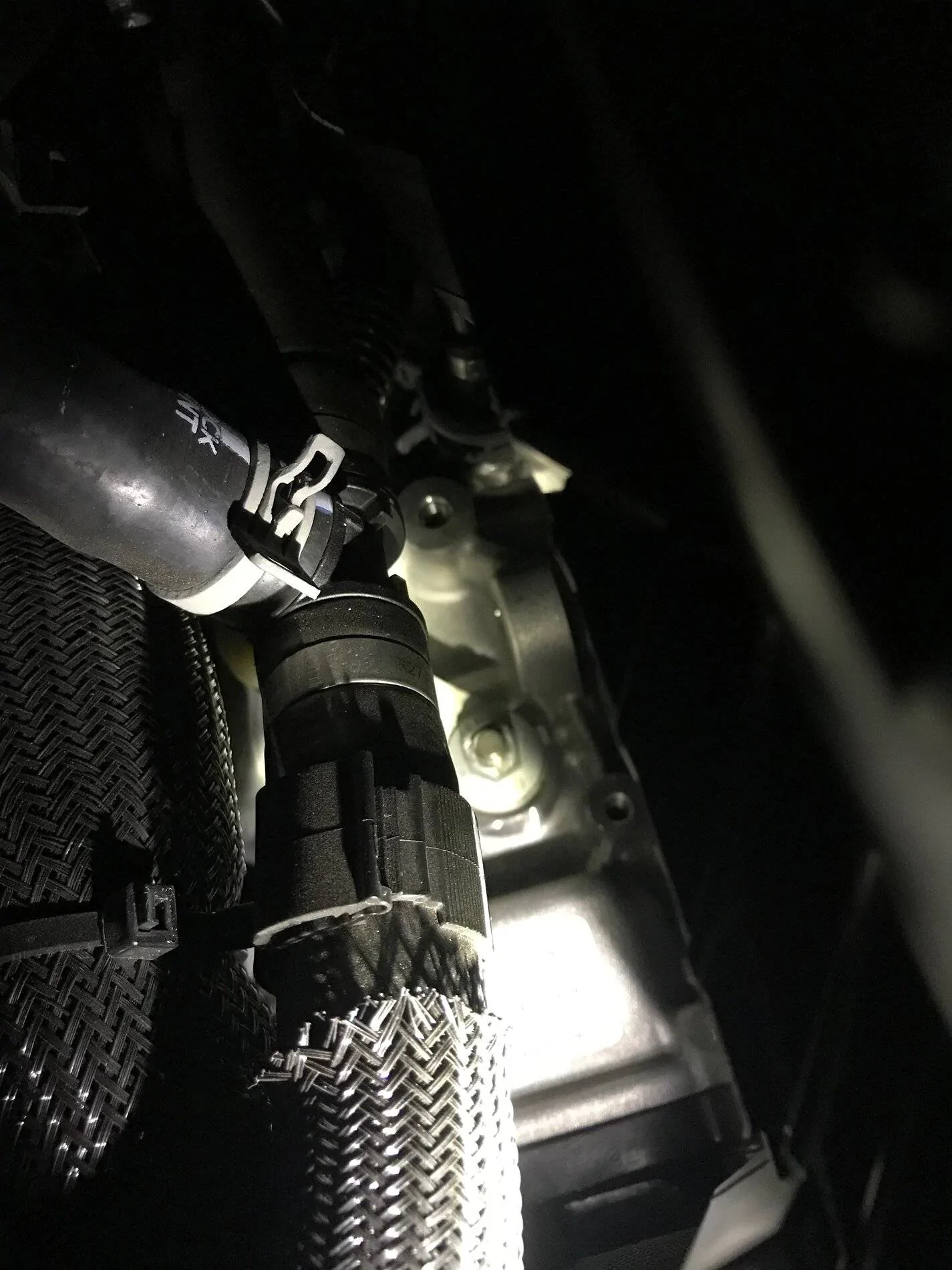

You're referring to the cable-driven sector/lever arm in these photos?
Ford Bronco Sport On this episode of, "Is this noise normal?"... IMG_7565
(lil' space for hands!)
Ford Bronco Sport On this episode of, "Is this noise normal?"... IMG_7566
(cable-nose side of actuator lever arm)
Ford Bronco Sport On this episode of, "Is this noise normal?"... IMG_7567
(bolt side of actuator lever arm)
Yep - that's it. You do not need to remove the bolt on the actuator arm. Just pull the cable bushing off the stud connected to the actuator arm. Comes off fairly easy.
OK, no weird noises that I can spot at present, but will keep it in mind. I took the photos so I have some clean engine bay navigation aids before it starts raining (thus bringing mud) out here.
