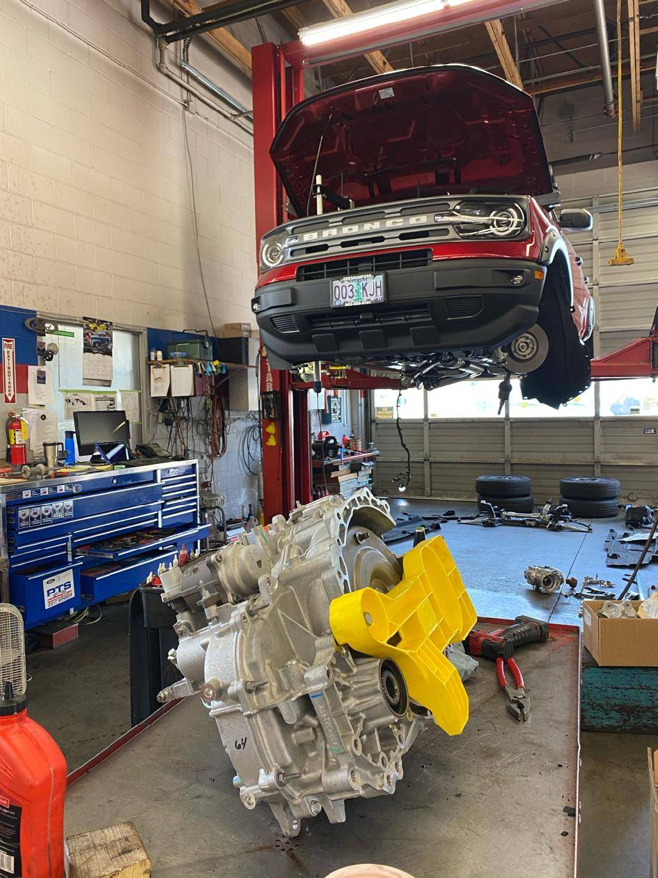

SURE! -
I just picked mine up. The whole transmission was replaced. The constant hiss noise is gone and it does seem to shift smoother. But it still makes the soft rattling noise around 1500 rpms at low shifting. It doesn’t make that occasional growling noise anymore though.
They Tested the transmission pressure and it was leaking air. Thus the replacement. The other rattling noises aren’t related, maybe that noise is really normal.
...But my dealer did hear that rattling noise, and did say that wasn’t normal, and thought they fixed that. I’m tired of not having my car, so I’ll deal with that later. ;-(.
At least I know my tranny won’t konk out on me. Hopefully! ;-)
here is a picture of there work for you-
Ford Bronco Sport On this episode of, "Is this noise normal?"... B81B9A84-7FF3-47AB-8084-53224CB81D63
