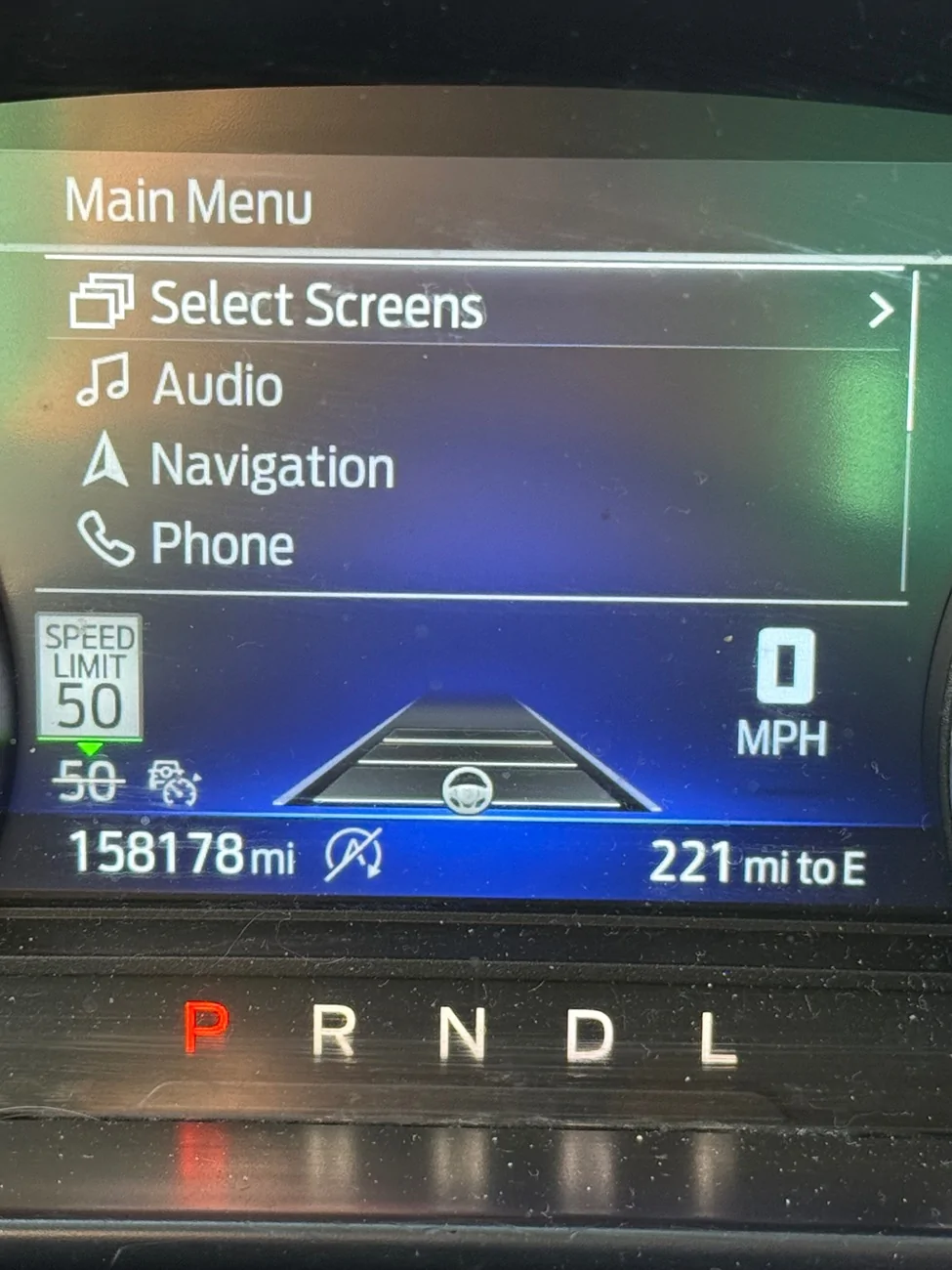

Hi, on my Big Bend I just push up on the OK button until I get the (I) screen I believe, the one that shows oil life, tire pressure etc. Scroll to oil life, hit OK, and it shows the option to reset.

@Me3 thanks but the big bend and the wildtrak have different center dashboard. Probably same system but different screens.
No problem. Maybe you need to enable different dash screens from the infotainment screen?

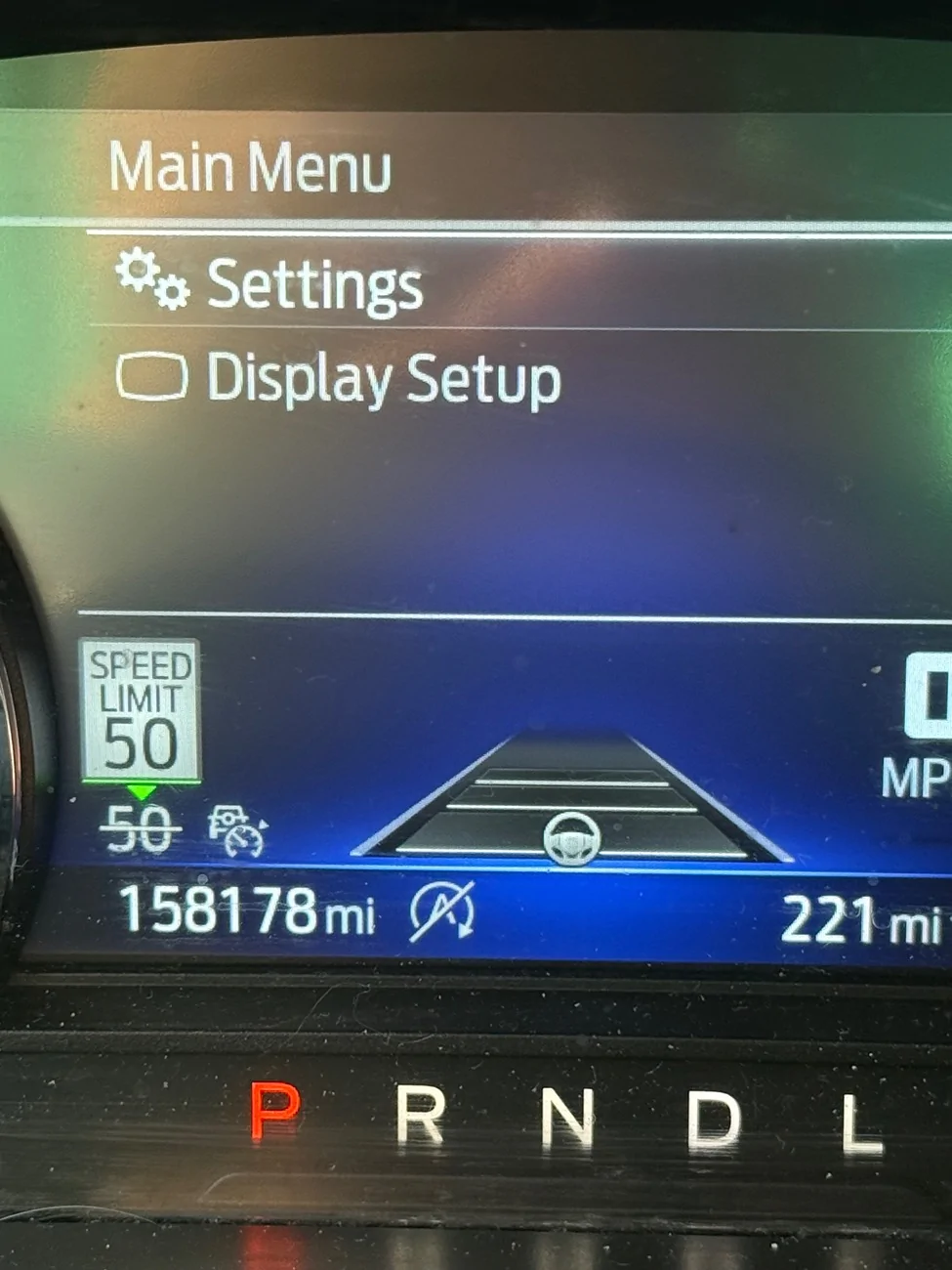

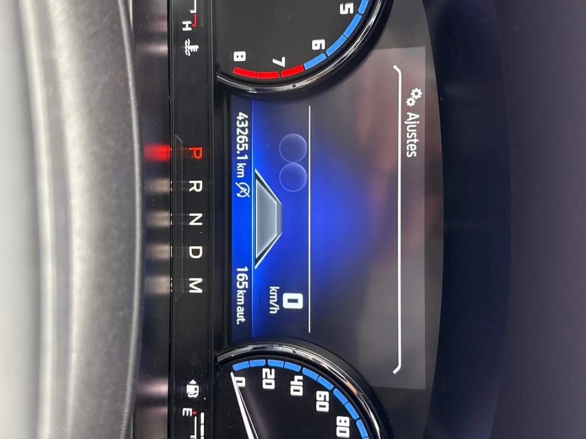

Hello everyone!
I just bought a Bronco Sport wildtrak 2021, I’m really happy with the car so far.
however I can’t find the oil life information. I have navigated the center dash using the steering controls while the car is on but engine off and I can’t find the screen. I scrolled up and down on every screen and nothing.
feels like I’m missing screens. My dash has the bigger screen. It doesn’t have the needles gauges for gas and temperature.
i get into settings screen using the steering wheel controls and that screen is empty! Nothing showing if I scroll up or down.
anyone else with this issue?
thanks you and greeting from Patagonia!
Nico.
@bucephaluz
It is possible that the Instrument Panel Control (IPC) module is bad or perhaps just needs to be reset or reflashed with its firmware (by a dealership).
You could try disconnecting the 12V Battery for at least 20 minutes to see if that solves the issue

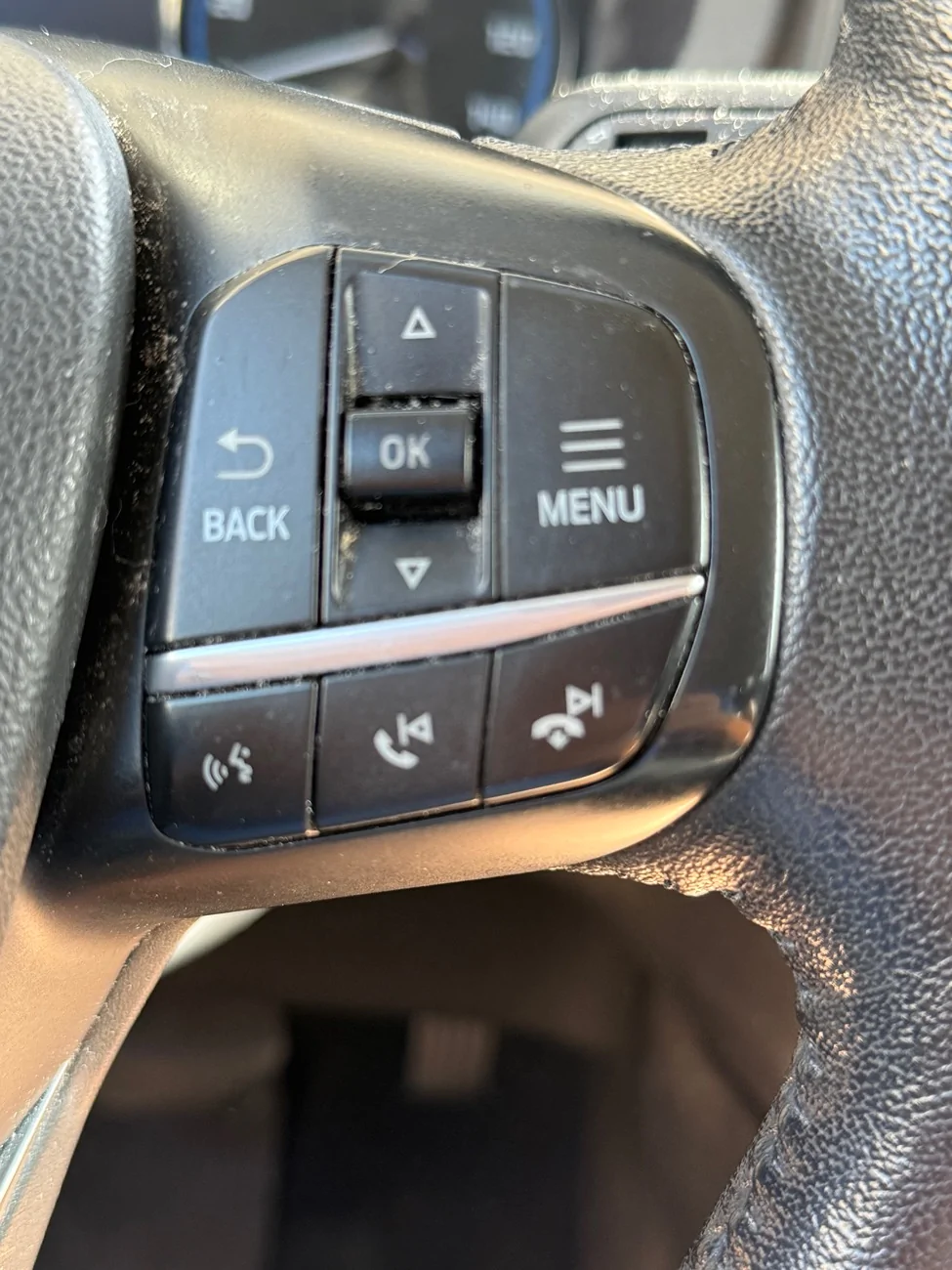

But before doing that, it would be helpful if you could post a short video of the instrument cluster including showing the right side steering wheel controls as you navigate through the menus. I think you are navigating down through the screens but at least one requires the push of the up arrow.
It would be most helpful if your video shows what you try which will then be obvious to everyone what buttons are being pushed and what the instrument cluster is showing.
Have you tried with the engine ON?

Did you ever get this resolved?
@thomasm23 I did! I had to use forSCAN to enable it. The oil minder options were disabled, as soon as I toggle those settings on and recycle the ignition the Oil Life screen showed up!
Not sure why the options came as disabled from factory.
