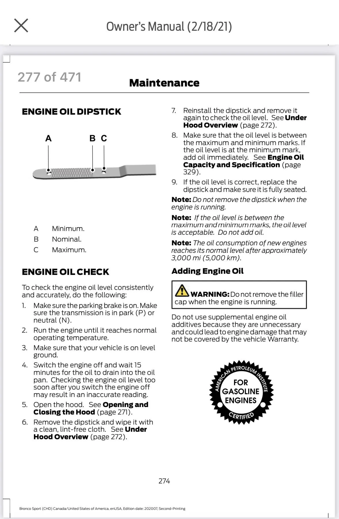

This is what the owners manual says.
Maintenance - Engine Oil Check
ENGINE OIL CHECK
Make sure that your vehicle is on level ground.
Check the oil level before starting the engine, or switch the engine off after warm up and wait 15 minutes for the oil to drain into the oil pan.
Note: Checking the oil level too soon could result in an inaccurate reading.
Remove the dipstick and wipe it with a clean, lint-free cloth.
Reinstall the dipstick and make sure it is fully seated.
Remove the dipstick again to check the oil level.
Note: If the oil level is between the maximum and minimum marks, the oil level is acceptable.Do not add oil.
If the oil level is at the minimum mark, immediately add oil.
Reinstall the dipstick. Make sure it is fully seated.
Note: The oil consumption of new engines reaches its normal level after approximately 3000 mi (5,000 km).
Note: Increases in oil level can occur from frequent short trips that do not allow the engine to get to operating temperature, as well as frequent idling or low speed driving for long periods of time.
Note: If oil levels are continuously noted above the maximum mark, schedule a visit to your authorized dealer.

This is from the 2021 Bronco Sport owners manual.

What is the "nominal" mark for on the dipstick?
Is it the full level when cold?

The Op's BS is a 2022 model, the excerpt I posted is from the 2022 owners manual from Ford.com
Using either oil check method, the oil level should not be above the full mark on the dipstick.

Generally speaking, in engineering speak "nominal" is a synonym for "satisfactory," "normal," and "A-OK." Given that the next mark up is labeled "Maximum," I suspect what the tech writer MEANT to say there was that the top of the hatched area is the normal full mark.

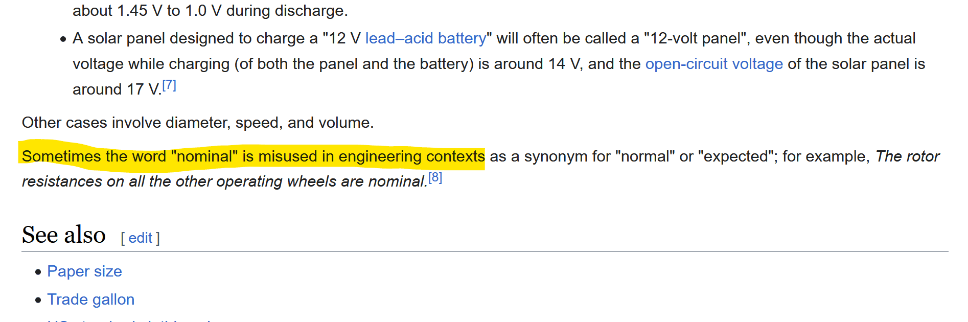

Pipe (or lumber) is a good example. Coincidentally, I was just looking at a pipe dimensions chart:
https://www.howellpipe.com/wp-content/uploads/2018/07/Howell-Copper-Pipe-Tube-Dimensions.pdf
As you know, the O.D. of pipe is fixed. 1/2" pipe is 0.625" O.D., regardless of wall thickness. The "1/2" nominal size refers to the I.D., which varies from .569 to .527". Nominal is the correct term.
Back to the "nominal" mark on the dipstick -- I understand how the word 'nominal' is typically used (pipe, or a "2x4" being closer to 1.5x3.5" for example) -- but that does not seem to apply here, not exactly.
I'm trying to think of why Ford (and other mfrs) would deviate from ye olde dipstick with "low" and "full" markings only. The oil level is either full or it's not. All I can figure is that Ford either a) is accounting for expansion due to temp extremes, or b) they're saying (essentially) "Full" is anywhere between nominal and maximum. When the oil is changed or topped off, the level should be at least "nominal" but no more than "maximum"?

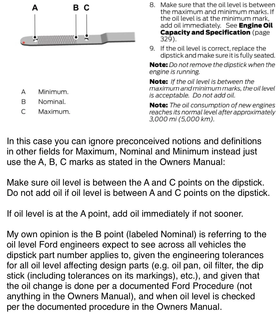

I'm still curious about the "nominal" mark on the dipstick. I've done several searches and cannot find anything.
How about this … you haven’t found a single agreed to definition for “nominal” point on the dipstick because….
Ford Bronco Sport Oil Level Increasing IMG_5462
Btw .. I used the pic posted earlier from a 2021 Owners Manual but ‘22 and ‘23 owners (actually all owners) would use the Owners Manual applicable to their vehicle.
