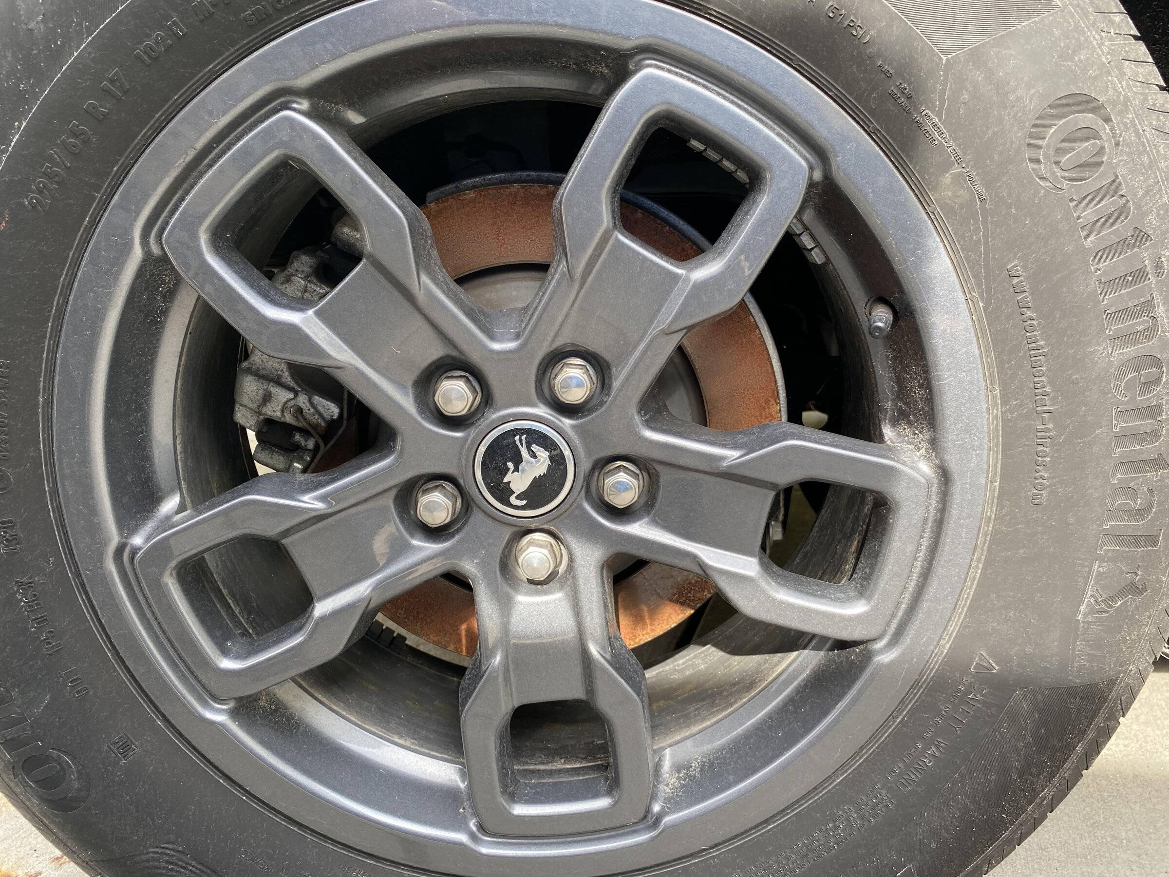

I get this sound too, and I have attached a picture of why. Some background: Took delivery of my Big Bend addition in February of 2021. I currently have 37,000 miles on the vehicle. I drive a lot, especially for work, and have also taken the Bronco Sport on various trips around the upper mid-west. Vehicle has been great overall, only real issue up to now is I had a shock that was leaking fluid, dealer replaced the shock no charge. Have the 1.5 3 cylinder engine, change oil regularly, never have had to add any oil between changes.
On to the story of rotor rust. I live in the southeastern Wisconsin, between Milwaukee and Madison. This past Saturday morning, took a drive south to the Illinois border, roughly a 120 mile round trip. There was a mix of snow and rain the whole trip, sort of messy. Got home, parked the Bronco on my driveway about 4pm. Car sat outside overnight, maybe rained a bit, but not much. Did not look at the Bronco Sunday until about 3pm, and saw what you see on the pic below. That pic is the right rear wheel. The left rear wheel was just as bad. The two front rotors were not as bad, but had some rust on them. I have had the grinding-sound issue, has always related to wet weather. When I packed out of the driveway Sunday night, the grinding noise was pretty loud. Took a little bit of driving to wear the the rust off, and when I got home, the rotors were nice and clean. I can't believe though that this is good for the brake pads and the braking system in general. I obviously am going to talk to the dealer about it. We have had some wet weather again this week, and I see rust again on the rotors, not anywhere near this level.
Anyway, pretty sure that is where your grinding sound is coming from.
