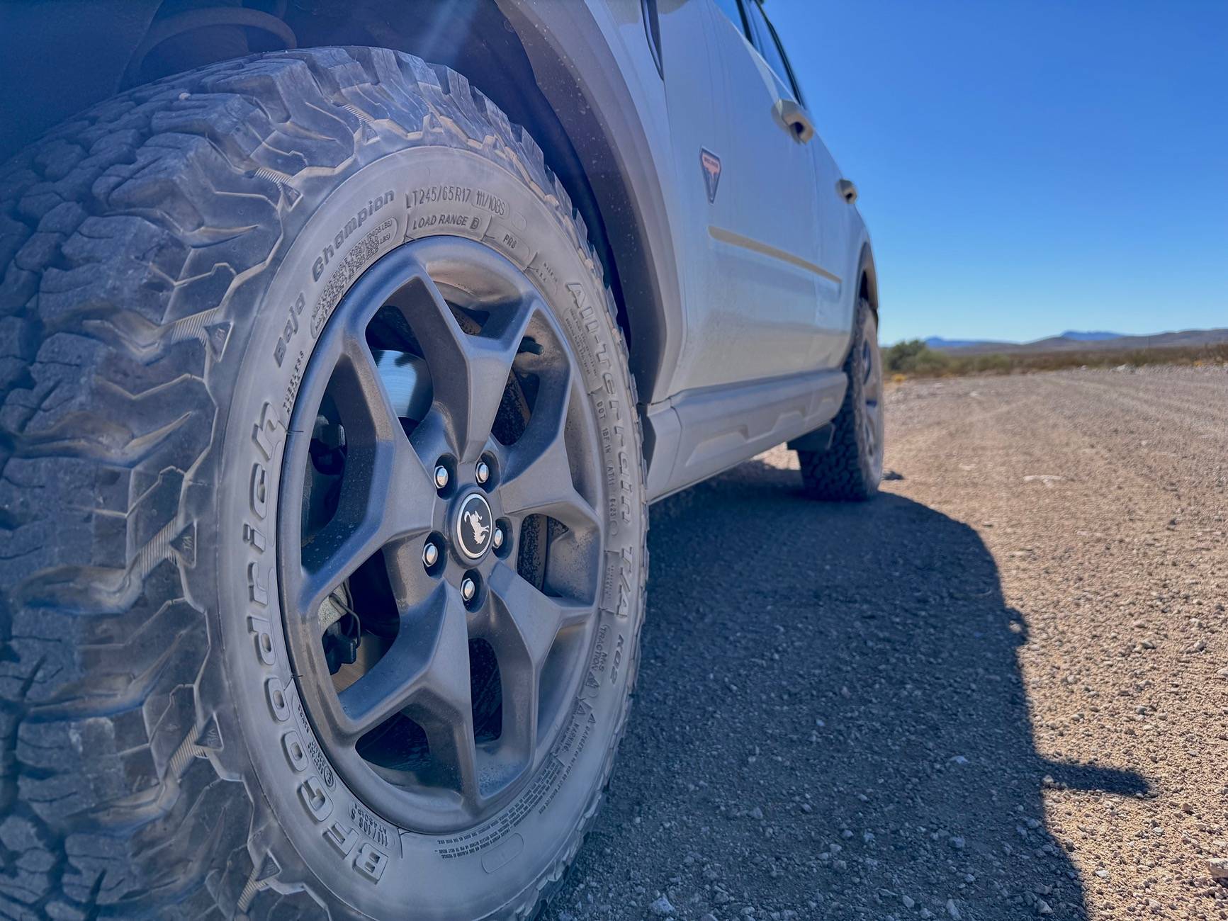

With my sport having the white letters on green I liked the white on black on the tires, kinda looks like a matchbox car, I'd like a very minor lift, like 1 to 1.5 inch

I had my BSOB offroad last week for the first time. It did reasonably well but nothing like my IH Scout II. The baby bronco has the factory Michelin all season tires. Will the 245's fit without a lift?
On Bronco Sports with 17” rims, 245/65 fit with no modifications needed. (Some have claimed to go bigger) However with an OB I would assume you have the 18” rims which will change what you can fit without modifications. I think the 30 in tires is about all that can be squeezed into those wheel wells.
Also fyi since the Bronco Sport is a unibody vehicle, a lift doesn’t really change what you can fit. The limiting factor seems to be a pinch weld that the tires rub when they get too large.
