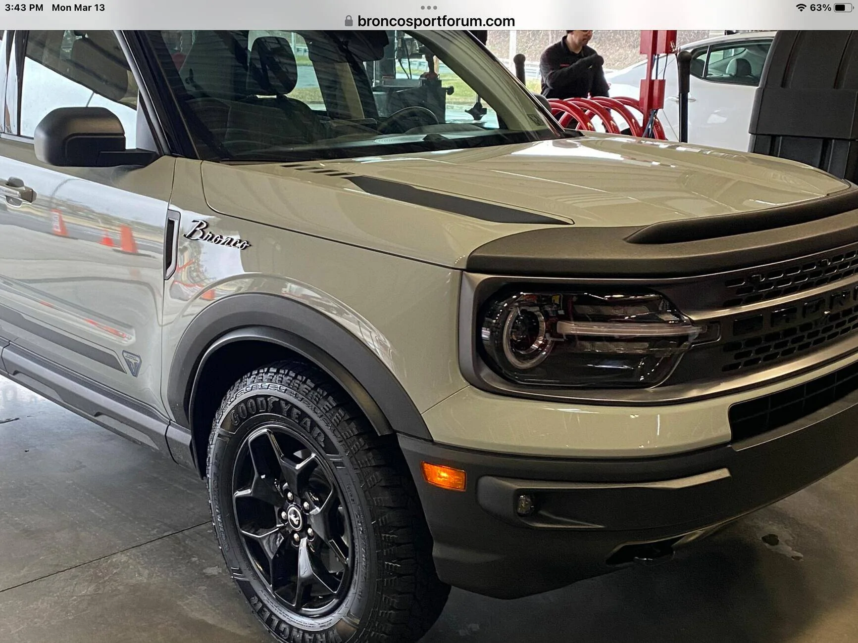

I have 235/70/17 Goodyear wrangler workhorse on my 2021 First Edition badland for 2 years now , no issues and no lift. The key here is to stay with the 235 . Any lift will not increase the wheel width. My tires are a true 30.2 inch diameter. That is the maximum tire size.
