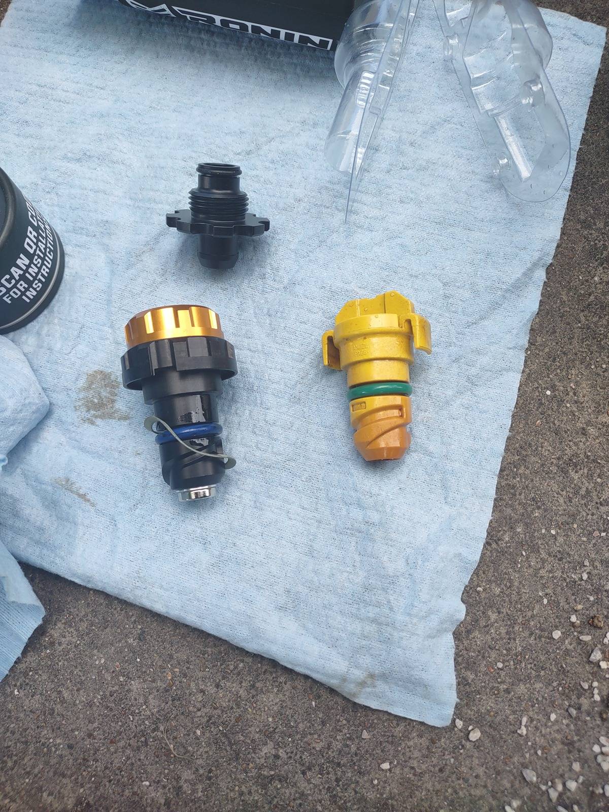

I changed my oil to and installed my Ronin oil plug after I removed the original yellow plastic oil plug and got a serious mess. Yes Ronin is a godsend in my eyes because now I don't have to worry about the big mess I used to always get. I love my Bronco Sport and this will be one more reason to love it. No more of what you see in the pictures! Hell yes it is a godsend for a hands on guy like me!

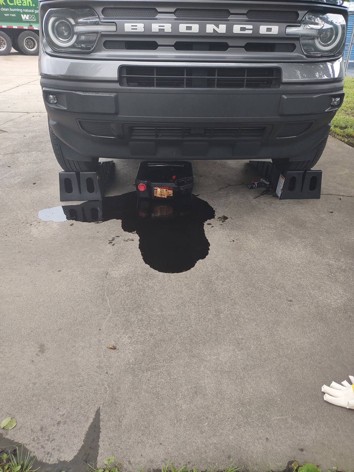

How did the spill happen?

It's called the Ronin oil drain plug. It's an upgrade for Ford vehicles with the yellow plastic drain plug. If you change your own oil this will be a godsend. It's kind of expensive at $60 but it was a no brainer for me.

The oil drain pan could not keep up with the amount of oil that came out when I removed the yellow @#$_& drain plug. I've changed my own oil since I got my Bronco Sport and messes like this was the norm.

The 2.0L is the same way. It has the typical steel drain plug, and when it is removed, the oil shoots out a pretty good distance toward the front. It's always a bit of a guessing game determining when you're at the last thread before the plug comes loose.
Then, as the flow of oil slows, the arc gets smaller (closer to draining straight down) and it ends up going backwards a bit -- so I slide the pan back as it drains.
Then of course more oil comes out when the oil filter is removed...

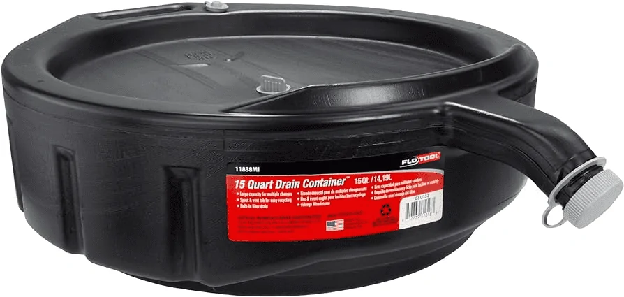

I've been using a drain pan similar to yours, but it is round and holds 15 quarts -- like this:
Ford Bronco Sport New oil drain plug is available -- Ronin oil drain plug 1715918789511-72
It's pretty large diameter (compared to a typical drain pan) which makes placement not so critical. So far, I've been able to avoid any spills.

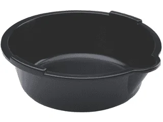

have been using rectangular dishwashing tub (dedicated for garage use)
set up length wise to collect waste oil
no need to compensate for flow decrease
funnel waste oil back into emptied oil container(s)
clean plastic tub and funnel for next use
This, and a large piece of cardboard under it. The pan catches the flood; the cardboard catches the splashes.

diminishing flow arc is the key
return used oil to redemption center
psychological or real
engines always feel better with the "new oil feel"
B-b-b-but -- if you clean the tub thoroughly after each oil change it can pull double duty in the kitchen. :cool:
I like your method.
