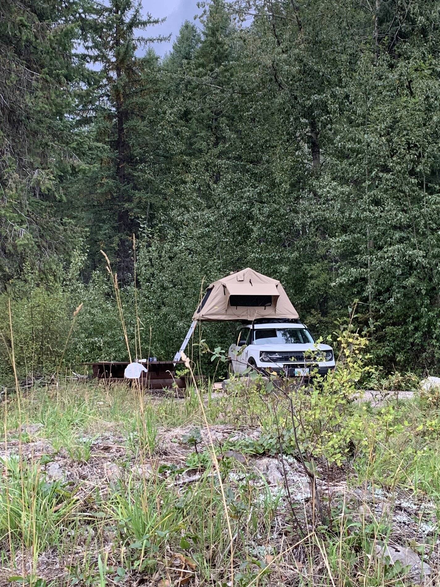

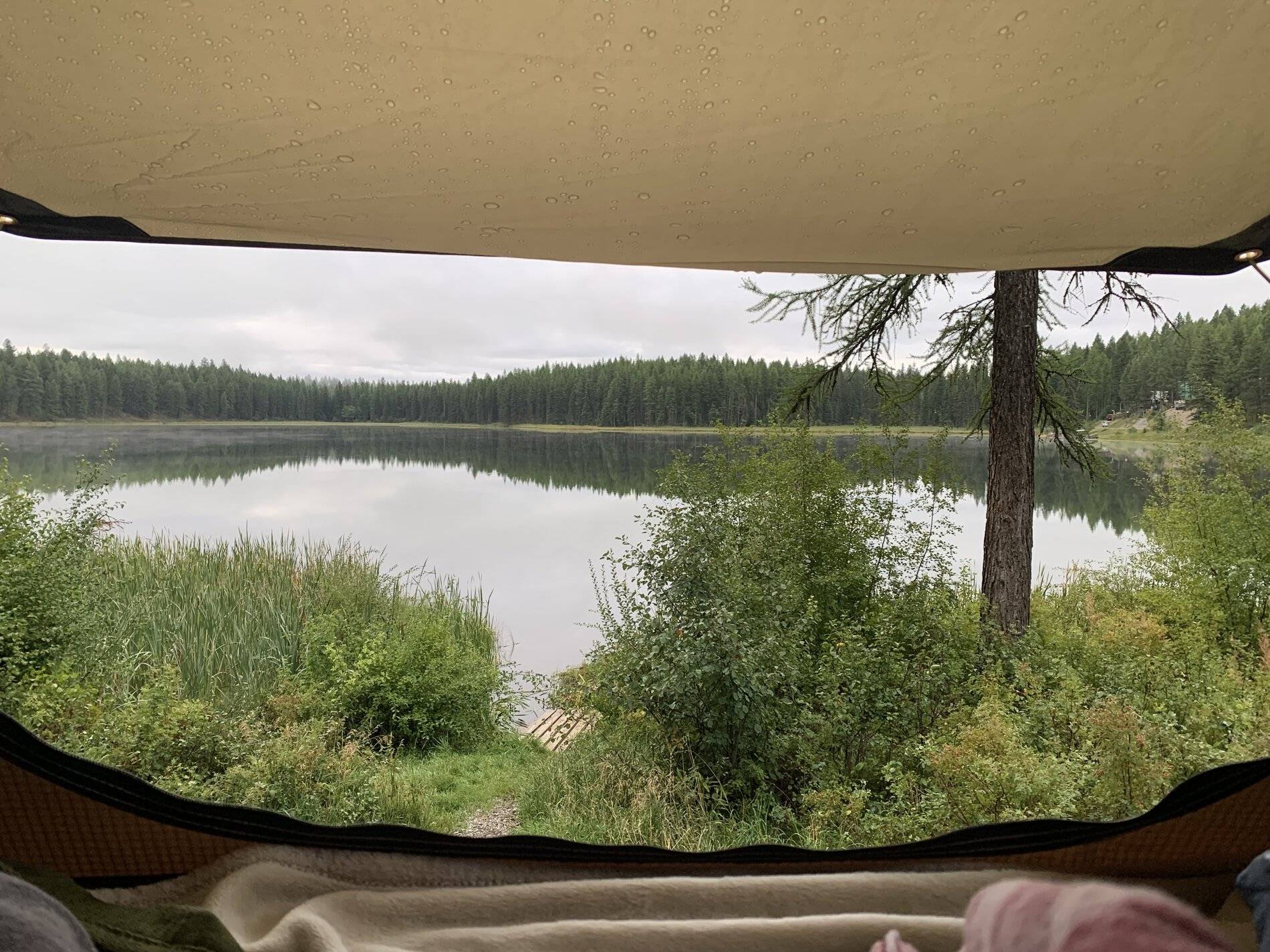

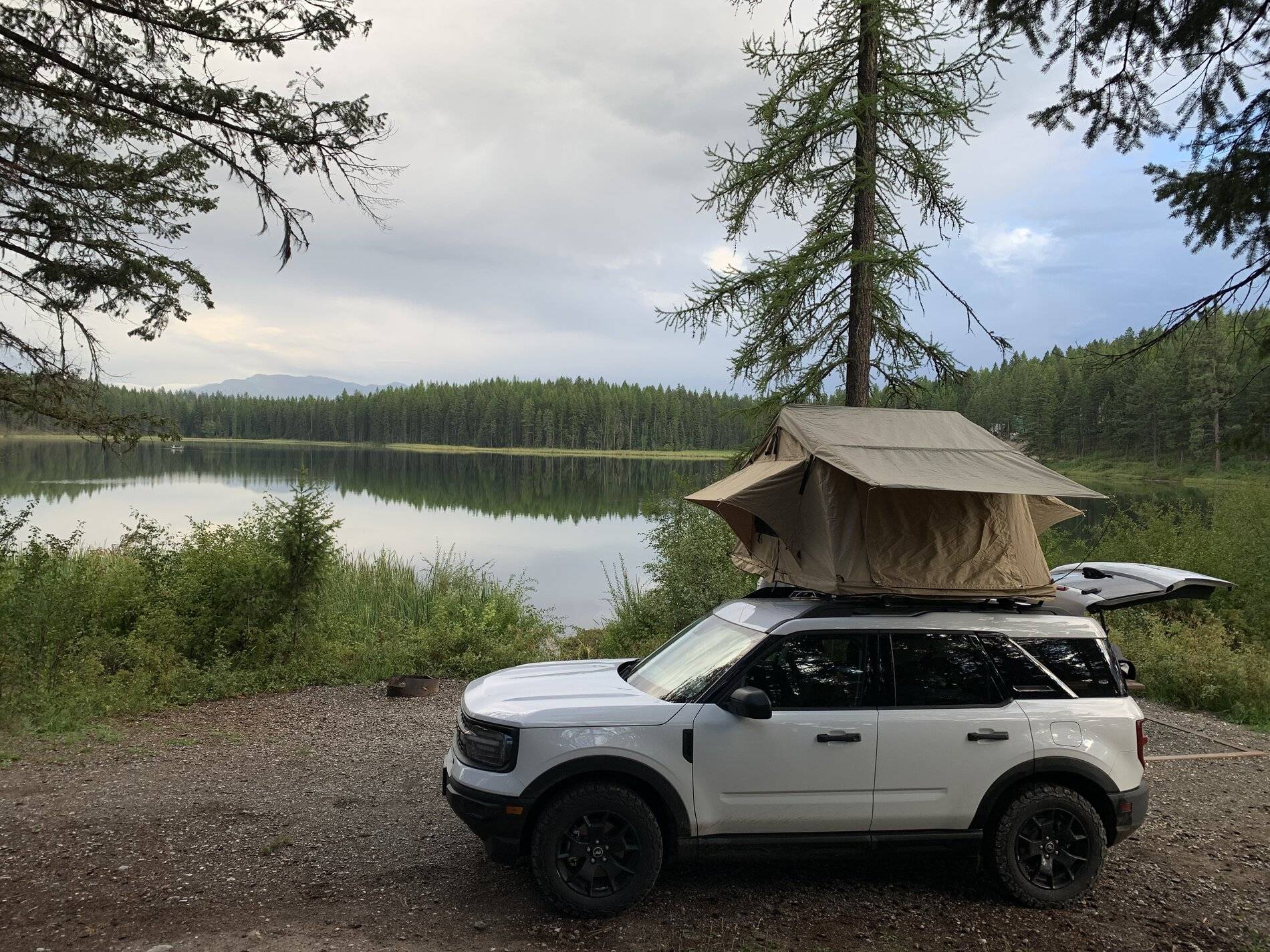

just got home from living in our roof top tent for 8 nights. probably the best sleeps i've had in some time.
we have a Smittybuilt roof top tent, and Thule whisper evo crossbars. on top of a 21 bronco sport base.
we are both 6’1 tall and 175ish lbs each. lots of room!

Sounds like an awesome trip. What does your tent weigh? How was performance of the 1.5L with the tent and gear and people? Thanks.

I put mine centered and toward the back. But I got the 60in bars so when I get my "narrow basket" and shower I can put the tent to one side and still have room for everything else. This picture is on a pickup but you get the idea. I would center yours unless you are adding things to the top. Also have the ladder drop on the passenger side or driver side. If you have it come off the trunk you can only open the glass hatch from the back.

I have a bronco sport and I'm looking into getting a RTT (probably the one from Rough Country) but to be honest I would like the tent to open towards the back not to the sides, I have that taller crossbar so my tent would be sitting maybe 1 or 2in higher than yours. Would I be able to open the trunk? Even if it doesn't open all the way up, just about 80%, that would be ok. But would I have enough clearance for the ladder with the trunk open? Would it work? Thanks
in the instruction manual on ours, you can mount it side facing (like ours) or rear facing. with the bronco sport, i don't think it would work rear facing due to the height of the gate when opened. you would probably have to strap the gate at a lower height for it to work.

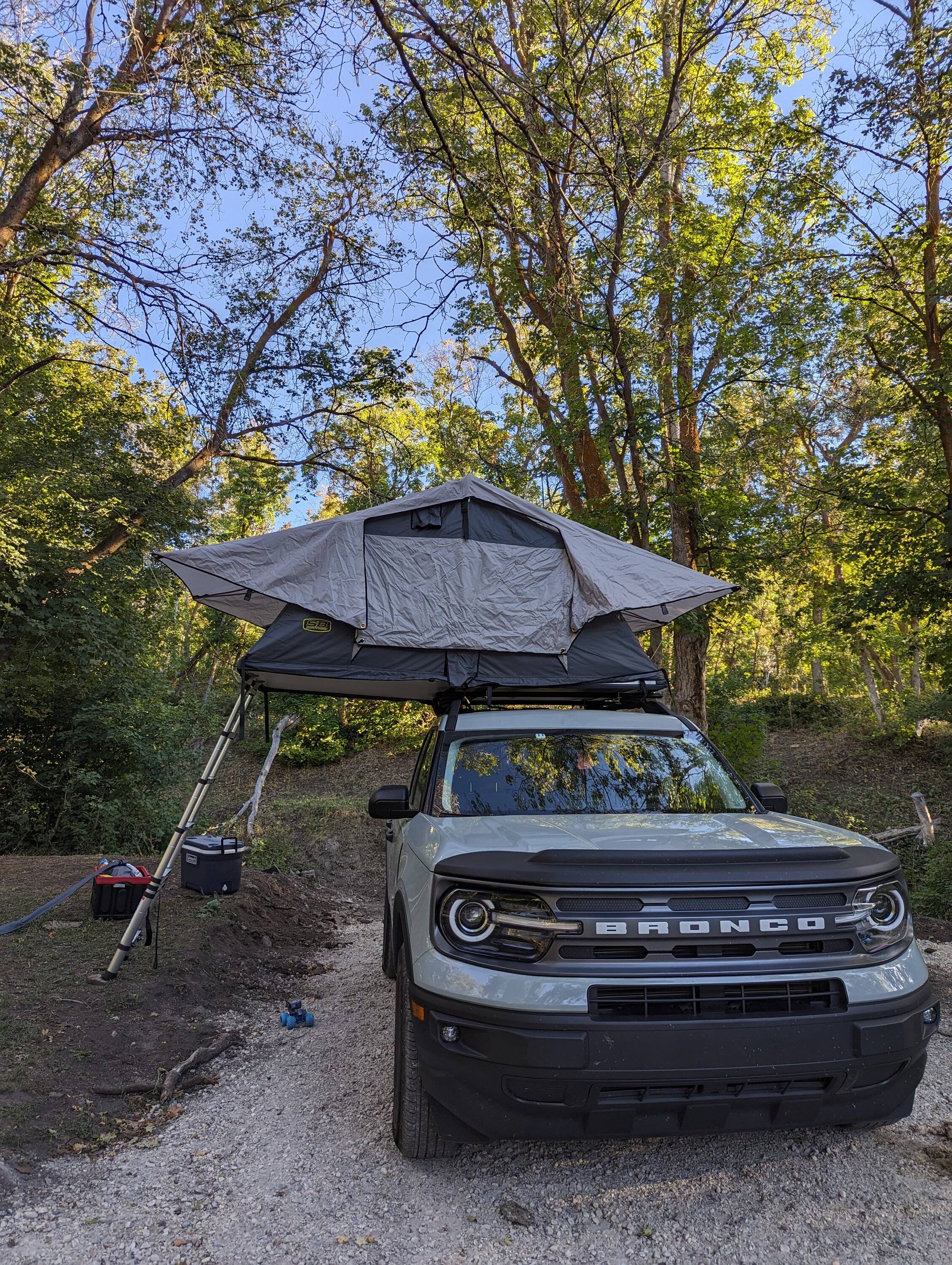

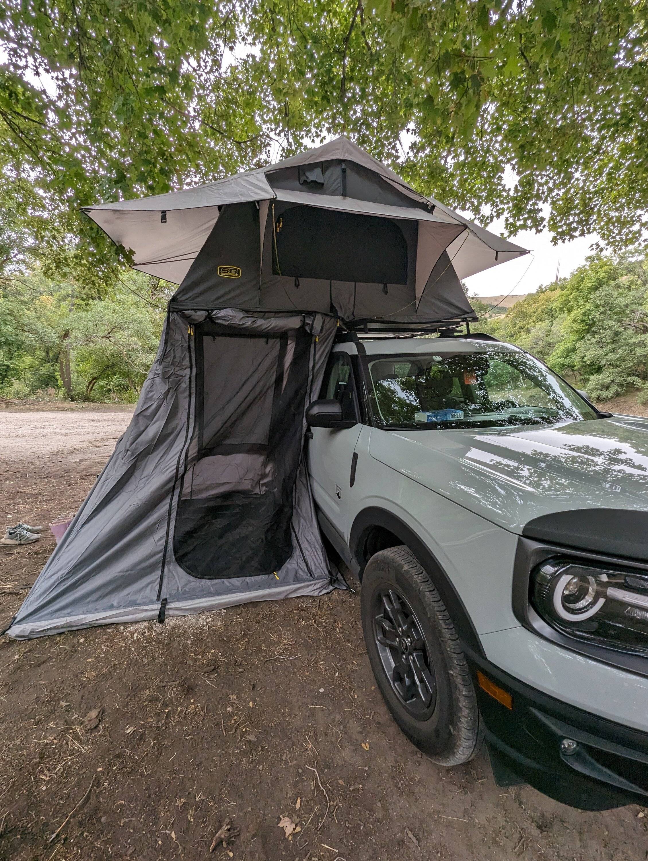

I know pictures of other setups always helps me, so here's my addition. Hope it helps anyone thinking about a RTT setup.
Smittybilt RTT Gen 2
Smittybilt Annex
Thule whisper Evo crossbar (liked how short they were compared to the "Ford" ones and the Yakima ones.
'23 BS BB
Ford Bronco Sport Mounting The Rooftop Tent Q's 1000012627
Ford Bronco Sport Mounting The Rooftop Tent Q's 1000012659
