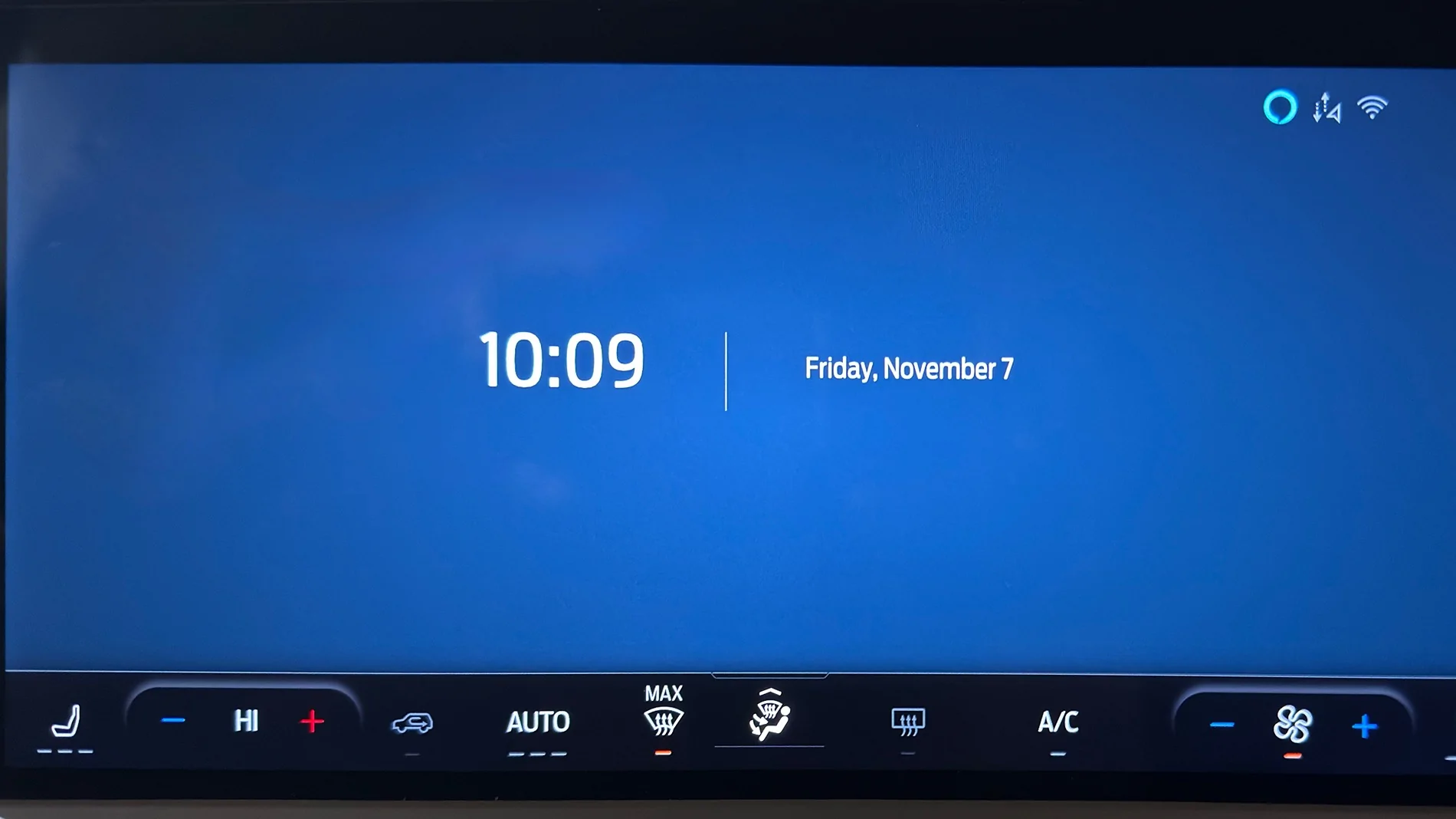

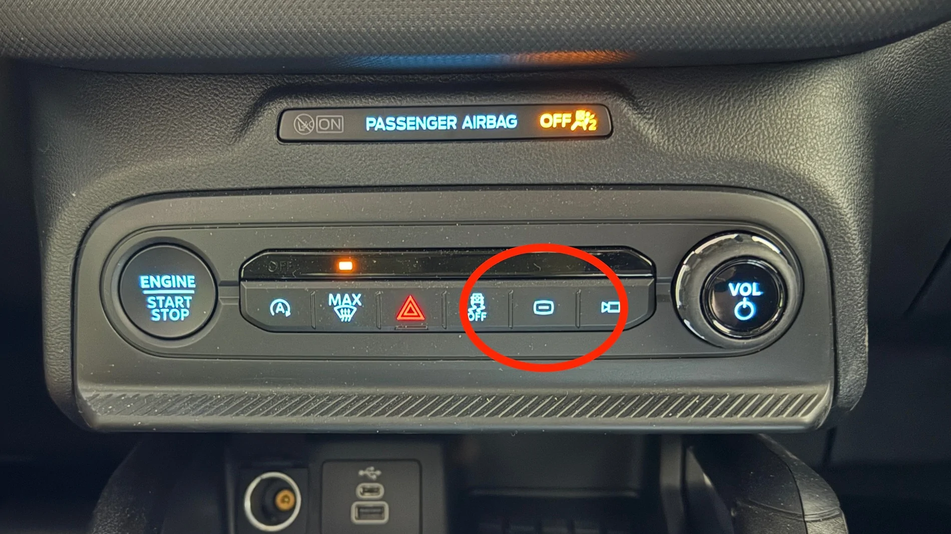

I rarely use CarPlay, the only benefit for me is OnX or Google Maps when I'm out of the Valley. I could just mount my iPad Mini for the same functionality, so at the end of the day it's really not something I couldn't live without altogether. I don't listen to the radio or stream music, don't make or take calls/texts while driving, and couldn't tell you a tenth of the apps or widgets there are. Honestly, I'd just as soon turn the whole screen off if it weren't for the climate control.
There's a button for that:
Ford Bronco Sport Motorola MA1 Wireless Car Adapter for Android Auto IMG_4296
Ford Bronco Sport Motorola MA1 Wireless Car Adapter for Android Auto IMG_4297

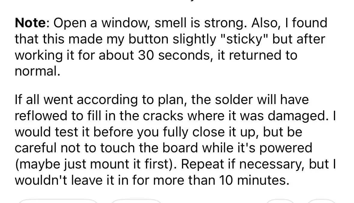

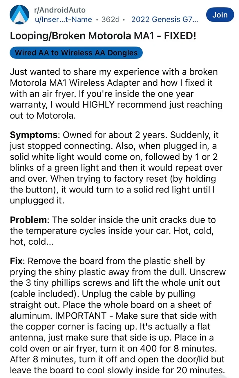

I bought one soon after I got my BS. It lasted a little less than a year and then stopped working. Found out you can repair it by baking in the oven, now it is working again. Works great when it isn't broken. Used velcro and mounted it to top/roof of the cubby hole.

Wow, in my experience, tech stops working when it gets too hot. Learned something new. :D
