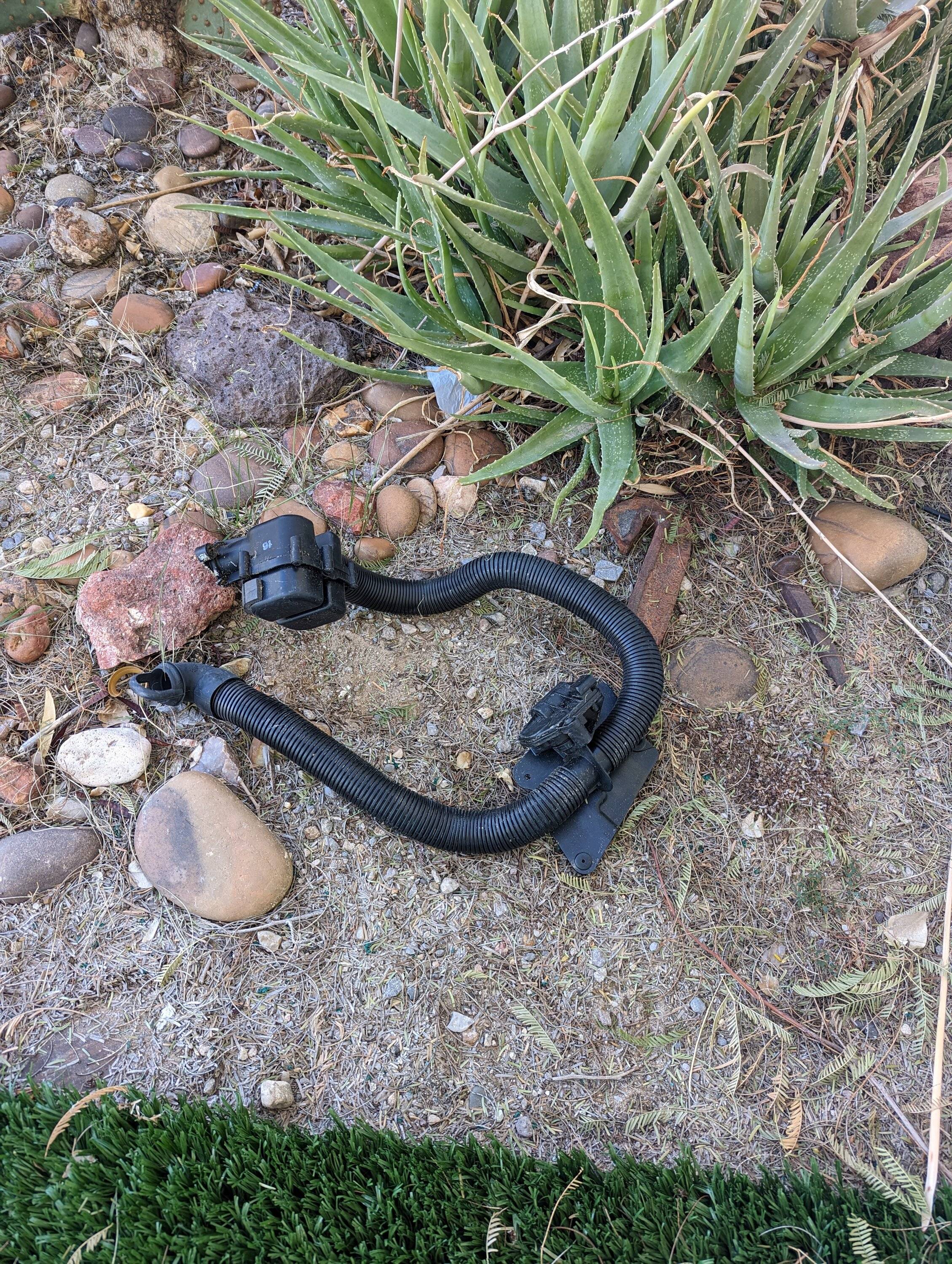

Yup, the “Soudactor” was something I removed from my Golf R. It also had a flapper in the exhaust that would open generally above a certain rpm. It was actuated by vacuum.

I have one sitting next to garage still. First thing you take off. Replace with block off plate with a vac port to run true vac to the bov. Took up a lot of space and sounded terrible. Don't think there is one on BB.
