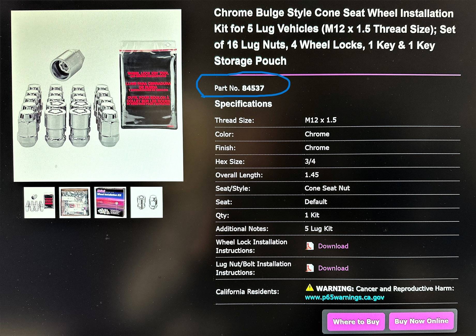

If you want a locking nut on each wheel here's the kit I bought. Excellent quality.
Ford Bronco Sport Mcguard wheel lock warning MCGARD LUG NUT LOCK KIT 84537

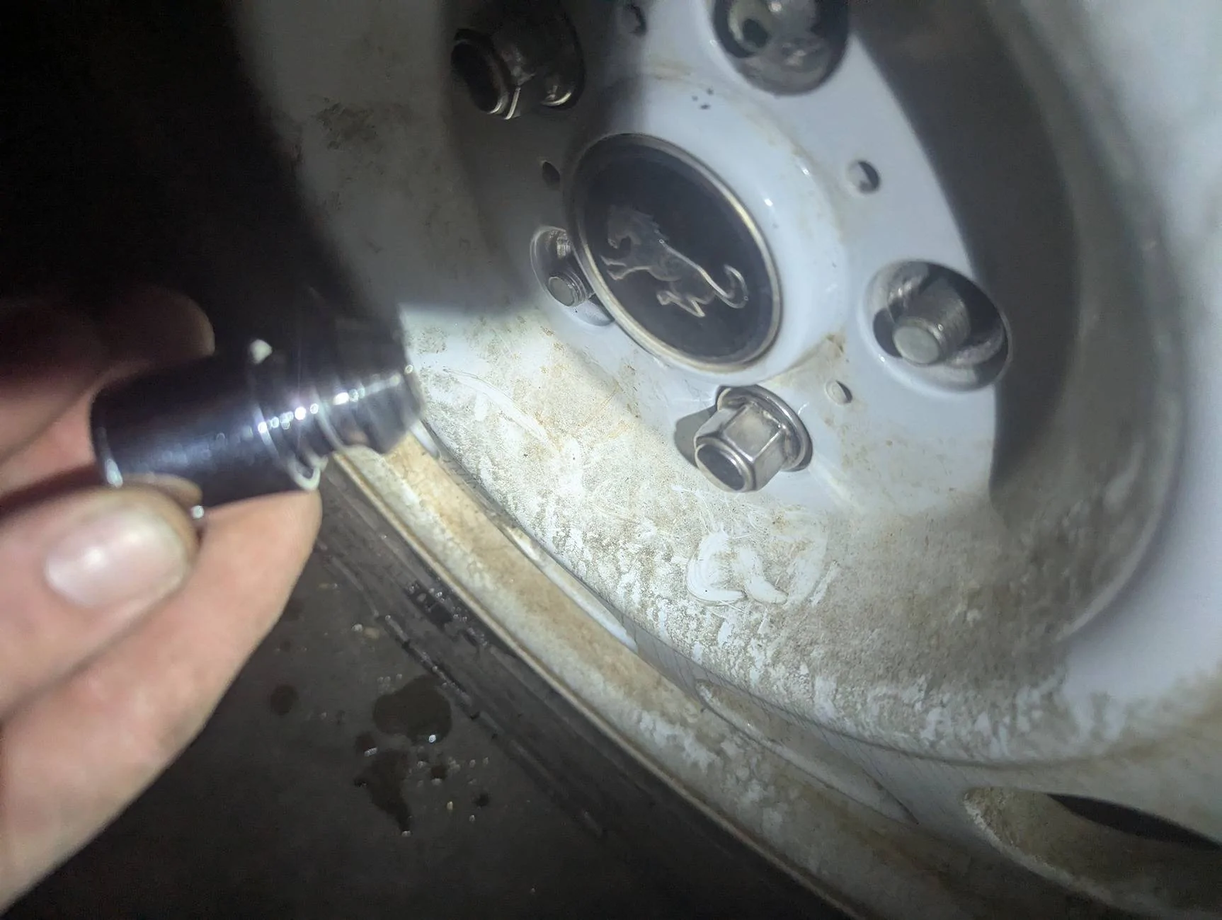

I finally got the stupid blank blank word that I'm not going to say on here. I sacrificed every 12.3/4 socket that I had from all my leftover tool sets and I finally found a really good one from actually a really cheap Walmart brand companion. I don't know if it's because it's cheap and it's self-metal that it just bent better to the socket or what but the stupid thing finally came off. Also, one thing I realized with only having that nut on there, the tire was actually putting pressure on the lug nut as well. So I put two other lug nuts on screw them on so they were helping carry the weight to take some weight off that one lug nut and I put it up in the air but I put a little actually use an old brass pulley to lock the wheel in place so it didn't spin the transmission. And with that and my breaker bar and not even trying that hard it got it off. It's not super Rusty inside. There's a little bit a little bit of dirt, maybe just like the others. It's pretty scuffed up on the 60° cone, but I don't see any particular reason why this was so hard to get off. Except I think what happened was I left every other lug nut off so the wheel was putting a lot of side pressure on the lug nut and that was adding to the problems and I didn't have that when I did the others with the others. I had all the other lug nuts on as well. So that might be something to remember if you ever have to deal with this. And I might have gotten it off sooner and saved myself $55 in stupid tools.
Ford Bronco Sport Mcguard wheel lock warning PXL_20250224_020922122

So I decided to just go over to the local AutoZone and pick up their brand which is White Knight. I grabbed the ones that have splines on them. I guess they're supposed to be kind of a locking key, but since you can buy the key anywhere it's not really. I just like the idea that it would have better contactless chance of stripping and you can buy the key anywhere if you lose it. Also, the key offered two different sizes that you can use to turn it would seem cool and I really just want to swap all those lug nuts out cuz some of them were starting to get rust in them and some of them were kind of scored on the conical end and just want to get everything back to how it should be
