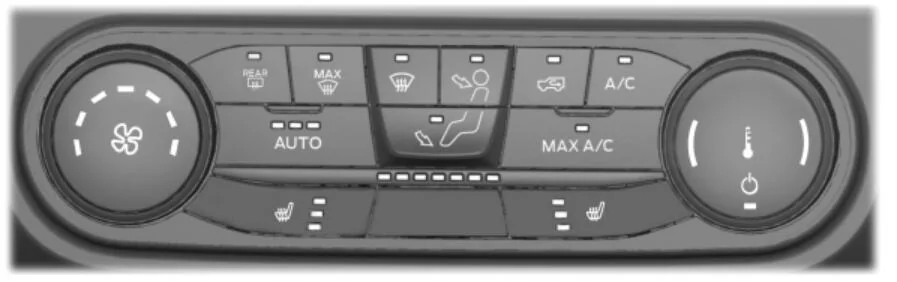

Don't know why the pic doesn't load; it's from this site! I copied a photo from the owner's manual instead.
I see the pic.
I live in muggy Florida. Our A/C blows out frosty cold air when the MAX button is pressed. It will cool the interior in less than a minute.
