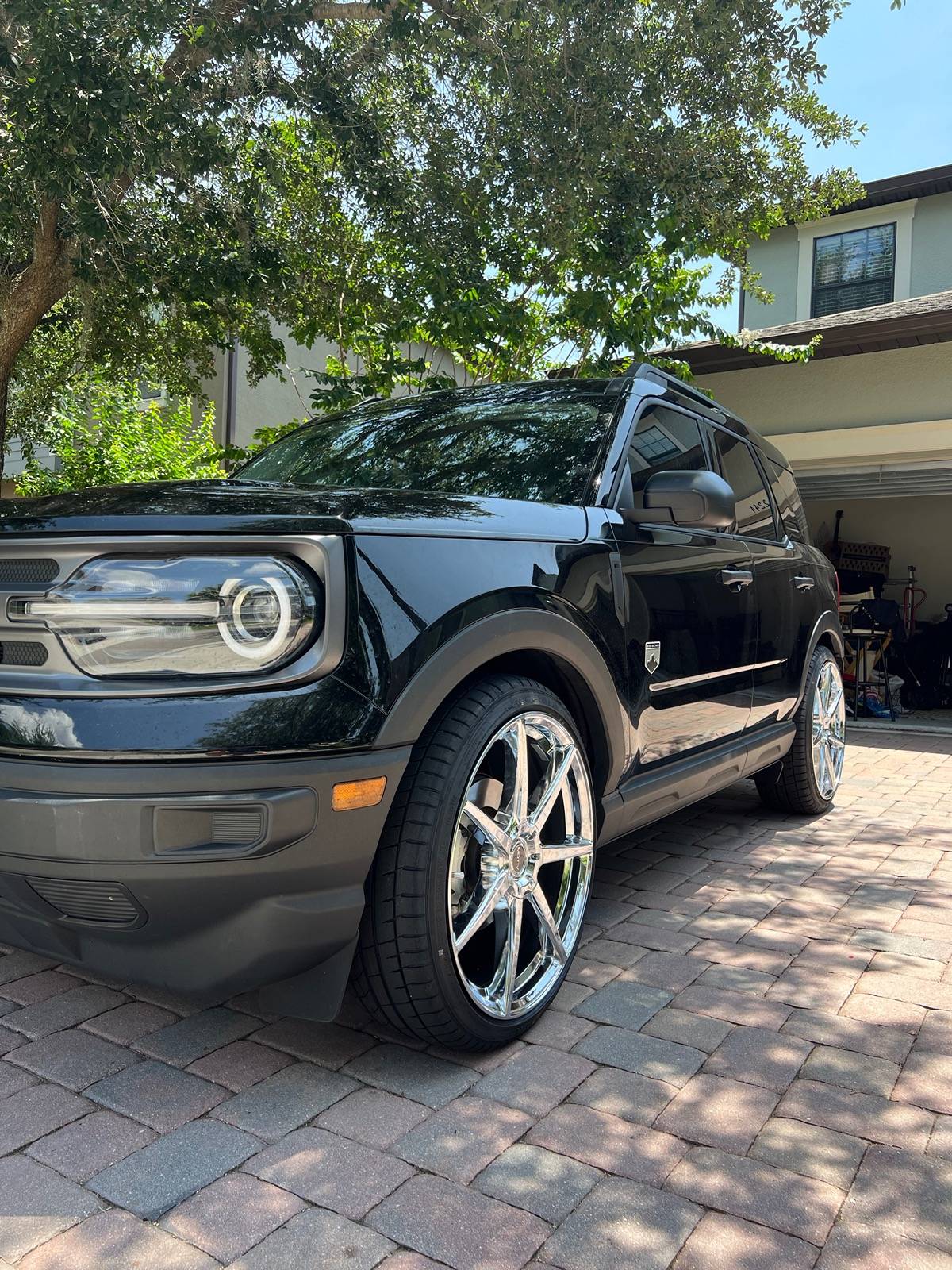

Ok guys I did it. I lowered my 2023 Bronco Sport at 2” with the ford escape AWD lowering springs from Steeda. I also put 22” wheels with 255/35r22 tires. No rubbing. This is what it’s looks like. +40 mm Motive 22” wheels
Ford Bronco Sport Lowering springs for Bronco Sport? IMG_6286
Ford Bronco Sport Lowering springs for Bronco Sport? IMG_6285
Pretty cool man. I don't knock the lowered look, if you're pretty much only driving on the streets. I like to lower my sports cars when I've had them, including most recently my Mustang.
Can you provide a pure side profile pic?
You did good! Do you have any side views of the BS? I prefer my vehicles lower than stock and have been eyeing a BS for quite awhile . What part number springs/ shocks did you use?
