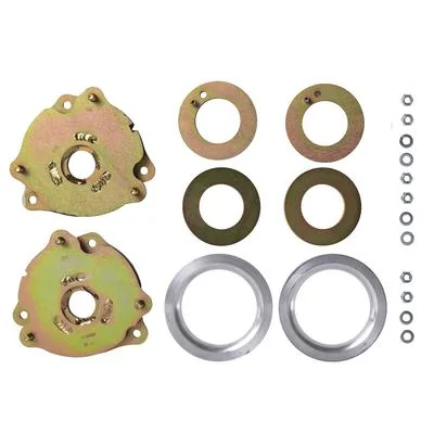

I was planning on getting a Rough Country 1.5" lift on my 2023 BadLands, but I just found out that RC doesn't make one for the Badlands. :( Has anyone done a lift for that trim? I do want to put on some Mickey Thompson 245/65 R17's, but was planning on lifting first. Now I'm at a stand-still.
4 Wheel Parts has a lift that works on the Badlands, it's also fairly inexpensive.
<https://www.4wheelparts.com/p/4-wheel-parts-factory-leveling-spacer-kit-62207k/_/R-4WPBR-62207K>
If you're mecanically inclined and install it yourself, you could almost buy a set of tires.

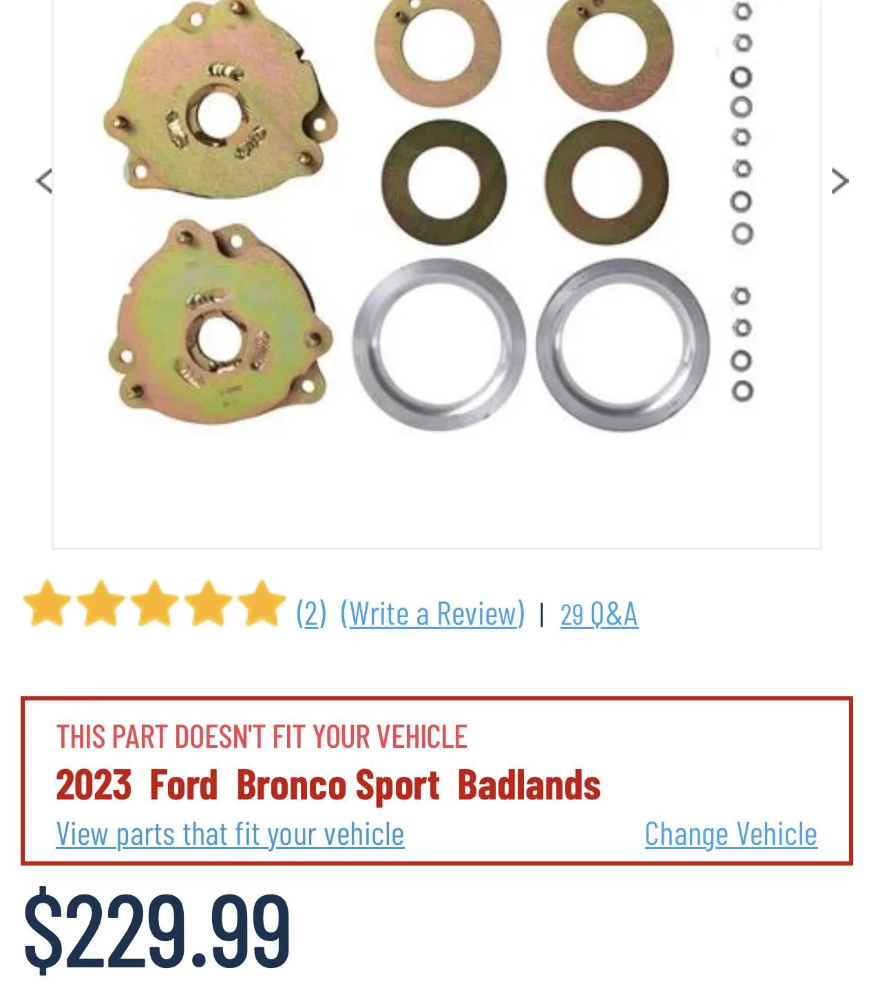

Actually it shows that it doesn’t fit mine. And those are half the cost of what HRG costs.
Ford Bronco Sport Lift Kit New Wheels and Tires 1672444258124
Interesting.
I don't believe Ford changed the Badlands suspension for the 2023 model year.
Most likely 4WP hasn't updated the fitment list.

If you get that kit (or anyone else) make sure that there is a recess in the strut spacer. Early lift kits did not have that recess. If the spacer sits up on center portion of the ”strut hat”, it will eventually have creaking noises.

I called 4WP this morning and they confirmed that it will not work on the 2023 Badlands for whatever reason. I see online that it will work for the 2022 Badlands though. He said that even Readylift won't work for the 23 BL.
I wonder what is different about the 23 that makes the kit not work?

No idea. Even my salesman at the dealership said that he's not aware of any change and "on some 23 models, I've looked for a part for it, and the system says no, but a 2022 part number will work." I'm wondering if I should just order the part and see if my Ford installer can look at it and see if it will work with the parts in hand.

If the 4WP person looked at the same info in their catalog or web page, they will say it doesn't fit.
I still believe the 4WP documentation hasn't caught up.
Its half the price because I see only half the parts.
