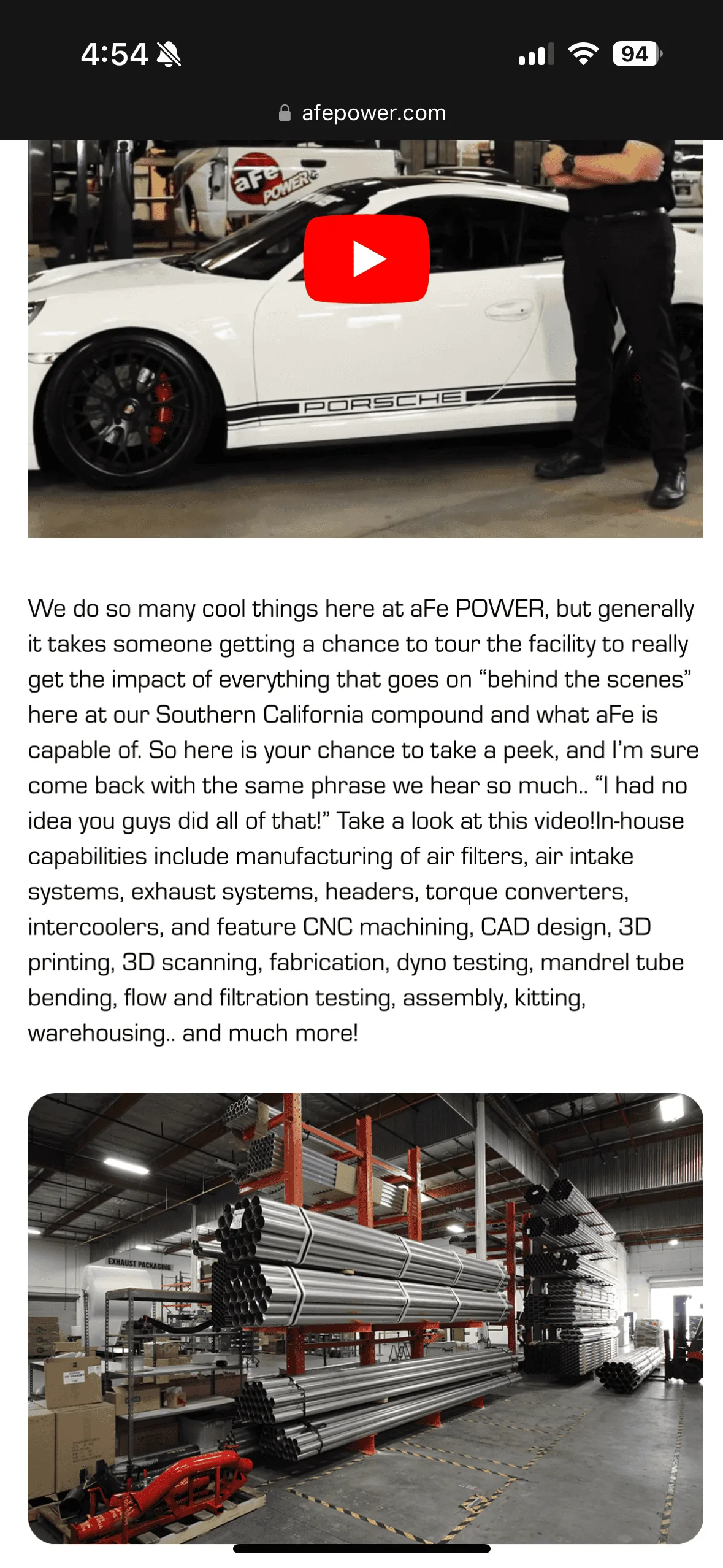

That's the manufacturer of the dynamometer. Who conducted the test? Please share a link.
Ford Bronco Sport K&N Cold Air Induction Kit for the 1.5 IMG_3525
sorry your right, AFE POWER does the TESTING. All the credentials date and time and products used are in previous picture :clap:
6,733
13,156
Thanks. I take product tests conducted by the product manufacturer with a grain of salt. If you look carefully at the conditions for the two tests you'll see they were conducted on different days. The powertrain control module measures factors such as air temp/pressure/humidity/etc., and changes control parameters to optimize power output. All of these can change from day-to-day, rendering accurate comparisons problematic. I would give this comparison more credence if both tests had been conducted on the same day, preferably at the same time of day so there isn't much variance in temperature.
