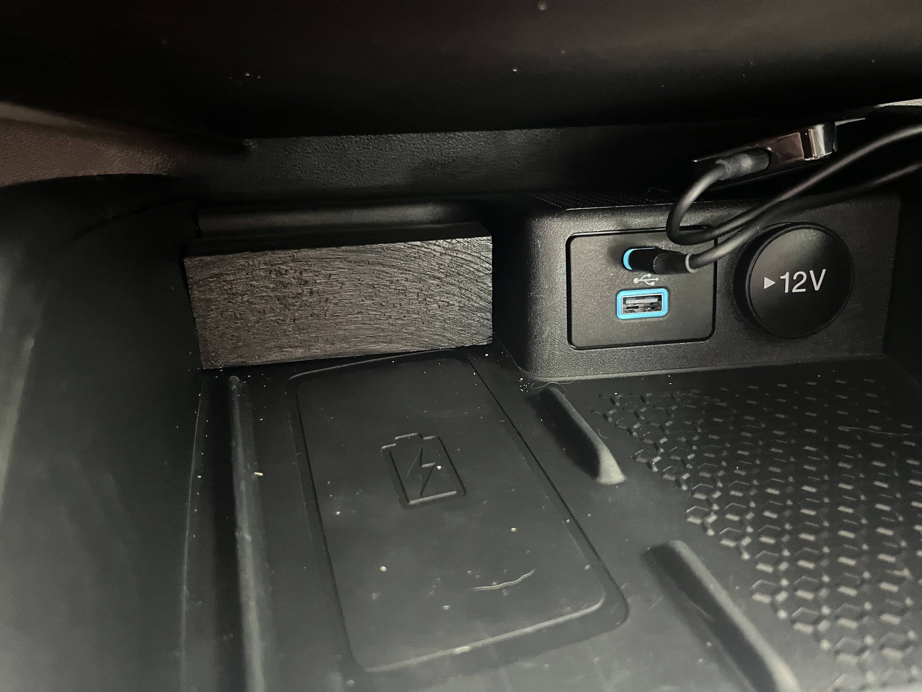

I have an iPhone 13. I cut a block of wood and painted it black and placed at the back of the charger towards the front of the vehicle. Fixed the sliding issue.

Nifty idea, but no good for a Pro Max.

REVOLUTIONARY TECH! ?
