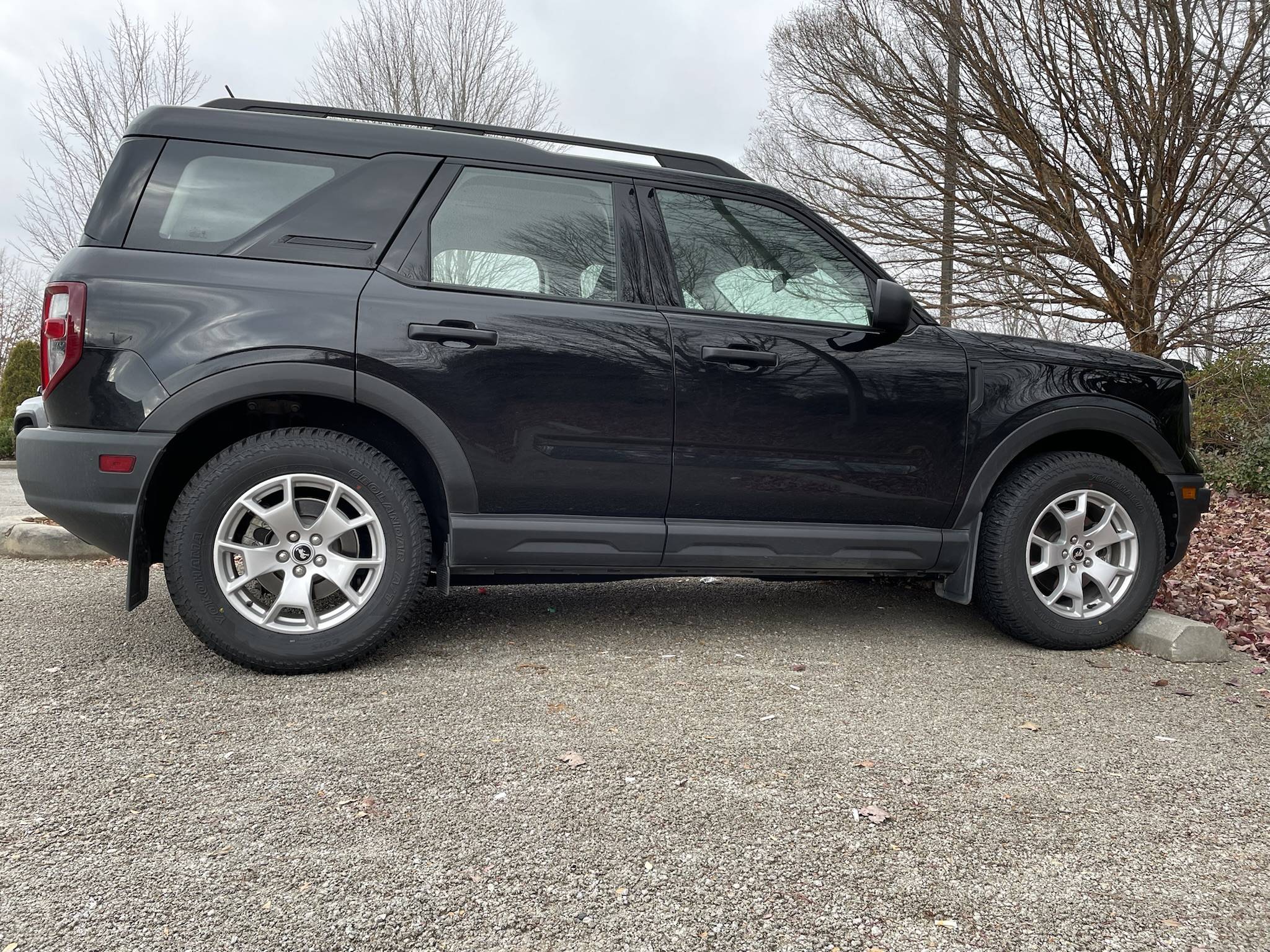

To the OP, false advertising means little to the informed customers.
Even my BASE model is 4WD when it needs to be. It’s kicked in many times for me.
I would estimate that 75-80% of the BS buyers know nothing about manual locking or full time 4WD.
These ‘Escapes on Steroids’ these BS’S are very good 4WD vehicles.
So why worry about what the advertising department tells people.
Your either an In formed consumer or your not. Thing is the not so smart buyers are still getting a great AWD not some lame one wheel drive Subaru.
I think Ford Properly Advertised this very capable 4WD/AWD sport ute…..

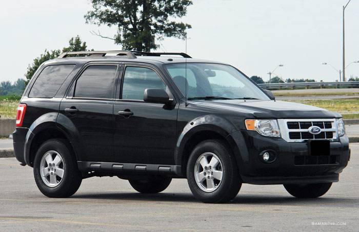

This is why I continue to call the Bronco Sport An ‘Escape on Steroids’ :’P
I’ve got the 2004 Escape with 215,000 miles on the clock and I’d like to find one of these 2010 models. In black of course…
I like old chit, that I can still get parts for.
