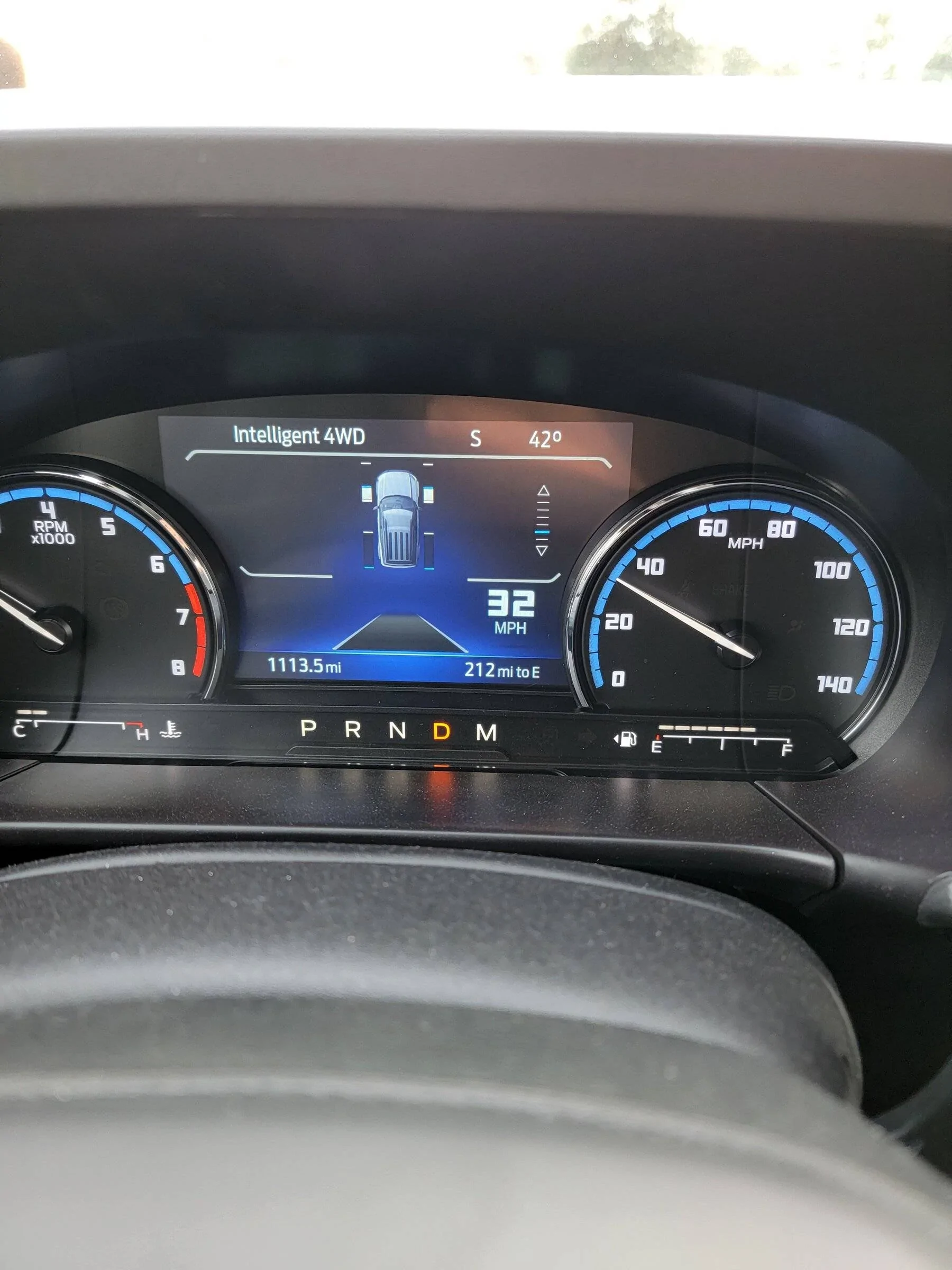

Is this 4WD false advertisement from ford?? Check out the picture..

My Fusion did this, and my Escapes did this. Its Fords Intelligent 4wd. you get 4wd when necessary, and 2wd when you don't need it. Its all about optimization, and your fuel economy benefits from this.
Full time 4wd is quite gas guzzley.
Ford has been quite open about it and how it works. No false advertising here. There's been plenty of articles and videos how Ford and Subaru's 4wd systems differ out there.

I've been watching my intelligent 4wd system in my bronco and majority of the wheel that is turning its the front wheel, I would say 90% of the time. Then when Im on stop light and accelerate that's when the 4 wheel works at the same. And obviously when I lock/press my 4wd mode powers all 4 wheels. What are your opinions on this?
Ford Bronco Sport Is this 4WD false advertisement from ford?? Check out the picture.. 20220125_135101
That's how it works just like my escape it's great for driving on mixed road conditions

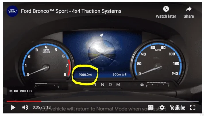

Did anyone notice how Ford paid tribute to the first year Bronco? :inspect: :rockon:
Ford Bronco Sport Is this 4WD false advertisement from ford?? Check out the picture.. 1643651669601
