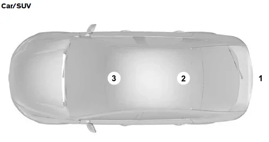

Great information. Thanks. I noticed the BS owners manual has an Electromagnetic Compatibility Appendices on pages 403 - 405. Not sure how useful it is but I was interested to see it.
Looking at pages 403-405, if I read this correctly, are they saying that 2m/70cm radio antennas can only be mounted in position 2 and 3, up on the roof. And really just at the very front or very rear of the roof. So no lip-mount? Is that what you all read?

That's my impression. Not sure if this is a guide to reduce interference in our radio or prevent interference in the BS electronics. With the wattage restrictions I'm assuming the later. Maybe a lip mount on the rear hatch, magnetic mount or drill a hole :surprised:?

I'll likely add the flat roof rack first, then position the antennas on the top towards the back, like I did on my Xterra so there is no problem with the antennas and the rack. I'm assuming it's metal so drilling the 3/8" holes won't be a problem. I use a remote control head on the 2m /440 radio and mount it to the top of the windshield via a suction cup rack. I'll past some pics once it all comes together, hopefully.
I got to take a test drive today. An initial look at the body, it looks like there are not obvious mounting points for the antenna. We can’t mount on front hood. No lips at rear.
I expect you are right about mounting on cross bars or platform on roof. It seems like a challenge. Will be good to compare notes
