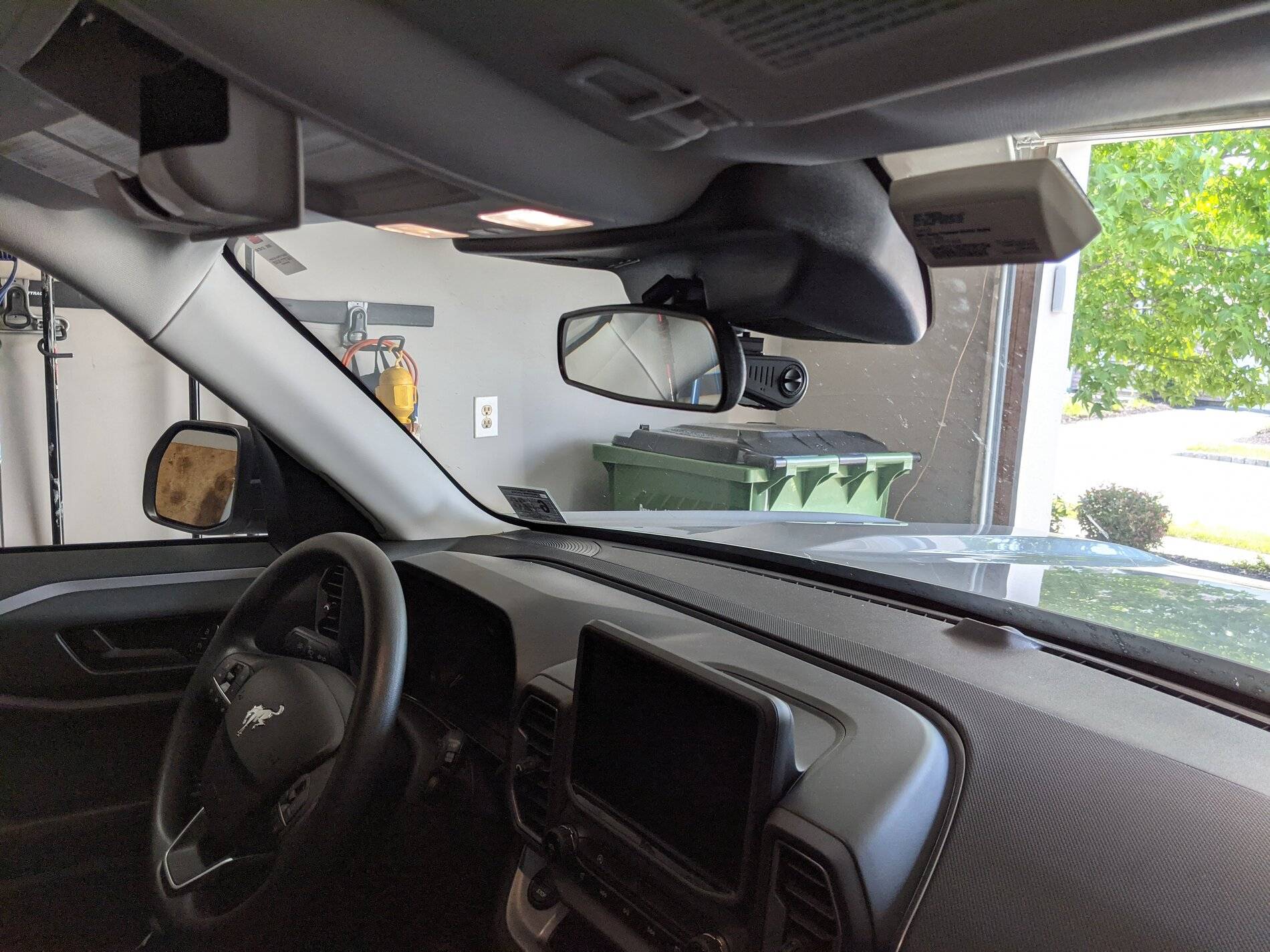

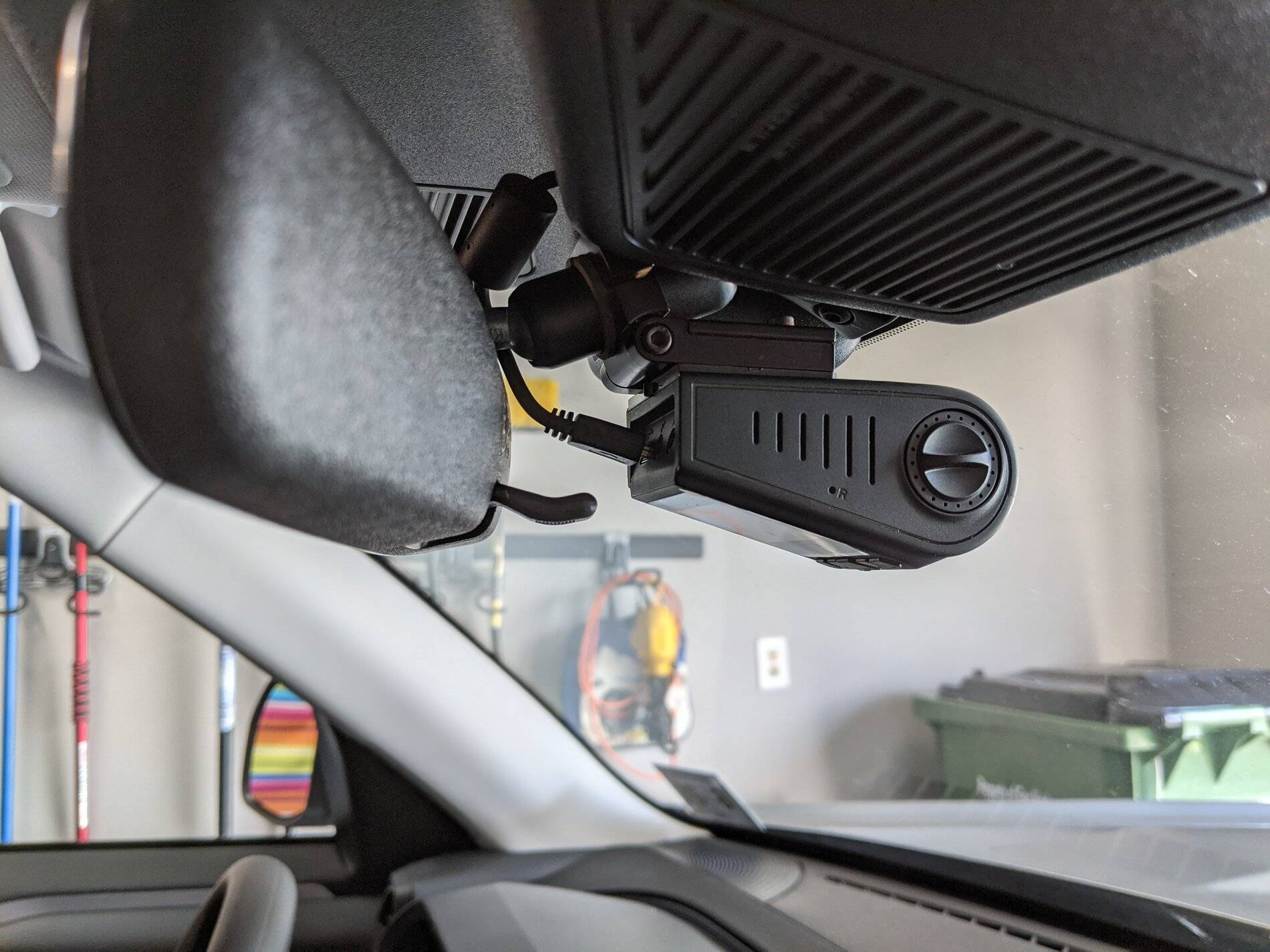

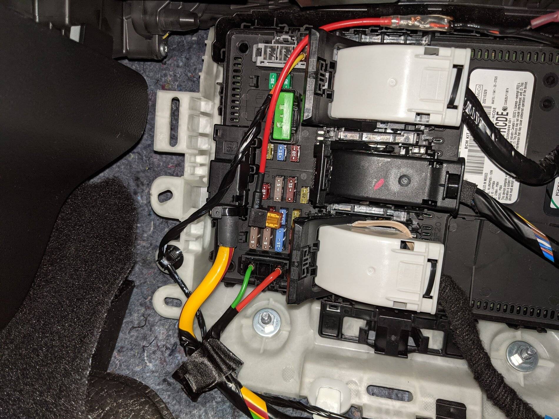

I just wired my dashcam up. It's a bit late as on Saturday a car crashed into me and 3 other cars while we were stopped at a red light. The dashcam was not needed for that in terms of at fault, but I still wish I had it as there are some questions about the strange ending positions of the vehicles and the damage suffered.
I have an older Street Guardian CX 1080 camera from my previous car. It had a power point to plug in and worked great in my Suzuki Sx4, but not so much in "Silvie" my Baby Bronco with the power point always being on.
My solution was I do not at this time want to use the parking mode, but do the the wiring kit to add it in the future. I took the power point adaptor and cut off the end to get the power and ground wire. I used fuse #3 as others have done for my ACC power. I found an exposed part of the frame on the passenger side up and to the right of the glove box, which I removed for easier access. I mounted the dashcam using my Valentine One radar detector Blendmount that attaches to the stem of the rearview mirror. I then ran the wires into the case for the Lane Assist camera system (Pushed in just enough to hide them) and then into the headliner heading towards the passenger side. I then pulled out the A-Pillar trim (Pull it towards the back driver side corner of the vehicle) and ran the wires down that. I then pulled the trim below the A-Pillar Trim out just enough to get be able to feed the wires into the area where the fuse box is located. All wiring was then zipped tied to available areas. It is a very clean and easily removed system from the mount on the mirror to the add a fuse for power to the impromptu ground.
In my Baby Bronco the Big Bend (W/O Big Bend Package) fuse #3 is only on in ACC mode or when the car is running. It DOES stay powered when the car uses Auto Stop. I confirmed while driving as I kept the area disassembled so I could see the power light on the little transformer in the wiring. I also confirmed by viewing the video footage. As I am always cautious I hit all wiring with my thermal imager after my test drive and the system works great.
Thanks again to what is shaping up to be a great forum with informative members.
