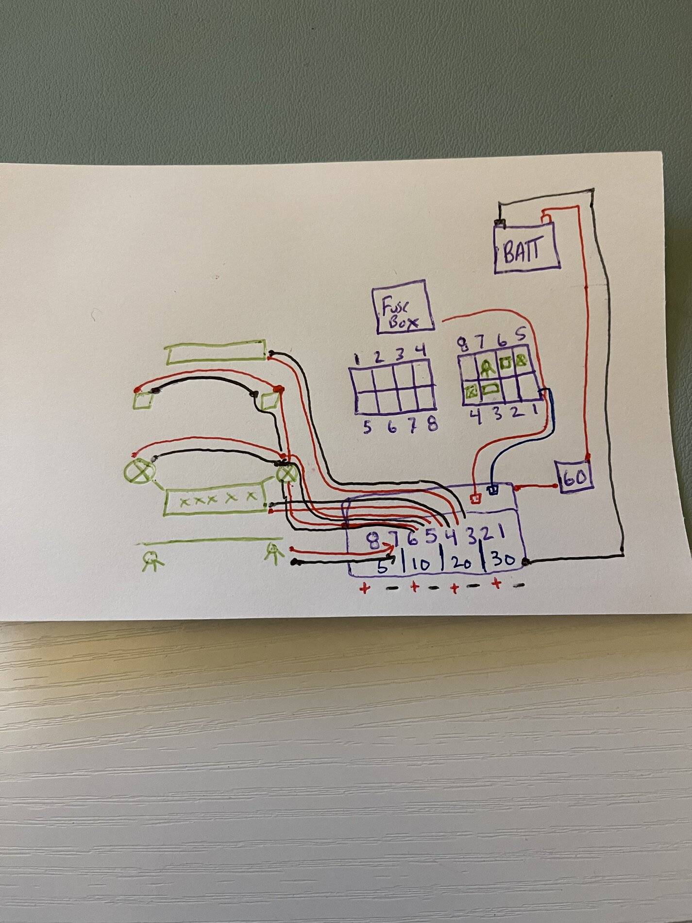

The first pic is the very unspecific instructions, and the second pic is the wiring diagram I created so I have a blueprint once I get into it. My plan is as follows.
Roof top 40 Inch light bar going to #3 (20 amp)
Grill mounted 20 Inch light bar going to #4 (20 amp)
Grill mounted round ambers #5 (10 amp)
Hood mounted ditch lights #6 (10 amp)
Under body rock lights #7 (5 amp)
I am leaving #1-#2 (30 amp) open for consideration of a future winch and air compressor, but maybe that's a bad idea? Any insight there? And then #8 (5 amp) is just open, no plan for it yet.
I do appreciate everyone's help.

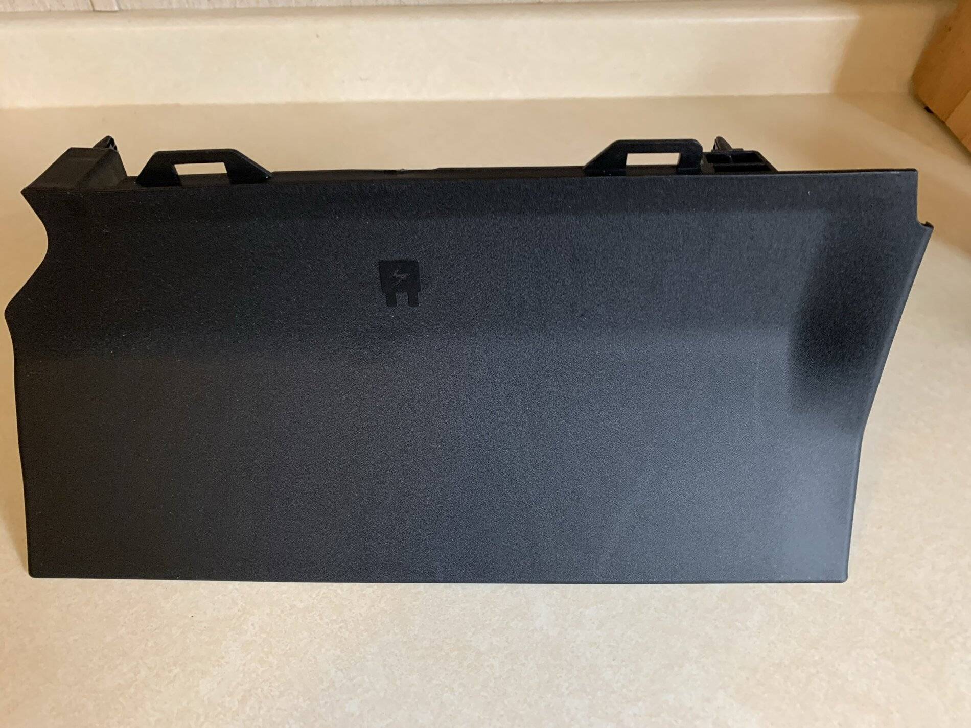

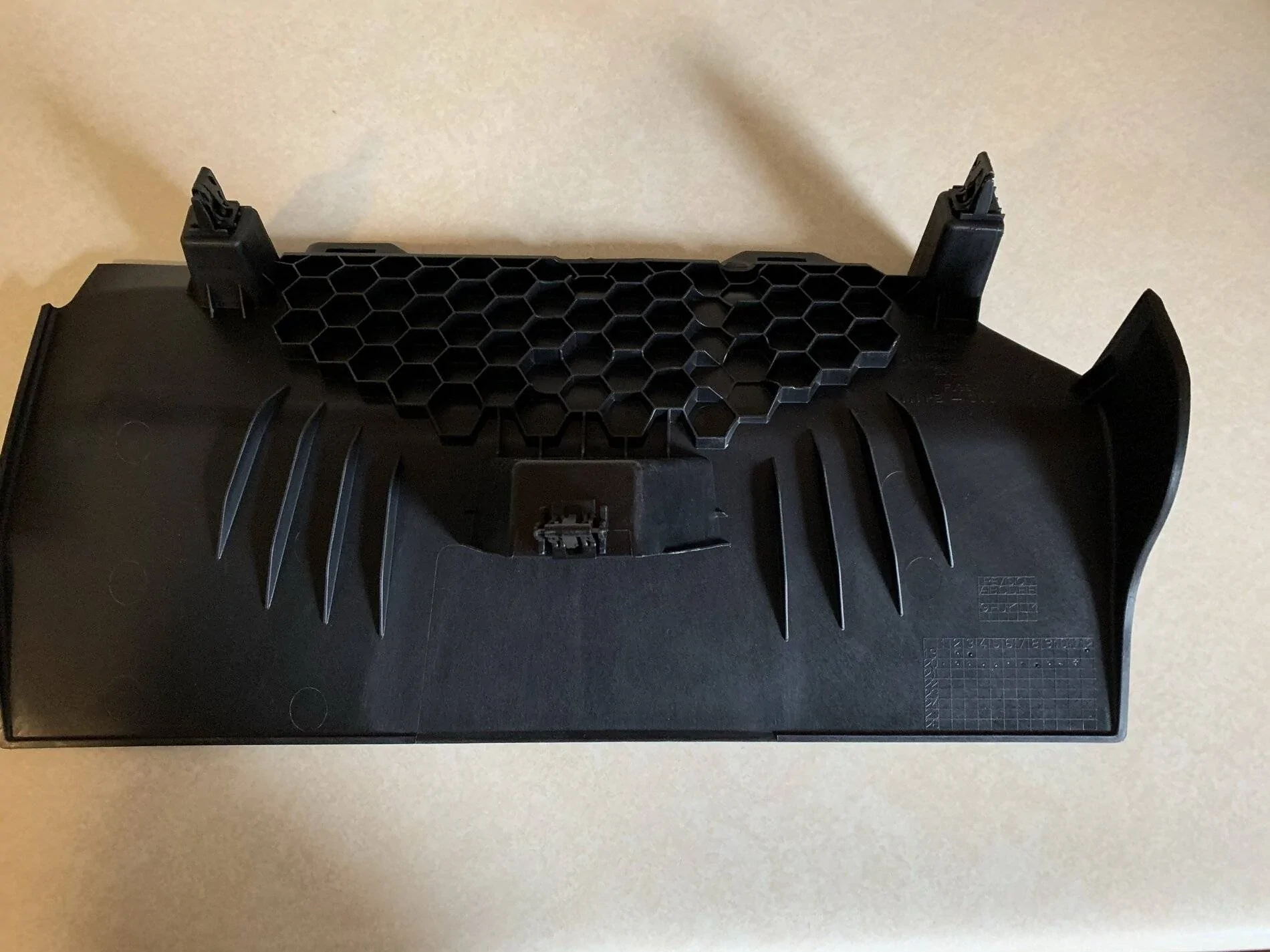

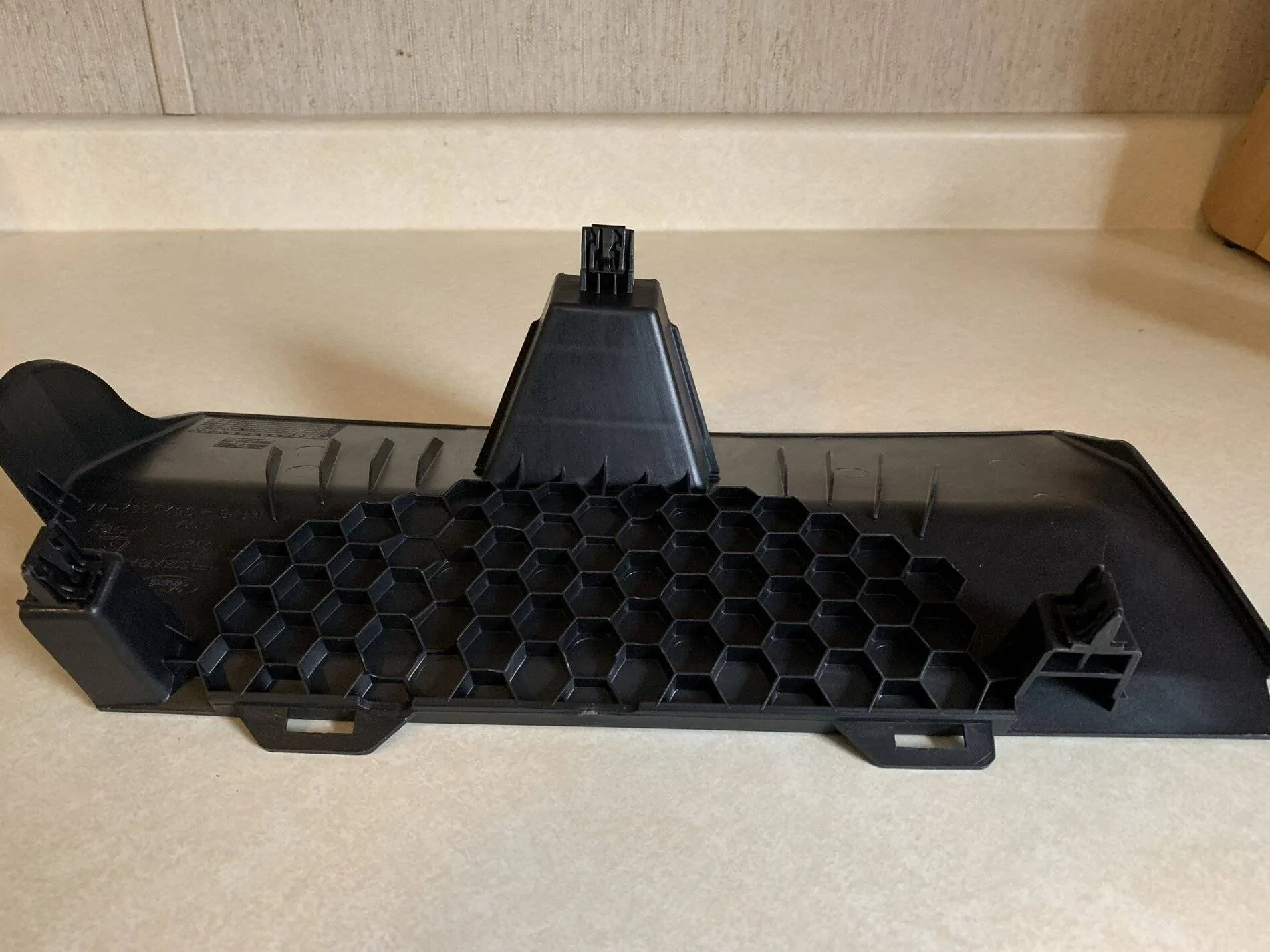

Ok, I got the Rexing Dash Cam hard wire kit and wanted to tackle the interior fuse box issue first. I found that the panel with the fuse emblem does come off by its self, though with some elbow grease. You think you might break it but you wont, well take it easy, all things considered. The panel has three male protrusions that sink into three female receptors. The bottom one lifts up easily, the upper ones need some convincing. Look at the the photos below and you will see what I mean. It should be an easier removal though. I will be reviewing the needed fuses next, not tonight...

Top latches easier to break than you might think - from experience ! Be sure to pull bottom out first. When you reinstall be careful wires are not caught in lower latch. A number of posts a few months ago on this by people installing accessories. Definitely room for improvement here Mr. Ford.
