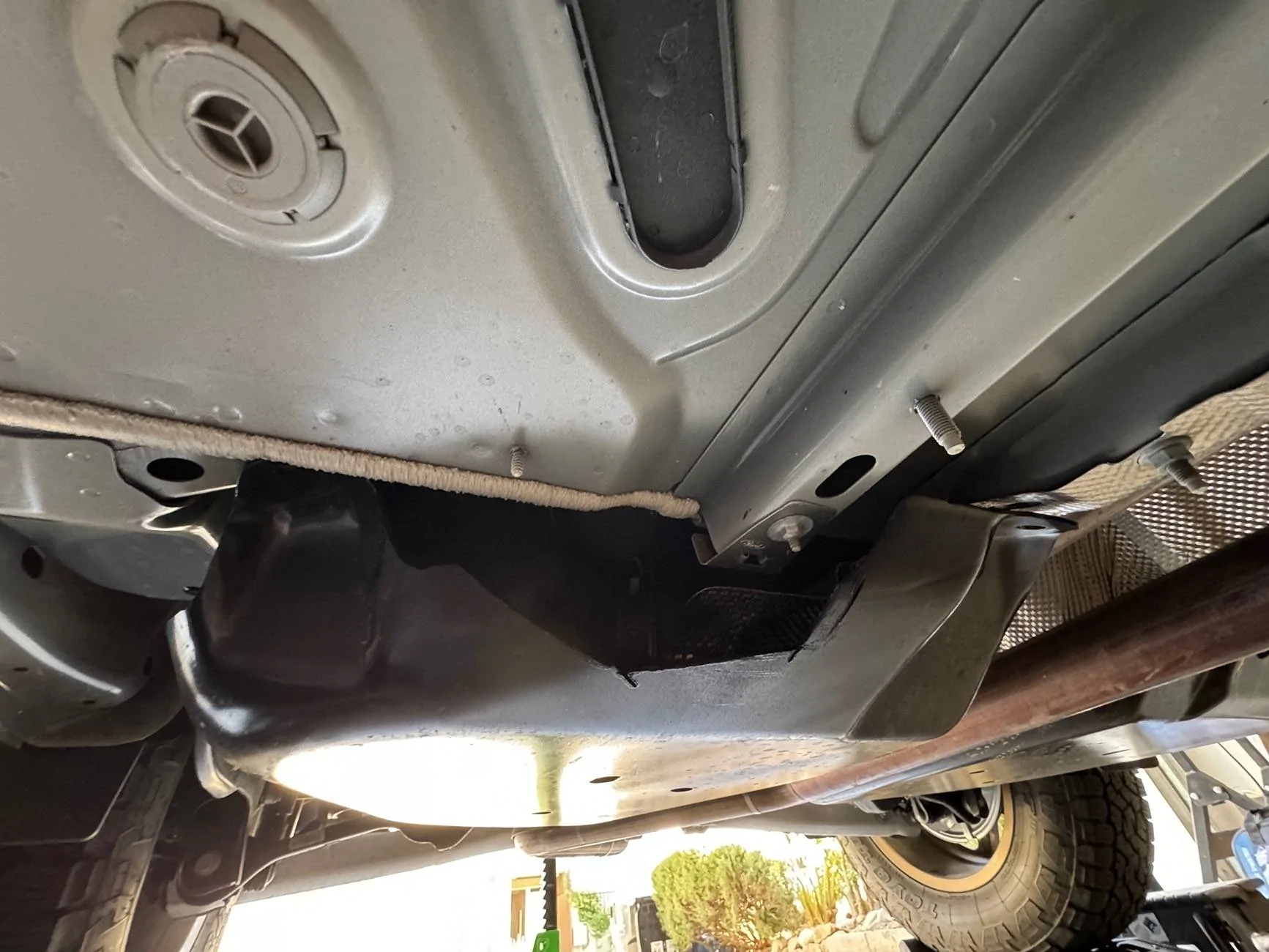

I haven't done the passenger side. After my last hunting trip, I'm thinking I need to. I high centered going into a wash, and scraped in the back as well. Trimming the gas tank skid was the easy part. Removing the skid plate was the hard part. They are locktited on, and to remove them, I finally had to use a mini torch to heat them. I did have a fan going to blow away any possible gas fumes.

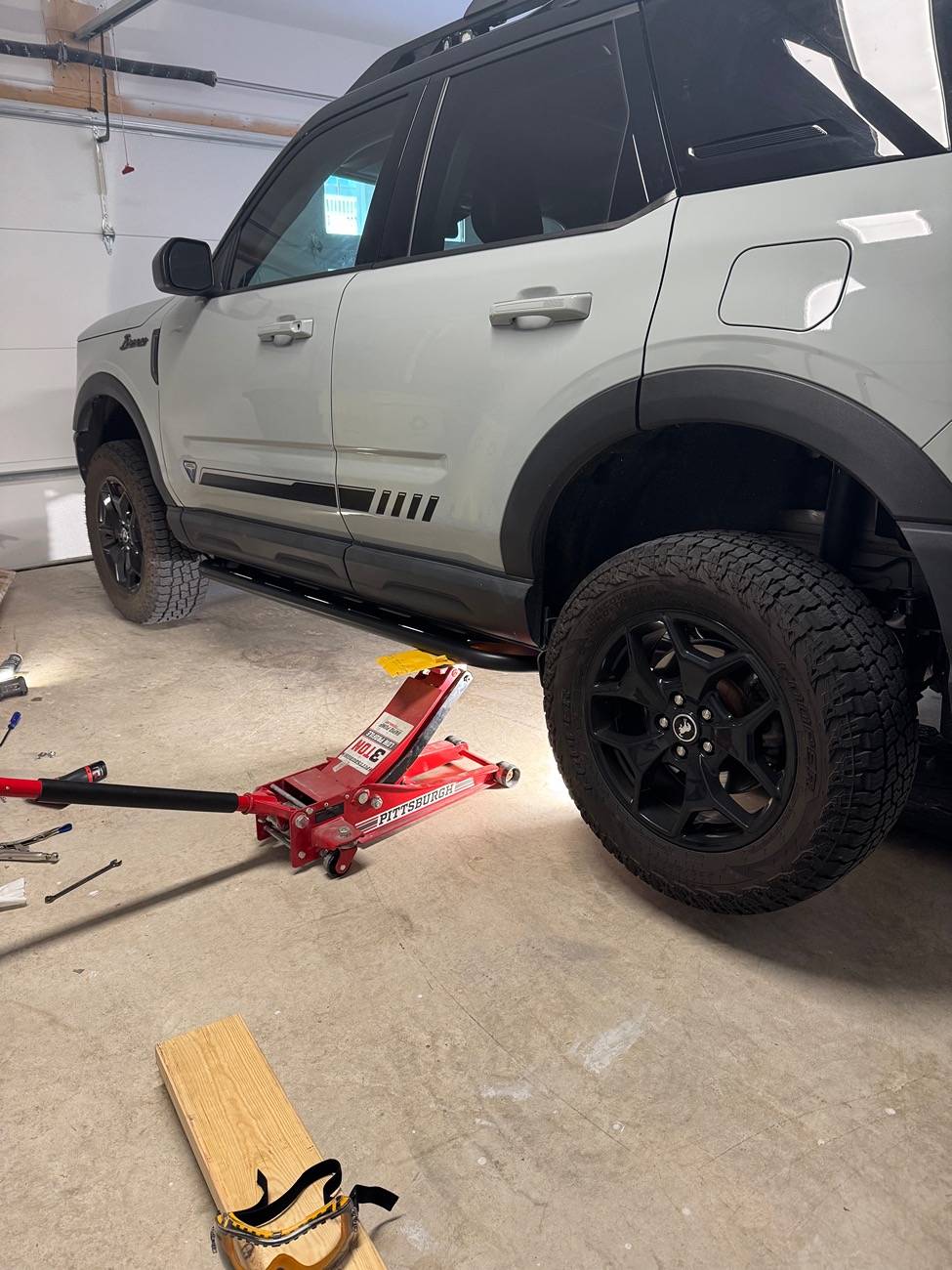

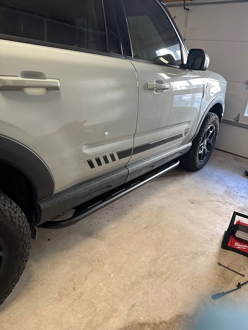

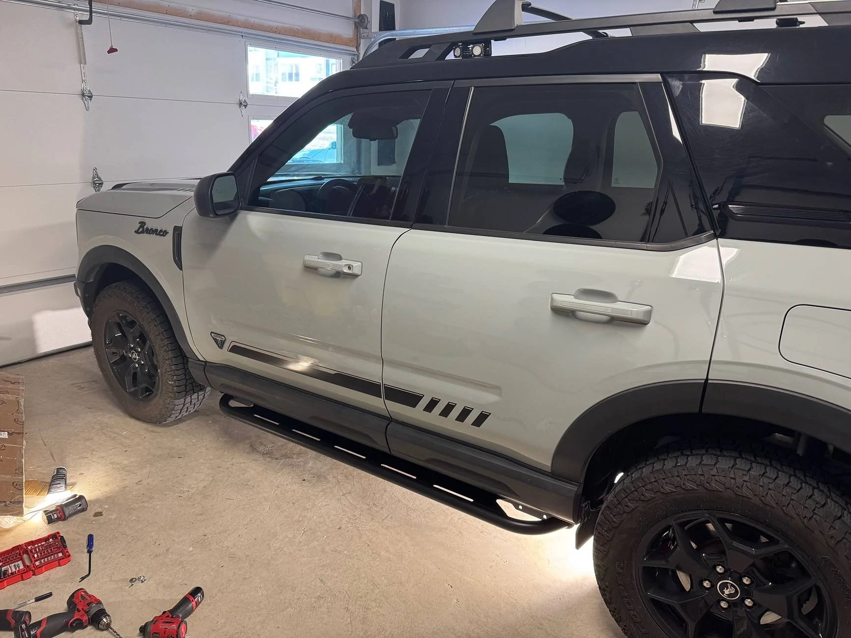

Much suffering later….they're on! Will have to get some glamor shots later. Stoked to have them, but very happy that’s over with. Since I’ve seen some conflicting posts about it, you do NOT lose any ground clearance. It kinda looks like it since the rails are below the doors, but the skids/rails are now inline with the gas tank and engine skid plates.

I cheaped-out and skipped on the sliders

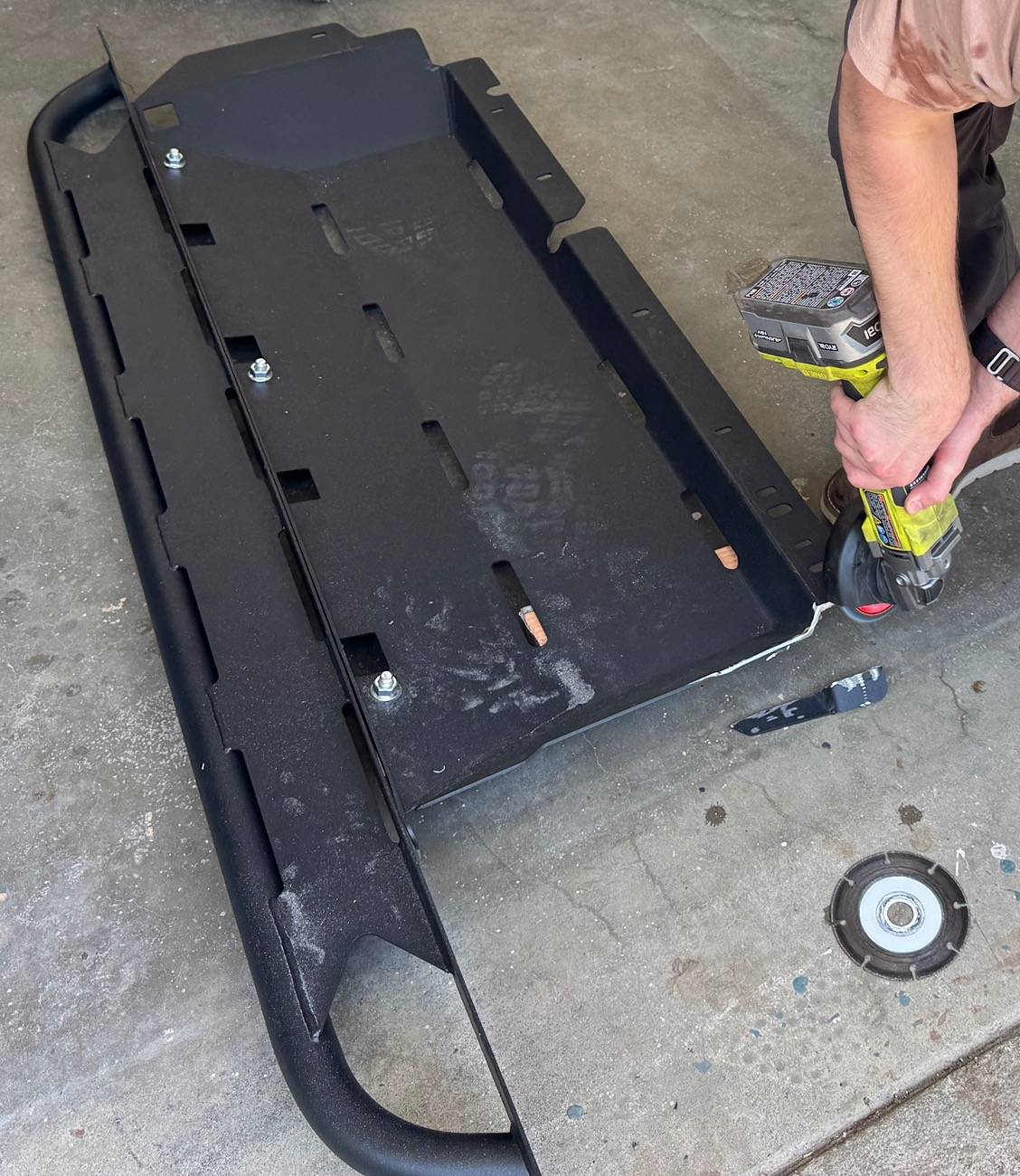

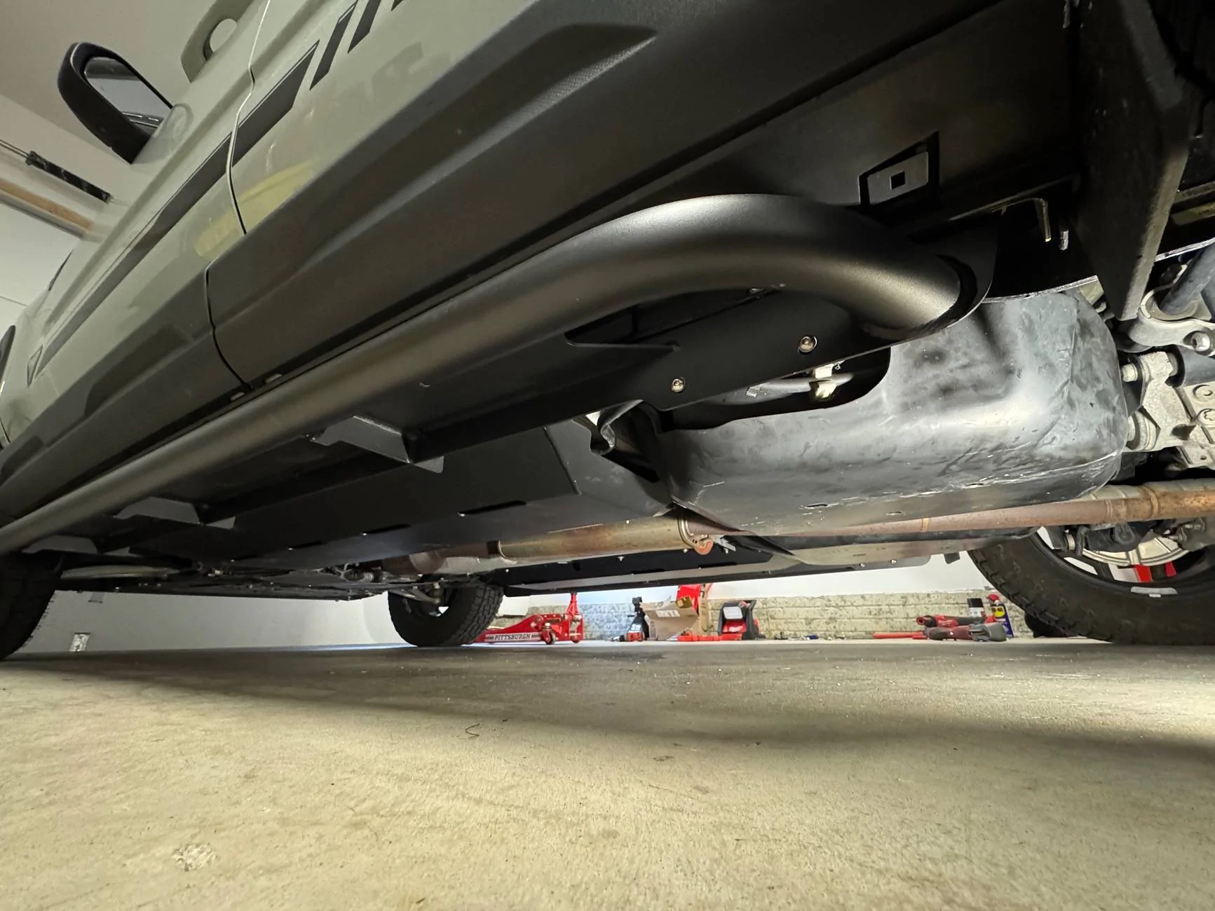

I just finished installing skids and sliders on my ‘25 Badlands last night. It took about 8 hrs of labor - 3 hrs drilling and 5 hrs iteratively fit checking, trimming, re-drilling, and beating the plates into submission. That was with on/off help from a friend who has much more experience than I have with this kind of work.
We ended up leaving the driver’s side fuel tank guard (the one that @NMhunter cut) alone and instead trimmed the skid plate to fit around it. I’m certain that’s way easier than taking the fuel tank guard off and trimming that.
Ford Bronco Sport Installed JCR Offroad Evap Skid on Badlands. IMG_2098
After that trim, the driver’s side plate was easy to bolt on, and it looks clean - no exposed lip to bite into rocks.
Ford Bronco Sport Installed JCR Offroad Evap Skid on Badlands. IMG_2128

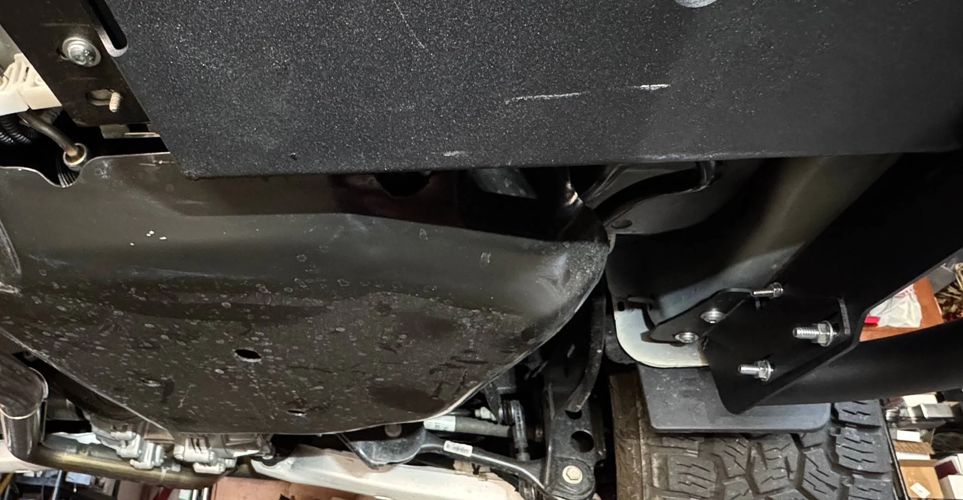

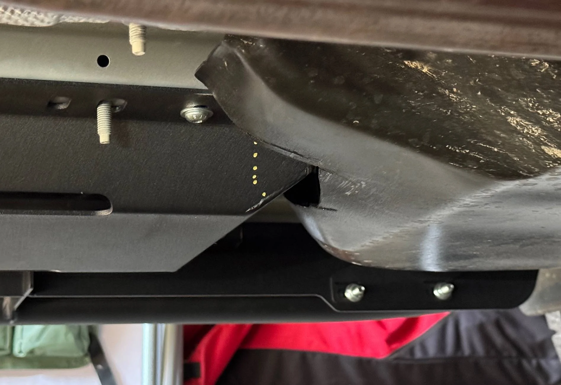

However, we tried to do the same on the passenger side but that tank guard extends a little further forward and covers one of the key mounting holes for the passenger side skid, so we trimmed both the passenger side skid plate and the tank guard, and finally got it all to fit on the third try.
Ford Bronco Sport Installed JCR Offroad Evap Skid on Badlands. IMG_2119
We definitely could have made a cleaner cut if we had taken the tank guard off first, and in retrospect we should have done that since we ended up needing to unbolt the darn thing anyway to maneuver the skid into position and access the rearmost inboard mounting hole for that plate. The tank guard bolts were difficult but thankfully didn’t put up as much of a fight as @NMhunter had to deal with.
Not as clean as the driver’s side, but it’ll do.
Ford Bronco Sport Installed JCR Offroad Evap Skid on Badlands. IMG_2129
All in all, I’m happy to have the plates and sliders on. Peace of mind on the trail will make the cost and effort worth it.
Thanks @NMhunter for sharing your experience here. Despite the troubles you encountered, you gave me hope and your pics helped a lot. I hope my additions here will also help someone out someday. ??

Certainly a pain in the ass to install but very well worth it, I’ve come down pretty hard on my rails on some Virginia mountain ledges and they’ve done their job. Nice work!
