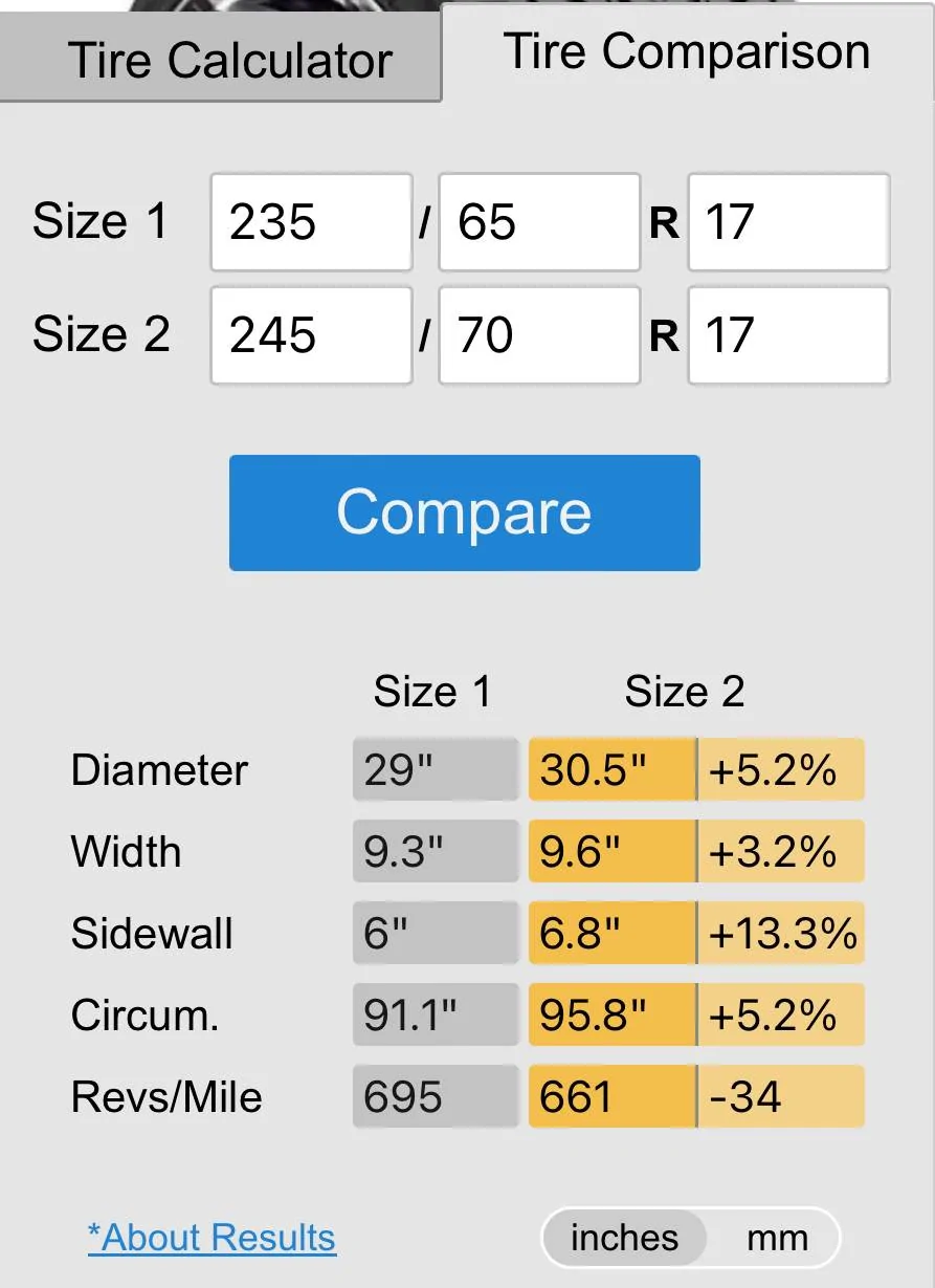

While its in the shop I am going to have them put on a fresh set of rubber. I love the BFG KO2's but the noise has gotten obnoxious no matter how much I rotate and balance them. Tons of great tread left and they have been awesome off road. I have a RC lift and i think i'm going to go from a 245/65/17 to a 245/70/17... still not set on a brand or tread pattern yet. Anyone running that size? What brand tire are you running and how do you like it?

I second what Dude said above. From all accounts that I’ve seen 245/65r17 is the biggest you can go. Anything larger will surely rub with any articulation and lock to lock. If road noise is main concern I would say stay at same size but different tread type more focused for on road than off.

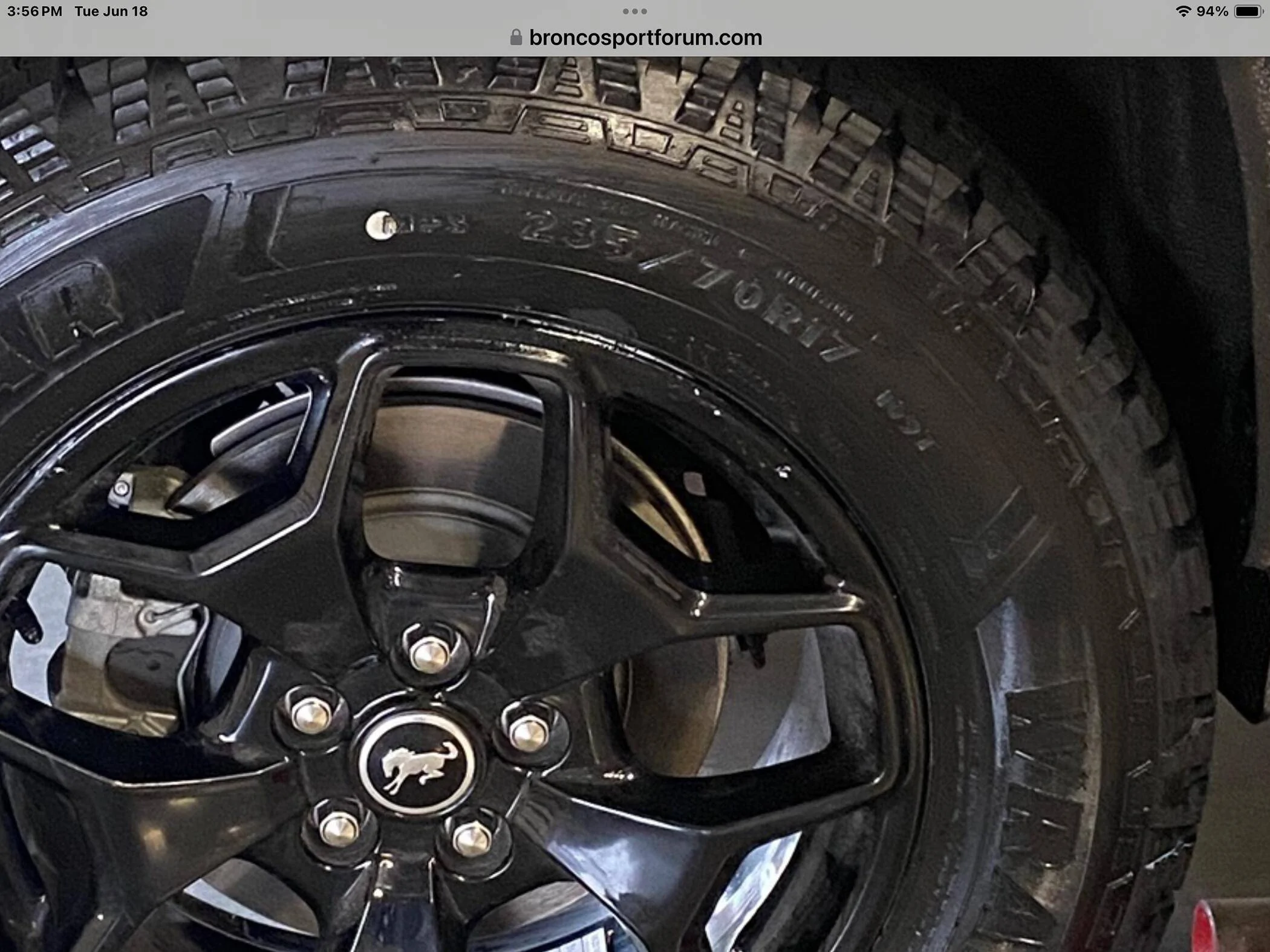

235/70/17 Goodyear workhorse 30.1 diameter, on mine for 15 months no issues

Well I stand corrected ??‍♂ If you say there is no rubbing at all I will take your word for it
The difference in 235 over 245 is the width, that makes the 235 a non issue on rubbing.
Correct. What I was assuming was that increasing your aspect ratio would cause the wheel to rub the wheel well. However it seems I was incorrect in that thought.

Tires... 245/70/17 absolutely zero rubbing even at different angles of suspension travel and full steering lock with an RC lift.
