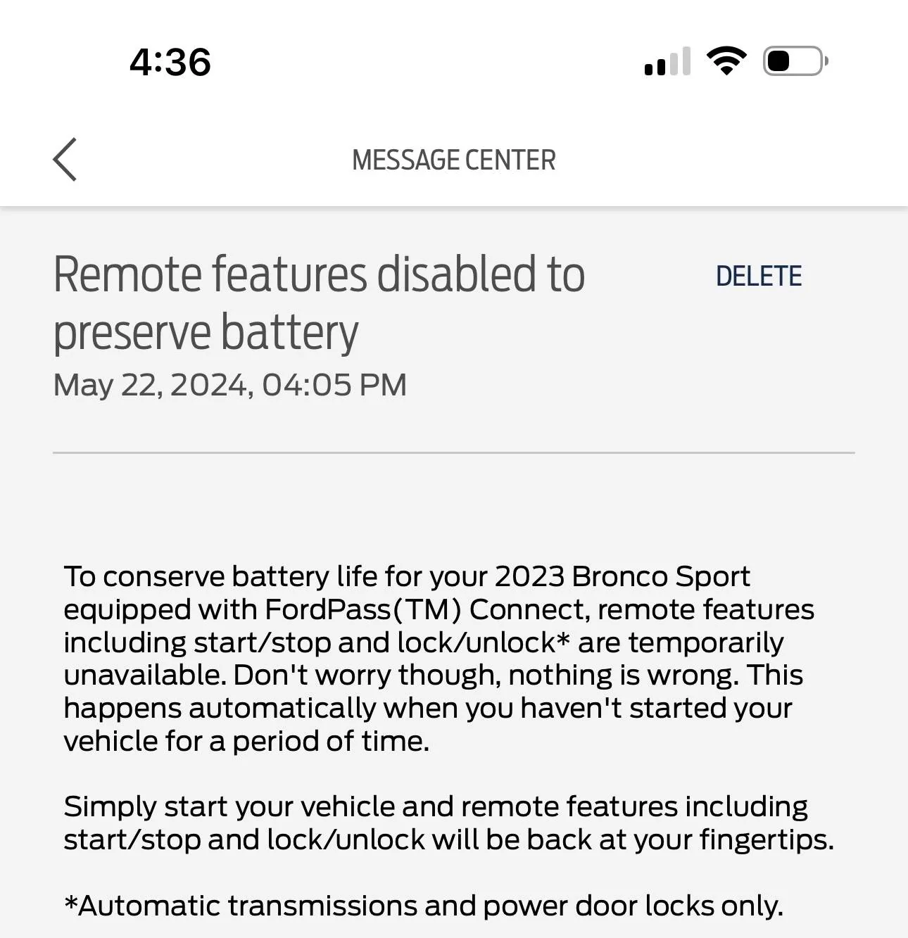

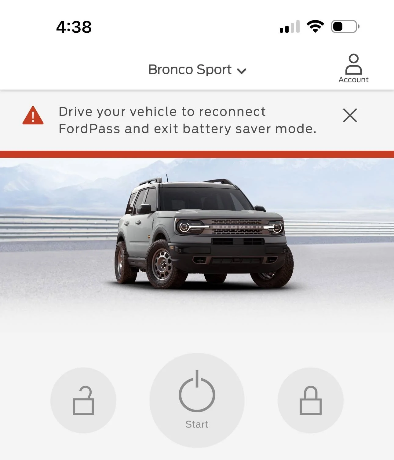

Hey Fam! I’m usually stalking ya’ll & learning from afar. There is such an impressive group here that just blows my mind when it comes to auto knowledge. Anyway, these messages popped up just as I came home. So I immediately went back & restarted it, & backed up & down my driveway thinking that might help IDK. Please help, do you think these messages have something to do w/the recall? I drive my Badlands everyday at least 25 miles. This is the first time I’ve experienced these messages... “Mrs. Mighty“ drives like a Tank & I haven’t had any issues with it. I’m just shy of 5K miles. I Thank you in advance
Ford Bronco Sport Does this message pertain to the recall? IMG_6912
Ford Bronco Sport Does this message pertain to the recall? IMG_6911
105
4,168
4,710
Yes most likely your battery is not charged enough. The recall for the software only updates for BCM Calibration and PCM Calibration might solve those sorts of messages. However you should have your battery tested with a load test (not just a simple voltage test). Some brand new batteries have been known to fail.
My guess is you are not driving enough and a 30 minute drive at least at 30mph would charge up the battery and those messages will (might) not reoccur. Doing that sort of drive at least a couple times a week is recommended. If you already do that or more have the battery and charging system checked out. 5k mileage is basically a brand new vehicle.

IDK …vehicle is 5k mileage. Yes it could have a marginal or defective battery but unlikely. And a vehicle that cannot maintain a charge by driving it multiple times a week minimum of 30 miles at 30mph or higher each time (and let’s keep auto stop/start off to eliminate that variable) .., with no changes to factory equipment is a defective vehicle.
Sure recall 24S24 (BCM AND PCM Calibration recall) could play a role but not on above scenario.

I drive it for @ a 25 min commute to work, then for a quick lunch then back home. All city driving. I hit the hwy on the weekend for errands. So my car is differently spoiled. I don’t use the auto/ start cuz it’s just annoying to me. So I always turn it off first thing when I get into the car. But look at the pic, it’s off all by itself. Didn’t come on when I started it. I called the dealership & made an appt for the recall update & battery check for next weekend . Adviser told me they would only replace it w/my exact same Motorcraft as they don’t sell any other brand. Can’t upgrade it.
Ford Bronco Sport Does this message pertain to the recall? IMG_6920
6,731
13,134
The text of the recall suggests some cars' battery management systems may not provide enough charge to recharge the battery while driving -- which, I agree, is the very definition of defective.
@Sojourner has the best advice: put a battery charger on it until you get the recall work done. Some owners have been stranded when the alternator fails to recharge the battery while driving. A fully charged battery should get to work and back with no problem.
