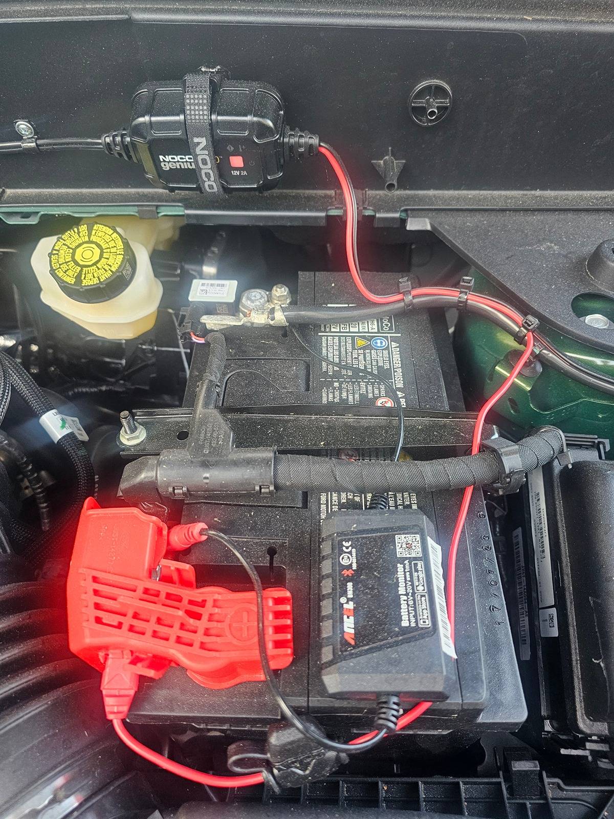

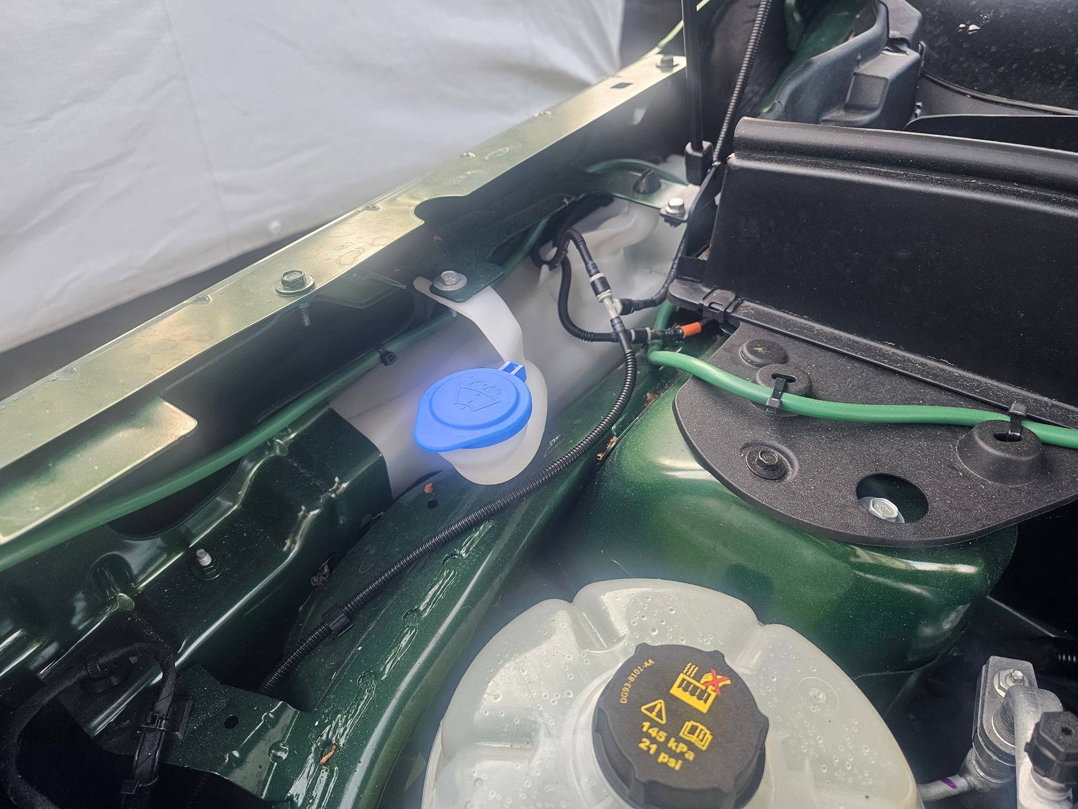

Here's some pix and a walk-through of the NOCO Genius 2D install (idea not mine; it belongs to @MAGPLM) for @mrs mighty and anyone else interested.
- Red wire to battery, black wire to chassis ground (Pic 2).
- Mount NOCO Genius 2D bracket to PLASTIC trim with screws and I used clear silicon adhesive to keep the screws snug. There is NO mounting into metal anywhere in this project. Snap the NOCO Genius 2D into the bracket.

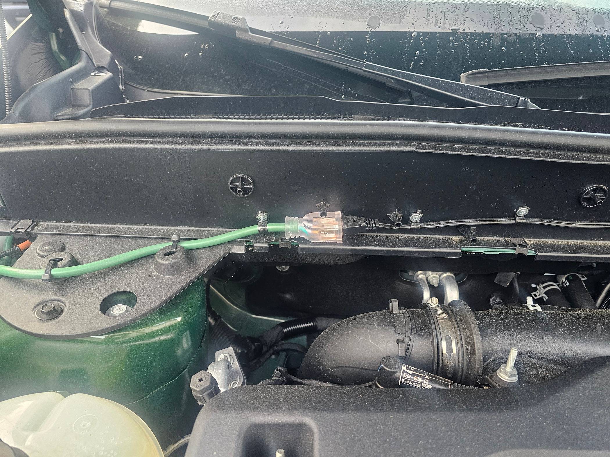

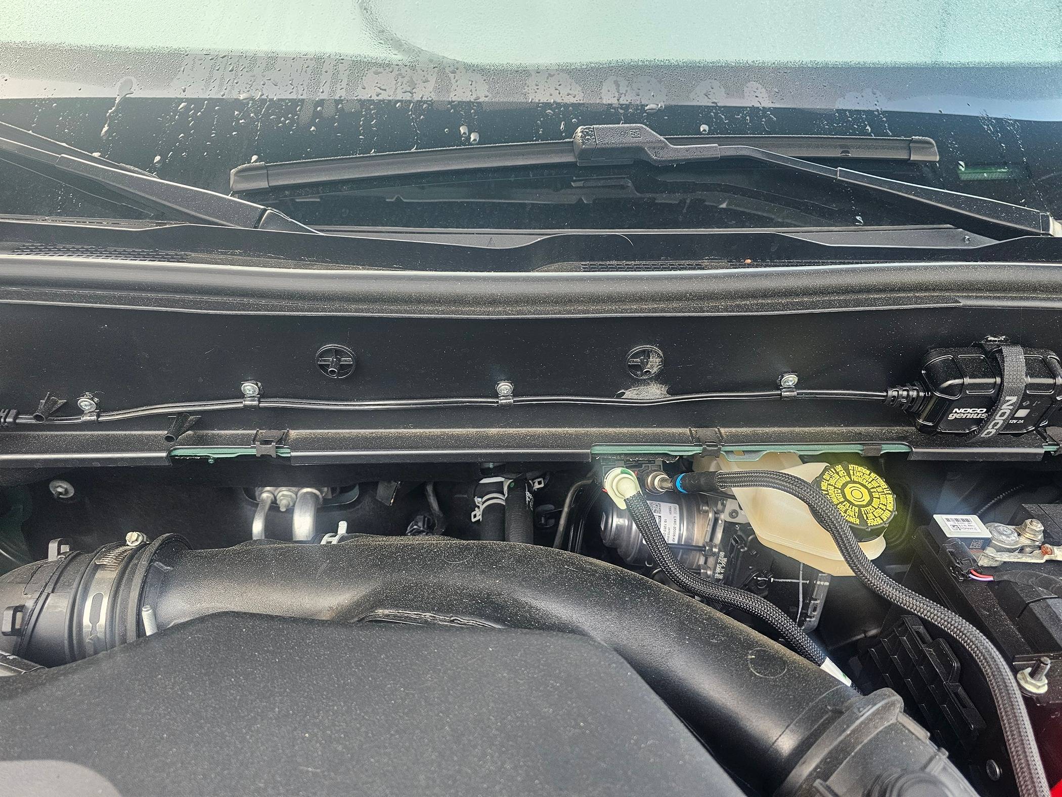

- Run NOCO Genius 2D plug wire along PLASTIC trim and secure using clamps and screws (and clear silicon adhesive). Bought clamps and screws at local Ace. Bring that plug wire to a convenient place under the hood so that you can connect a power cord from your home source. I didn't want to be opening the hood all the time so I kept following MAGPLM's suggestion. That's the following steps.
- Connect to a 6-ft extension cord (I went with 14 gauge; I used this extension cord. I mention this particular cord because it is available in different colors). Route it around engine bay. Use clamps/screws/adhesive and plastic tie wraps along the way to secure.
- If you're going to follow MAGPLM's method, drop the male plug end of the 6-ft extension cord down in front of front right wheel where it can be accessible to "shore power" electrical cord. I think the best place is just in front of the right front wheel well somewhere. I went with the space just in front of the wheel well liner. To get in there you remove the push pins at the front of the wheel well to access the space the extension cord drops down into. Easy to remove the push pins and replace when done.
- Following MAGPLM's idea, I did install the NOCO GCP-1 (see next step) method on four of five vehicles. On the fifth, the F-150 just has the extension cord dropping down into the space in front of the right front wheel well and rests on the skid/bash plate (because there wasn't a good or easy way to install the GCP-1). For the F-150 I use this to cover the plug when not connected to shore power. So if you're not going to go the GCP-1 route, then I suggest the plug cover. Anyway, on to the GCP-1

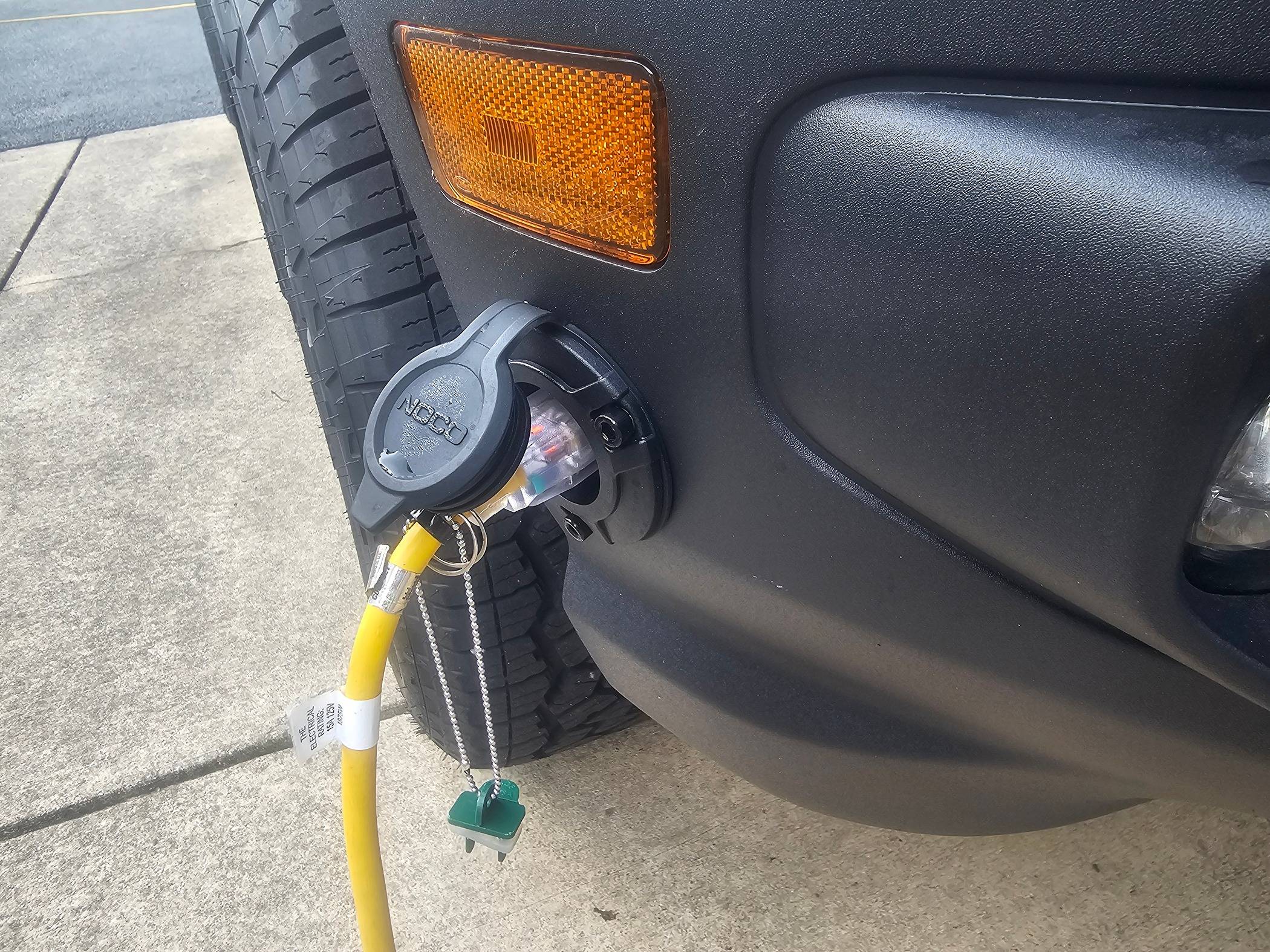

- Buy the GCP-1. Use a doorknob cut-out saw (something like this) to cut a (IIRC) 2-inch hole in side of front trim. Instead of supplied screws from GCP-1, I used 1/4-20 (M6) Allen head bolts/nuts and locked it down with blue thread locker (I used this; less messy). Use M4 (or SAE equivalent) if you don't want to enlarge the holes of the GCP-1. Connect GCP-1 to 6-ft extension cord.
- Plug shore power into GCP-1. Voila! AND DON'T FORGET TO UNPLUG WHEN HEADING OUT! (Advice passed along from a "friend" who forgot and didn't....:crazy: Fortunately, no damage. Only embarrassment.)

Nice clean installation! As a technician, I would have been all about doing that -- 30-40 years ago. :cool:
It eliminates the need to open the hood to connect the maintainer. As I mentioned, it is good to check the oil, hoses, belt, etc., regularly -- but maybe not as often as a maintainer is connected, so having the ability to plug in without lifting the hood is a plus -- particularly for those with limited mobility.
You mentioned one issue -- the possibility of the owner driving away with the cord still attached. That came up recently when my brother and I were discussing installing a BT on our parents' car. They are older and while they probably could raise the hood, they'd rather not -- and there is some risk involved -- especially for elderly people. For that reason, my brother and I discussed either a) installing a 12Vdc cable with ring terminals and a SAE 2-pin connector (supplied by BT) or b) installing the BT under the hood (as above). Then we quickly realized that one of them might drive off with the cord (either 12V or 120V) connected. We found *magnetic* connectors that looked like they would work well. I say "looked" because our father changed his mind, so we never did the installation.
Here's one example. I know nothing about it, I am not necessarily recommending it, just using it as an example:
https://www.amazon.com/VoltSafe-Magnetic-Extension-Block-Heaters/dp/B085W5RJ4P/
It's pricy, in part because it is designed to carry the current for a block heater. From the Amazon page:
