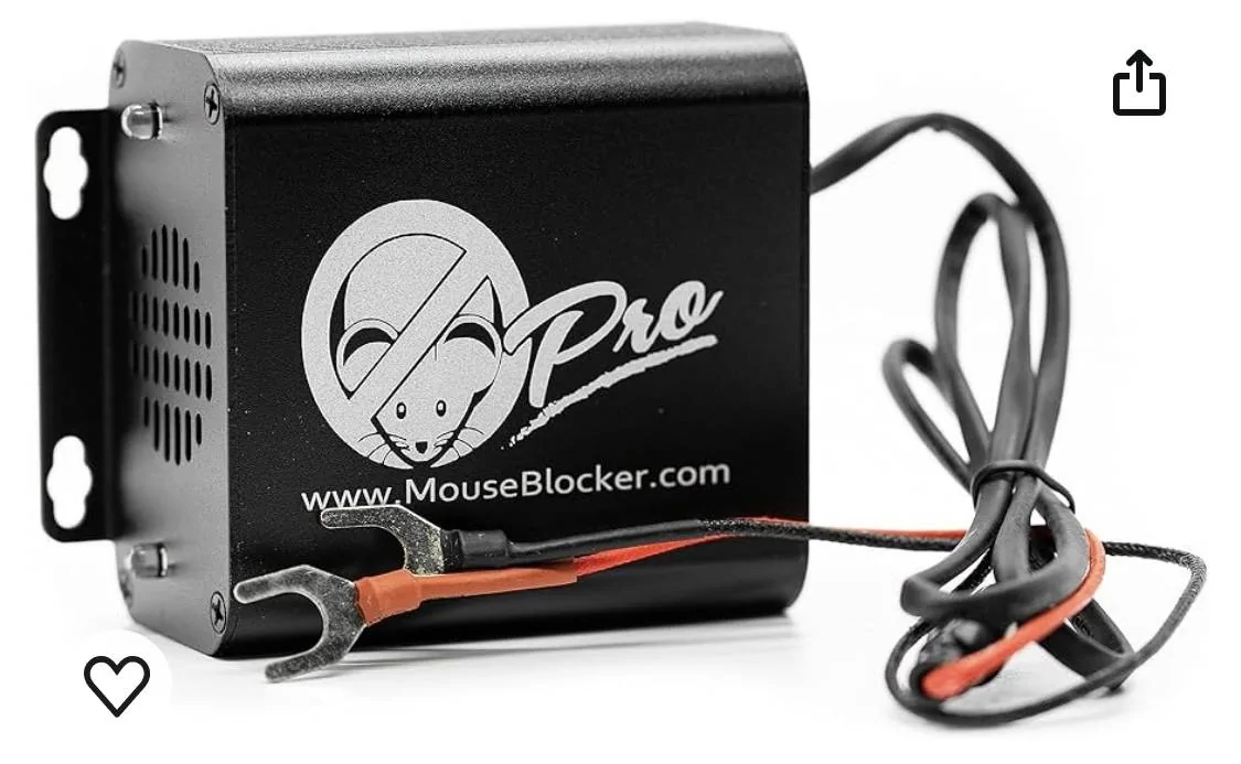

Furry Woodland Creature got into my Engine Bay. Iā€™m dealing with this Issue right now 2nd time. Thought it was miceā€¦after the second time found it might be Squirrels. $1,500 first time, second time $2,200 insurance will be handling this one.
2010 F-150 Harley Davidson Edition with 65,000 miles, she parks outside. Garage is in the future, just not yet. Should be getting her back today.
Going to install this hope it helps, if it doesnā€™t Iā€™ll have to sell my Truck. Inside the vehicle sounds worse that just the engine bay.
Ford Bronco Sport How the H*LL did THAT get in there? IMG_0365
This sounds fairly frequent. Are you fairly rural?? It says 'Nashville' so I can't imagine how far out of town you might be.
