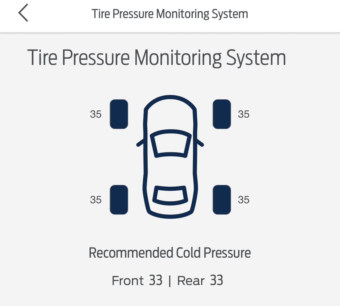

I've filled my tires up to 33 psi several times now and when I check in the menus, they're at 31 psi.
I have 2 analog stick gauges, made by Milton, and they showed about 32 psi.
After I drive for a while, the tires will go to 33 or 34 psi but this got me thinking one of them may be off a couple of pounds.
I don't have a digital gauge but I do have access to a compressor that has a digital gauge and auto shut off. I'll try that out next week. It's been hot in Texas so I've had to check either early or late in the day.
“Analog stick gauges” are notoriously inaccurate. Just invest in a small digital gauge.
I use my digital gauge in the morning when there in no direct sun on the tires. I am usually right on between my gauge and the readout on the dash.

Checked when i got home from the dealer and my tires were inflated to 42 psi at the time of delivery. I broke out the tire gauge, adjusted pressures to the numbers on the door and all the fancy electronics (in car and app) tie out with my pressure gauge.... Well, as close as i can tell with the analog, dial-type gauge. They seem to be holding pretty well too.
Agreed. I have a Joe's Racing dial gauge that's pretty accurate and it matches the TPMS. Also, like yours, both our Bronco's were way overinflated when we took delivery.

Rule of thumb is you lose 1 PSI for every 10 degrees F colder.
That’s a good rule of thumb.. last week morning temps were mid 90s and 35psi for the BS tires, a week later and temp in garage today is 79°. On the “warmer” side of garage both tires read 34psi and the opposite side tires read 33. Your rule is accurate. ?
