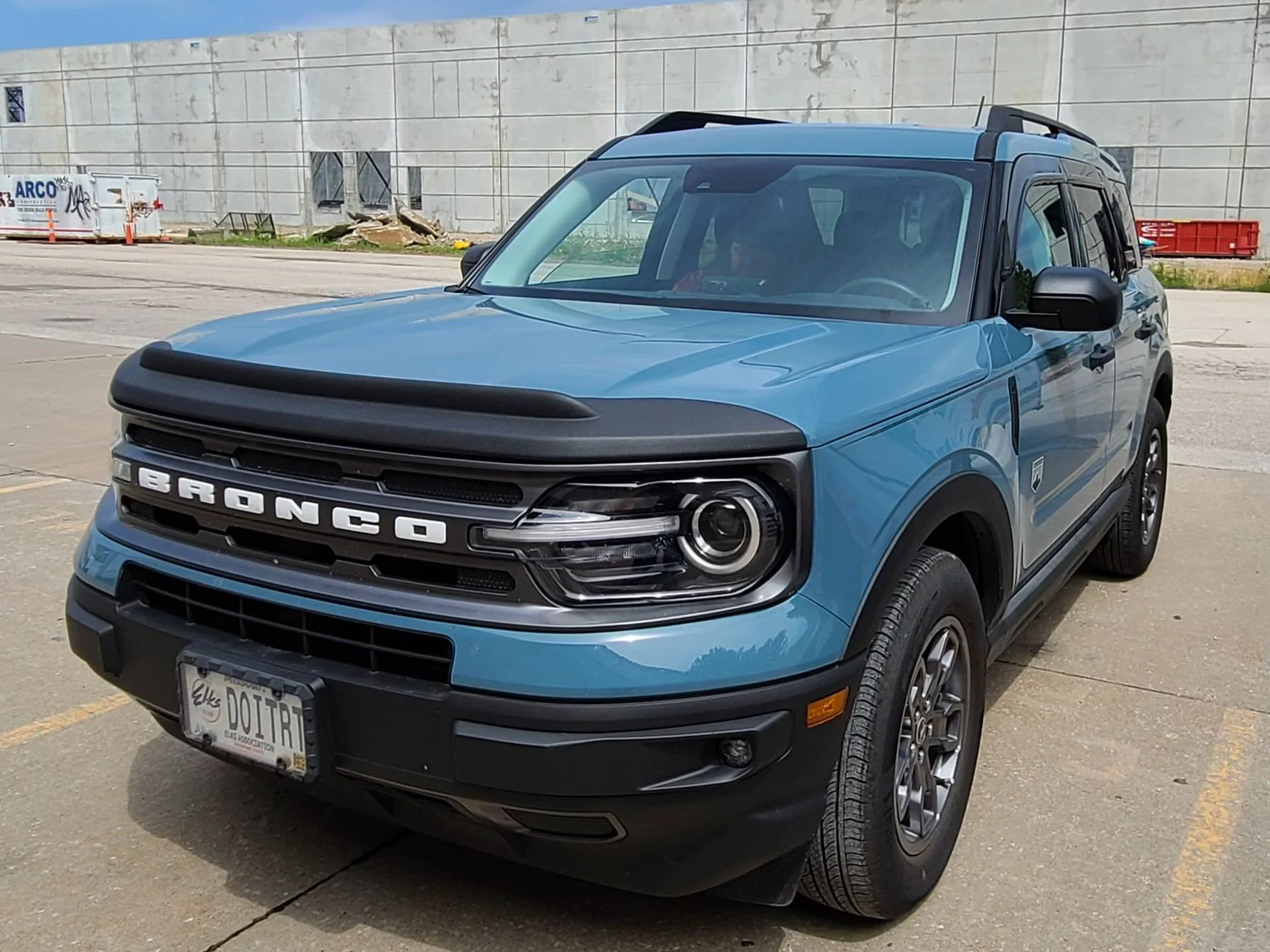

The hood shakes with a hood deflector or no hood deflector. . Just the BS. My hood does same thing before and after install. But the aeroskin 2 color and texture match everything on vehicle perfectly. My opinion

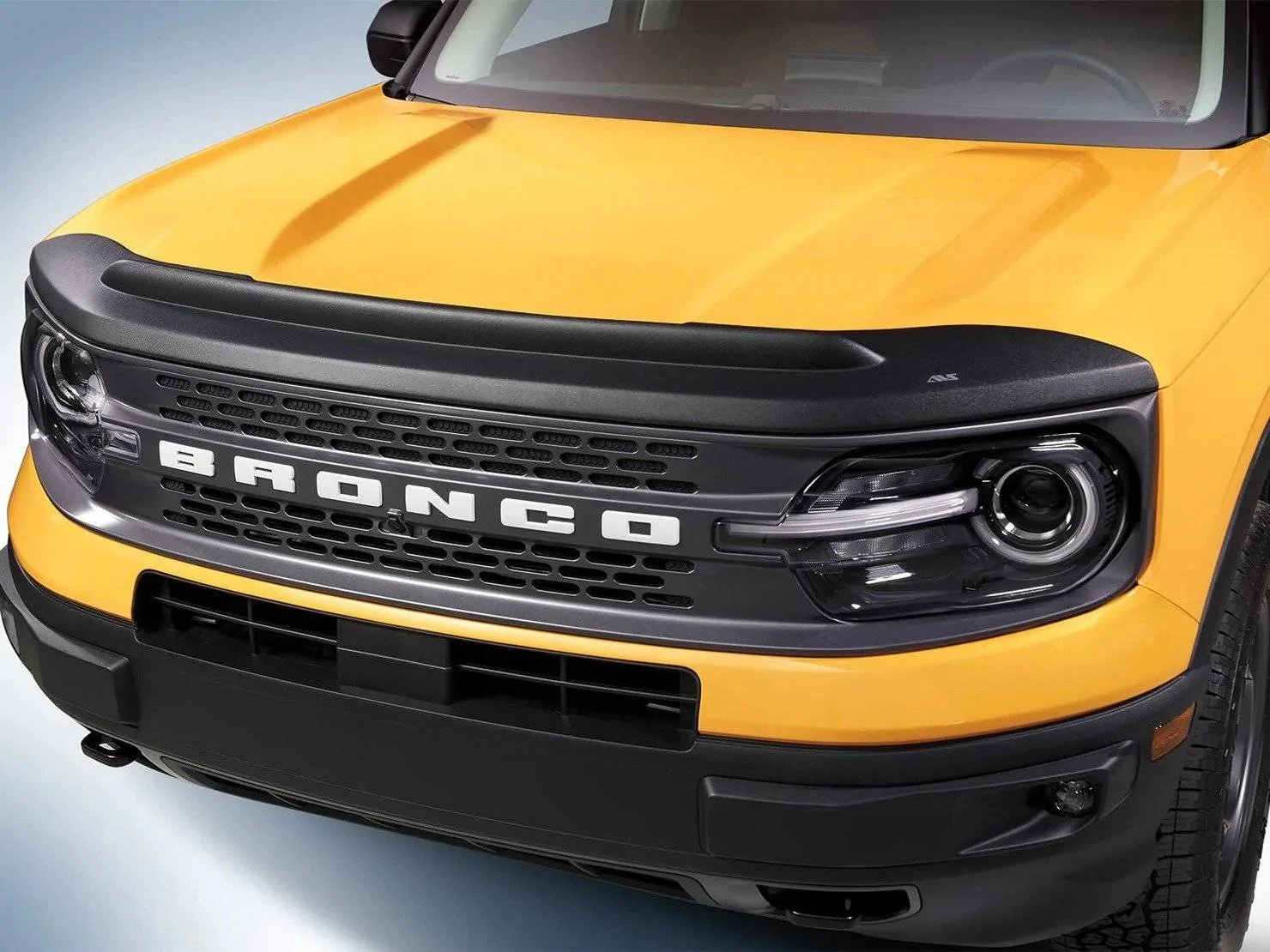

Can anyone verify if there are any logos or markings on the Aeroskin 2 like what is pictured on the Ford website?
