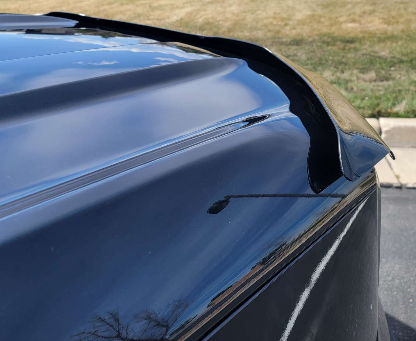

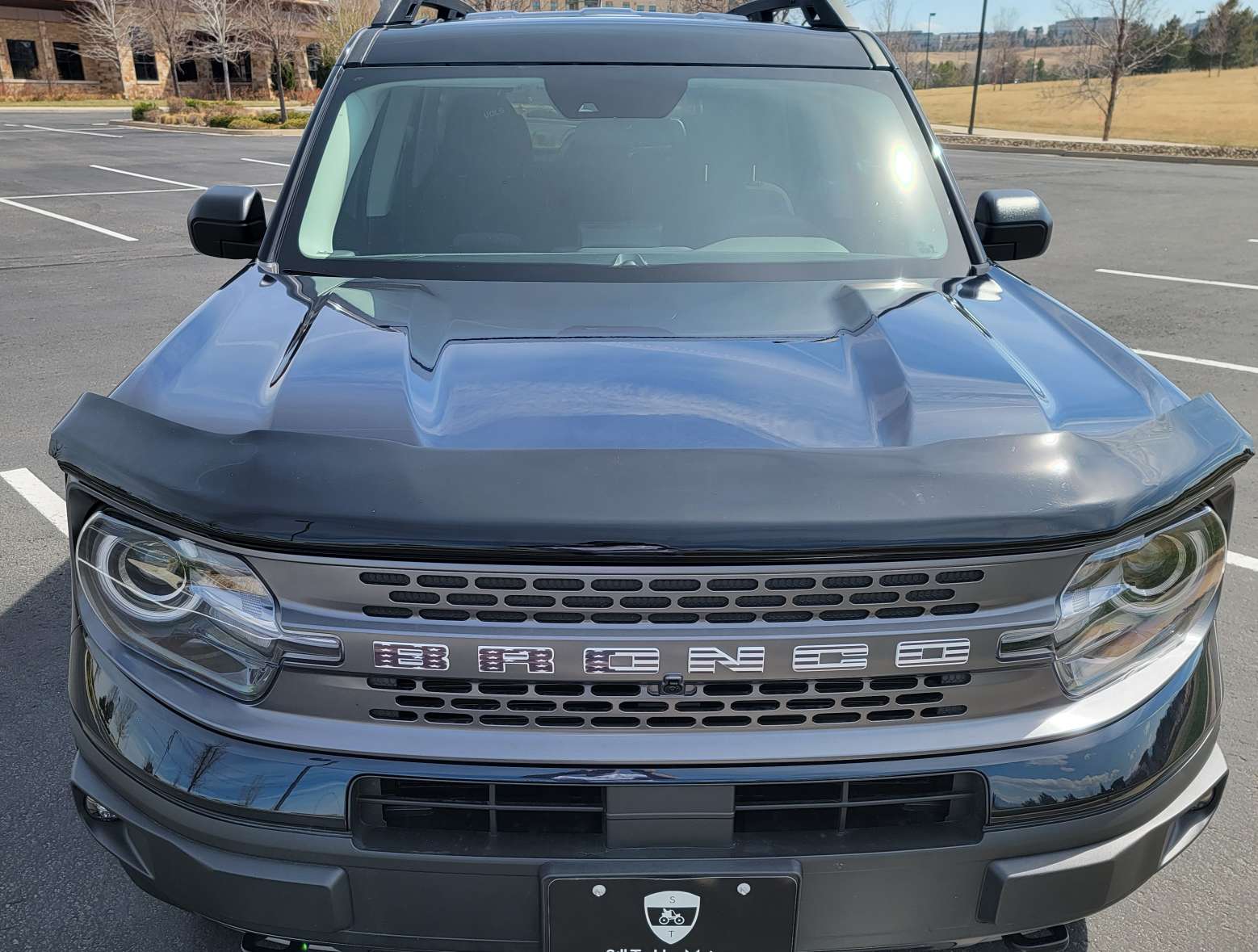

So went to Weathertech and had their installer try to get it to work. After awhile he was able to get it to work and make the hood close properly. Apparently the instructions included were generic. If anyone is looking to get this one the trick is to turn the hood bumpers by the radiator as far down as you can (instructions say 1 1/2 turns) but you need to go way more.

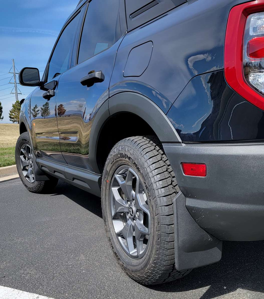

Anyway here is some pics with it installed. Does not touch the hood anywhere. as well as mud flaps
Ford Bronco Sport Hood Deflector Options Compress_20220402_145045_5364
Ford Bronco Sport Hood Deflector Options Compress_20220402_145045_5617
Ford Bronco Sport Hood Deflector Options Compress_20220402_145045_5500

Hey Bill, on your hood deflector, if you dont mind me asking, how many screws there were and do you remove the rubber piece on the underside of the hood ? Thanks: Steve

Steve,
There are a total of 6 self tapping screws. 4 along the front and 1 on each side. For all 6 you take out the plastic clip the rubber sits on. Then for the 4 in front you screw the self tapping with washer right thru the rubber gasket into the hole the clip was in. For the each side ones you just screw them into the hole directly and let the rubber gasket sit on top of the screw instead. Hope this helps.
I'll try to get some pics tomorrow when its daylight.

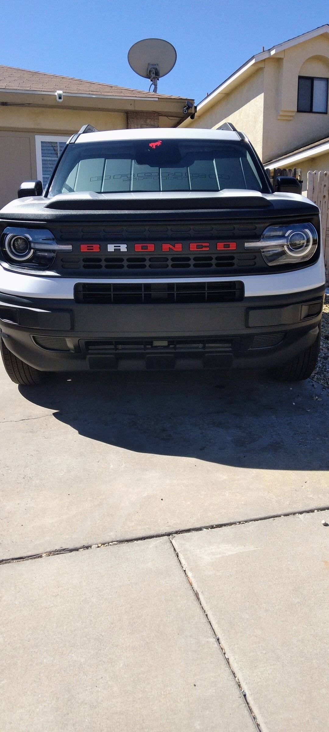

I’ve seen 3 different companies that make hood deflectors for the BB; AVS, Weathertech, and EGR. The EGR looks a little sloppy. I’m not interested in the Aeroskin II considering the controversy it holds. Was wondering if anybody has pictures of the Aeroskin I as well as the Weathertech low profile deflector.
Aeroskin 2
Ford Bronco Sport Hood Deflector Options 20220324_111840
