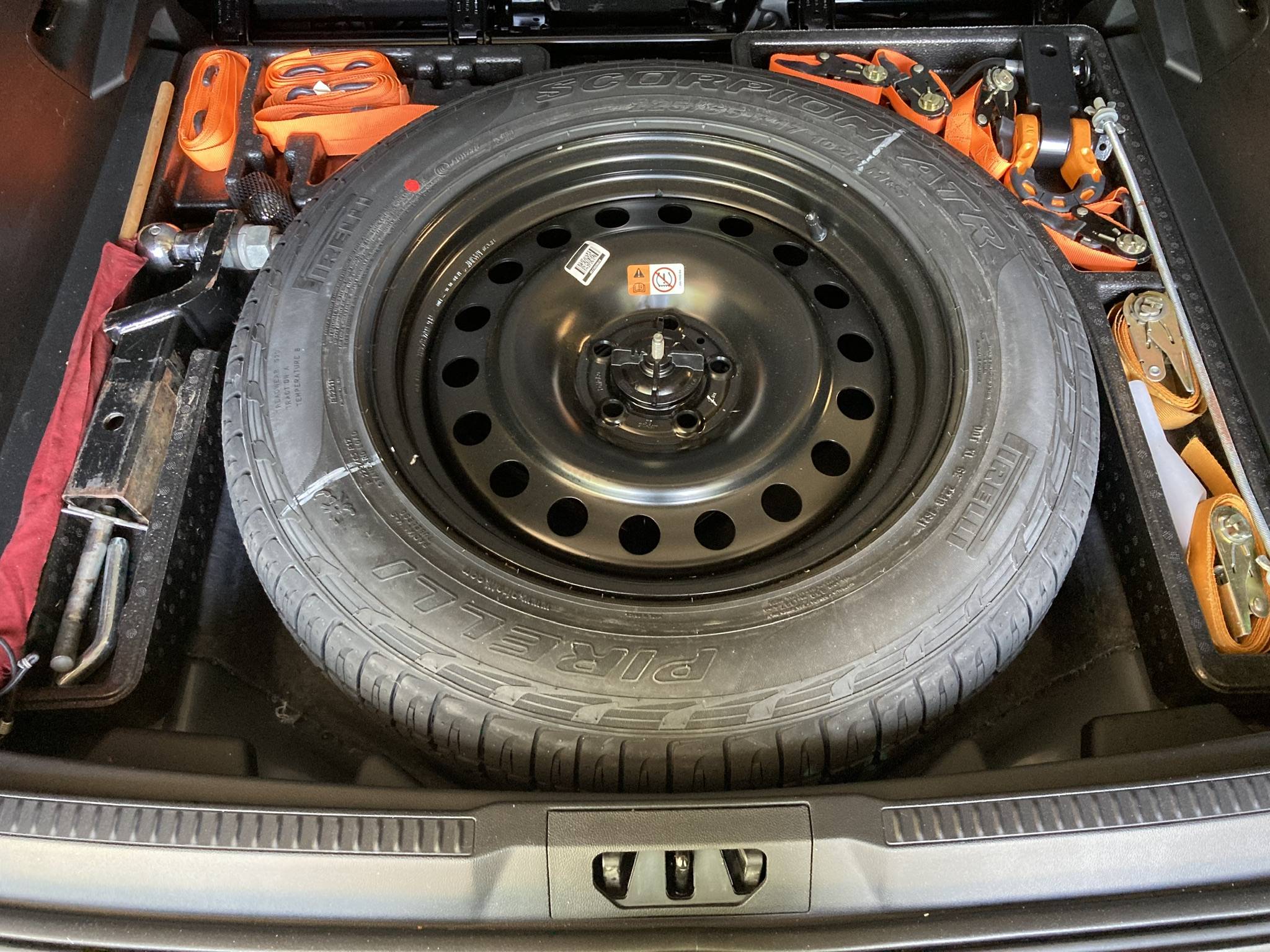

Good old steelies. I’ve got an extra spare to start you off. The Maverick steelies are silver if that suits you better.

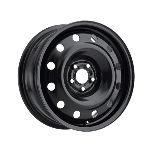

Check Discount Tire, Tire Rack and Amazon for 16" steel wheels. I found some in one of those places but didn't buy. Those Blizzak's are only $135, in a 225/75/16 at TR and are 29.3" in diameter, so they will fit in the spare area, as well. https://www.tirerack.com/tires/tires.jsp?tireMake=Bridgestone&tireModel=Blizzak+DM-V2&partnum=275R6DMV2&vehicleSearch=false&fromCompare1=yes
They also have the 235/70/16 for $150, if you want to keep the diameter down to 29.0"

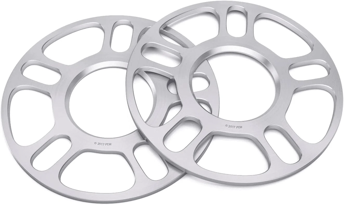

This is what I was looking at, at Discount Tire. 16x6.5, +41 offset. Should work with some 3-6mm spacers if you wanted to push them out a little. https://www.discounttire.com/buy-wheels/liquid-metal-atom/p/48999
