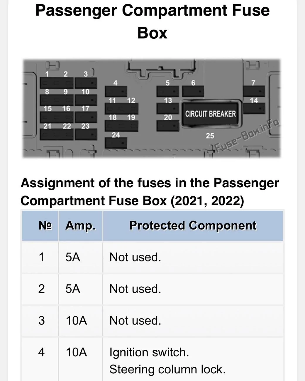

OP needs full explanation why fuse no.3 is unusable for this application
would schedule service mgr and tech both for meeting to discuss matter
check manual for amp draw on the sound system relay

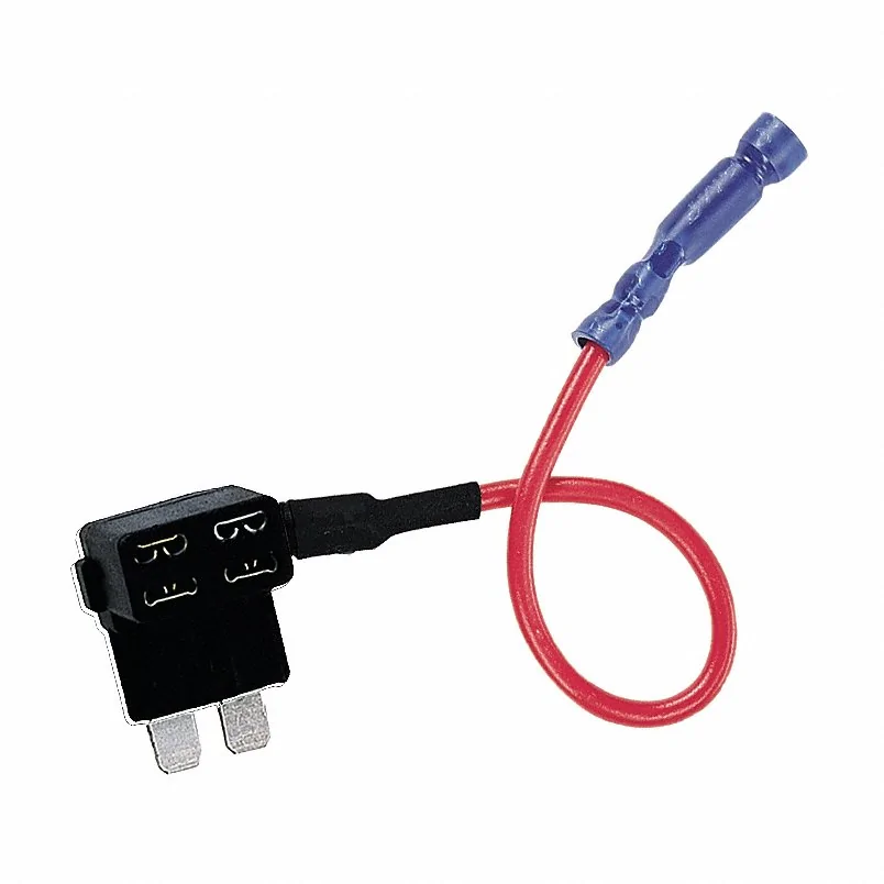

make sure the tap was positioned correctly (not installed backwards)
if tap is installed backwards the device will operate unprotected
unprotected it will draw as much current as wiring and device allow
lastly do not leave without finding out which fuse is acceptable for this tap
And For anyone wondering, the bottom of #3 fuse slot is the 12v side
Been using no. 3 for footwell lighting no issues with anything. Only very unlikely way I see it could be an issue is if somehow voltage could transfer back through remote wire. But even then it's fused anyways.
