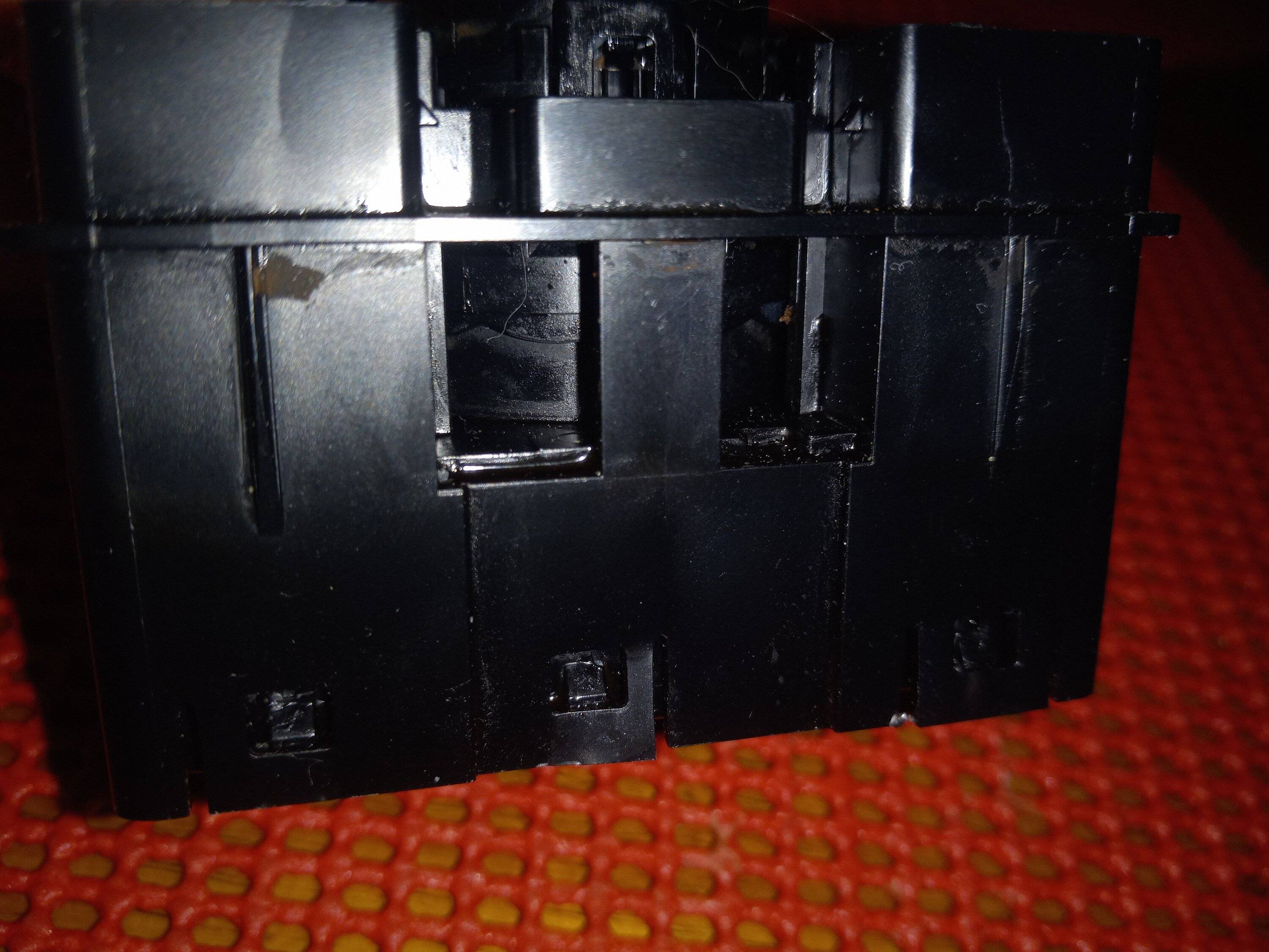

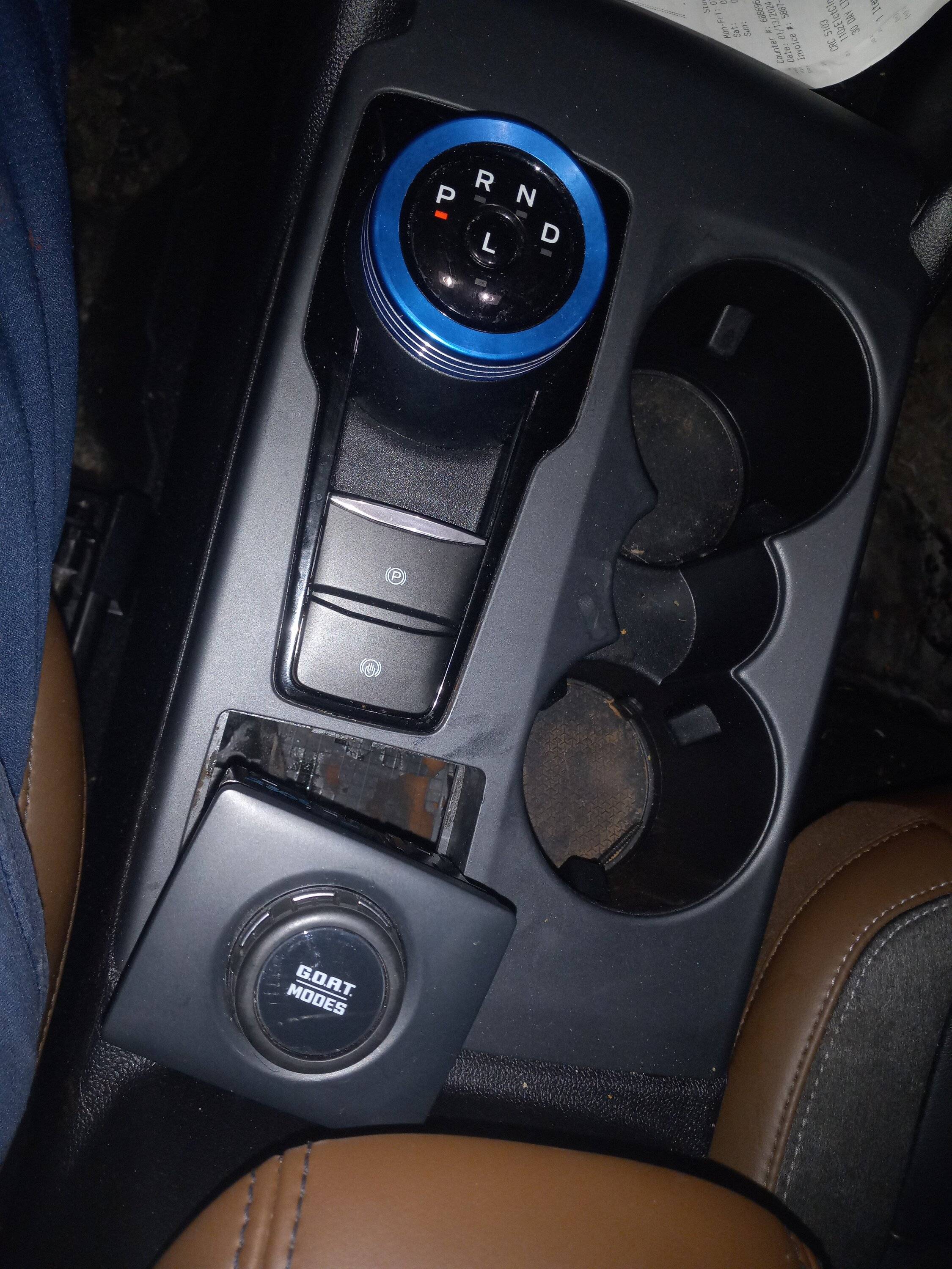

So I figured for the 66.00 it was worth a shot to save 300.00-400.00 at the dealer. The switch just snaps in and has one wire/clip that plugs in and it took me 2 minutes to remove/install

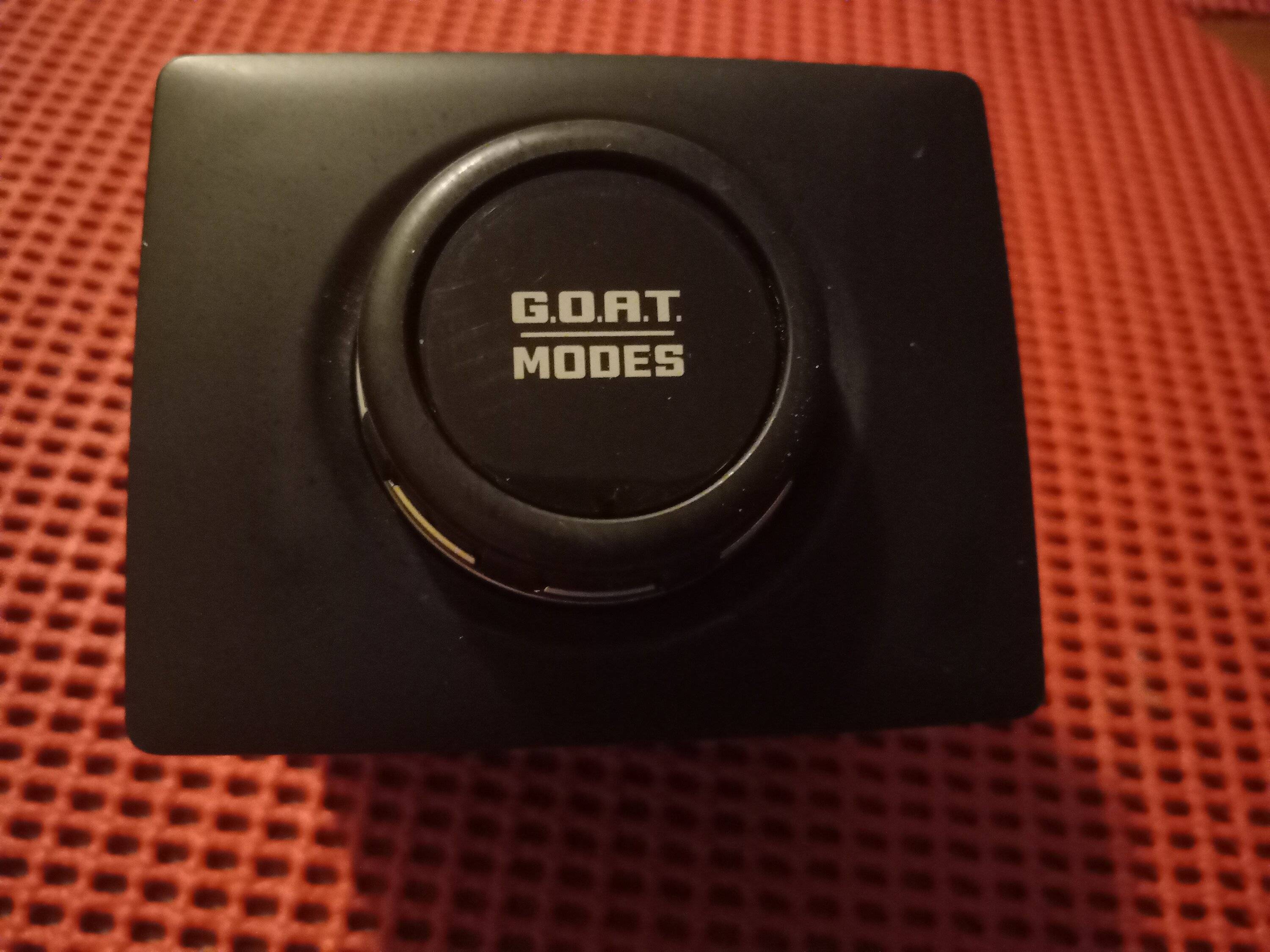

The first picture is of the complete new/used switch with top trim piece that hides the fact that its a non sealed switch, yes you guessed it next to the cup holders.

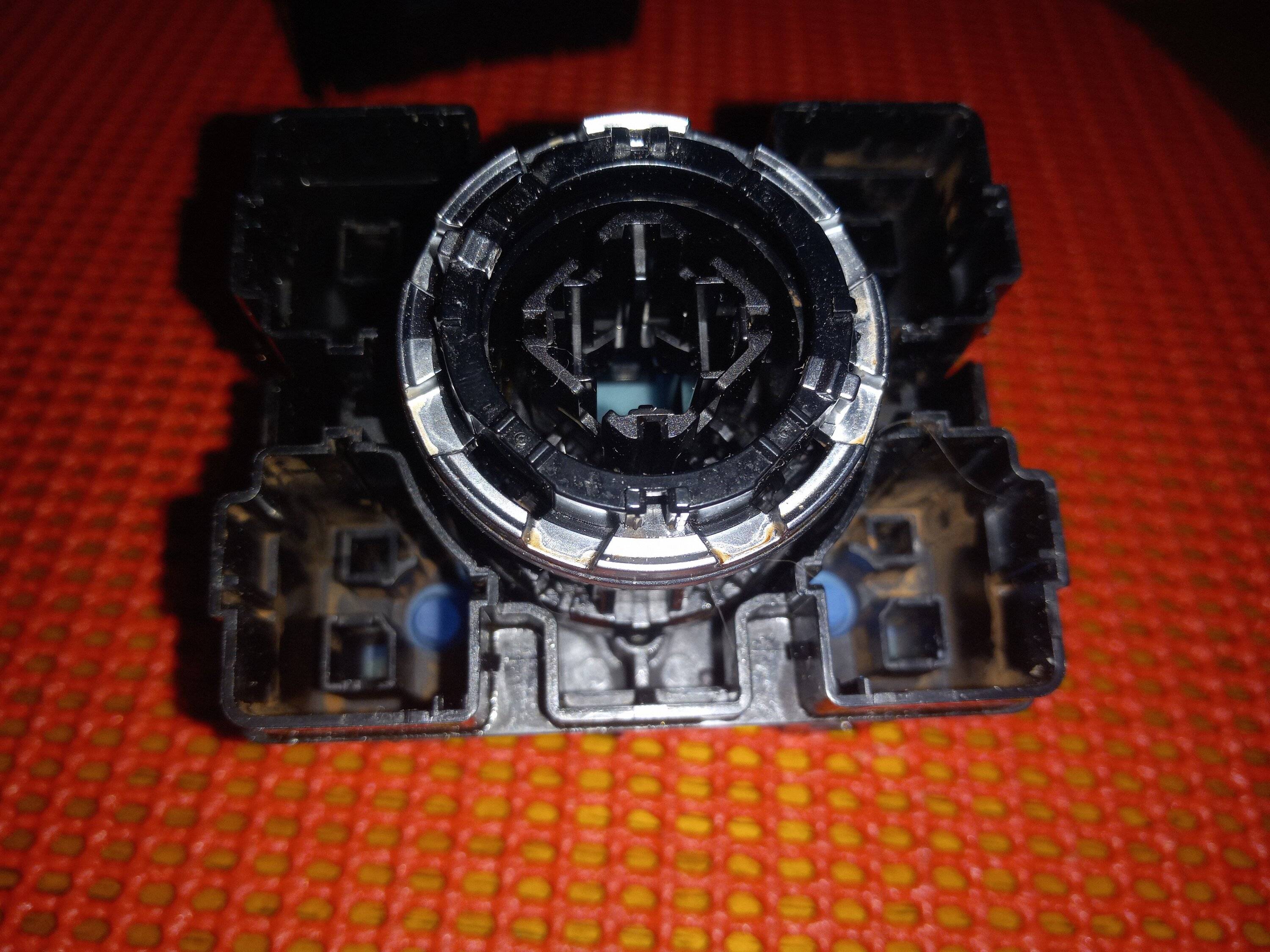

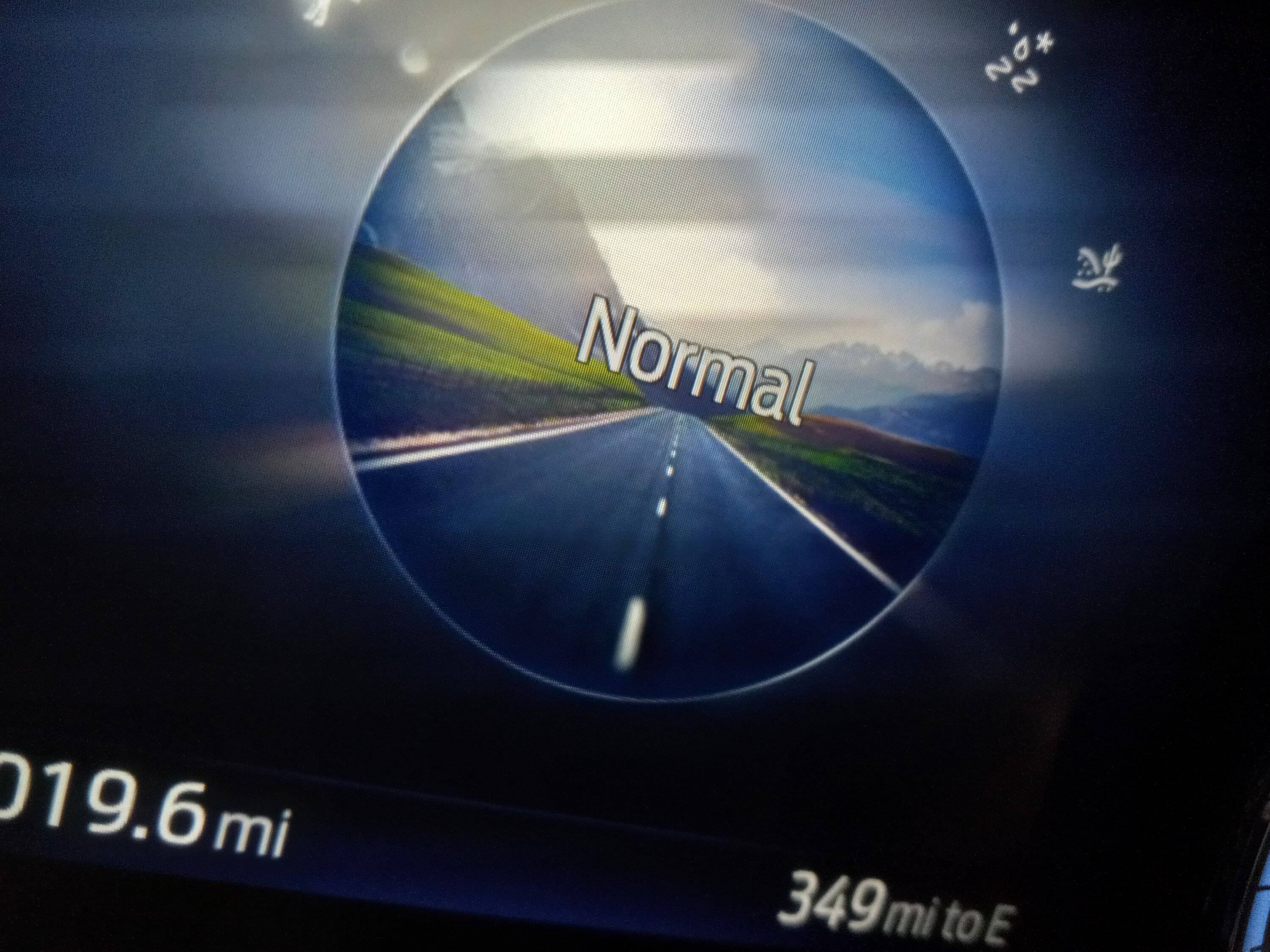

The next few are of the switch I took out taken apart. Then just some others of it working again.
So it's working again for less than 100.00 and did I mention its next to the cup holders lol.

I tried some electronic spray but it was shot. When I took it out and flipped it over the coffee poured out of it.

Did the peice around the switch just pop out with a screwdriver?

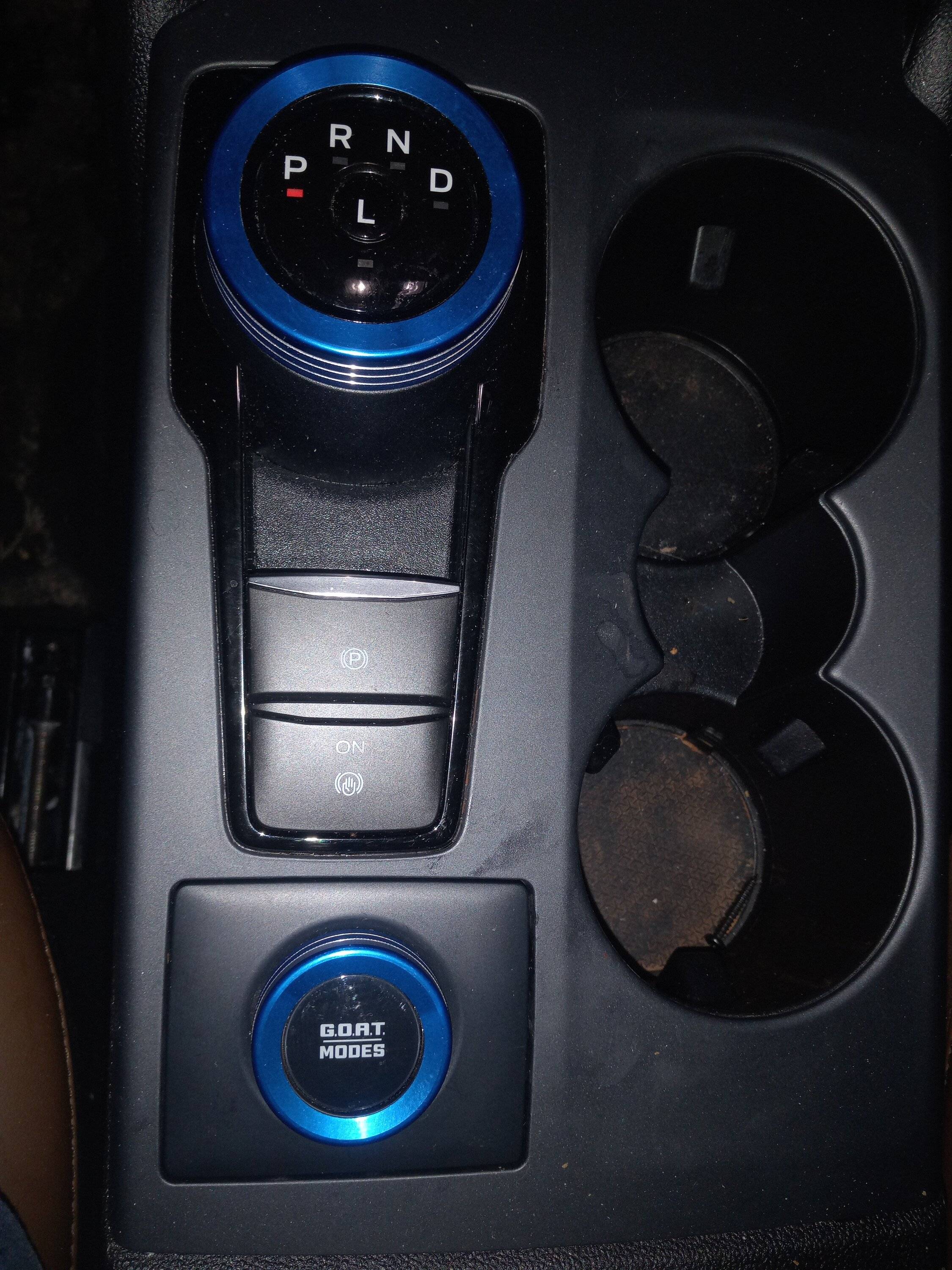

Hi everyone,

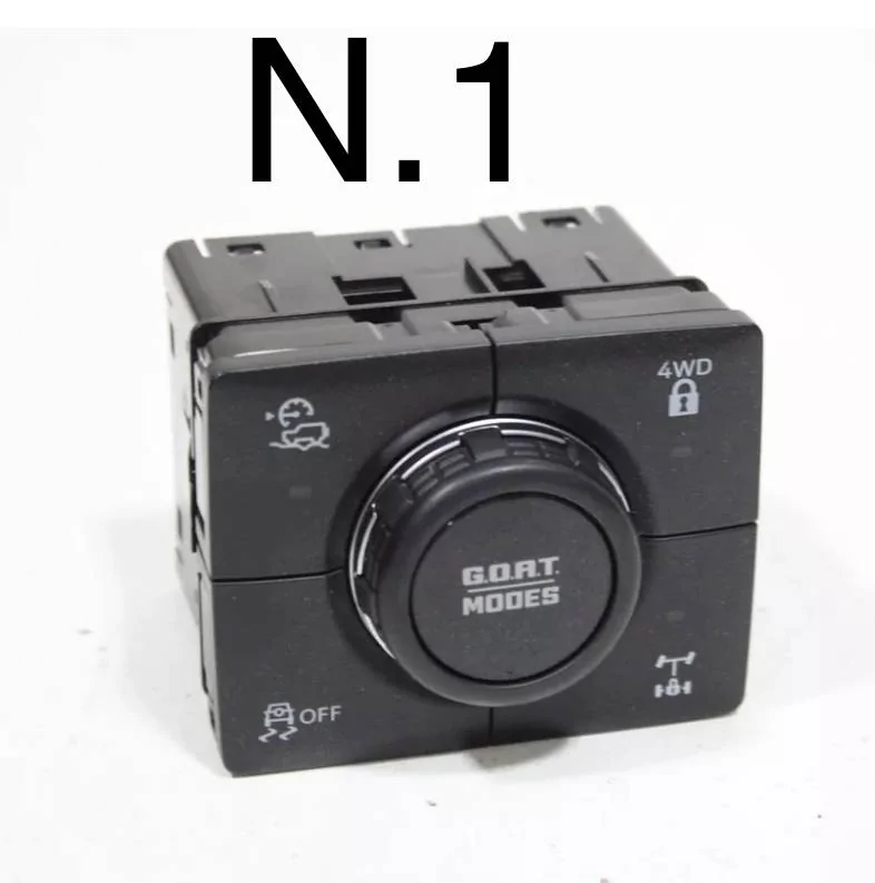

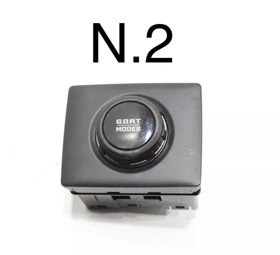

Does nobody try to put the badlands (N.1 image) goat mode switch on a outerbanks (N.2 image)or other whitout the 4wdlock, esp off etc…?!

The OuterBanks won't have the hardware to support the extra GOAT modes etc., so that's why they don't do it. Cheers!

The pin to connect is the same…so do you what happen if connected to outerbanks?! Does the round selector works the same but buttons not?!
Sure don t have some hardware but for example has the traction off in sand mode…so this button can work you think?!
