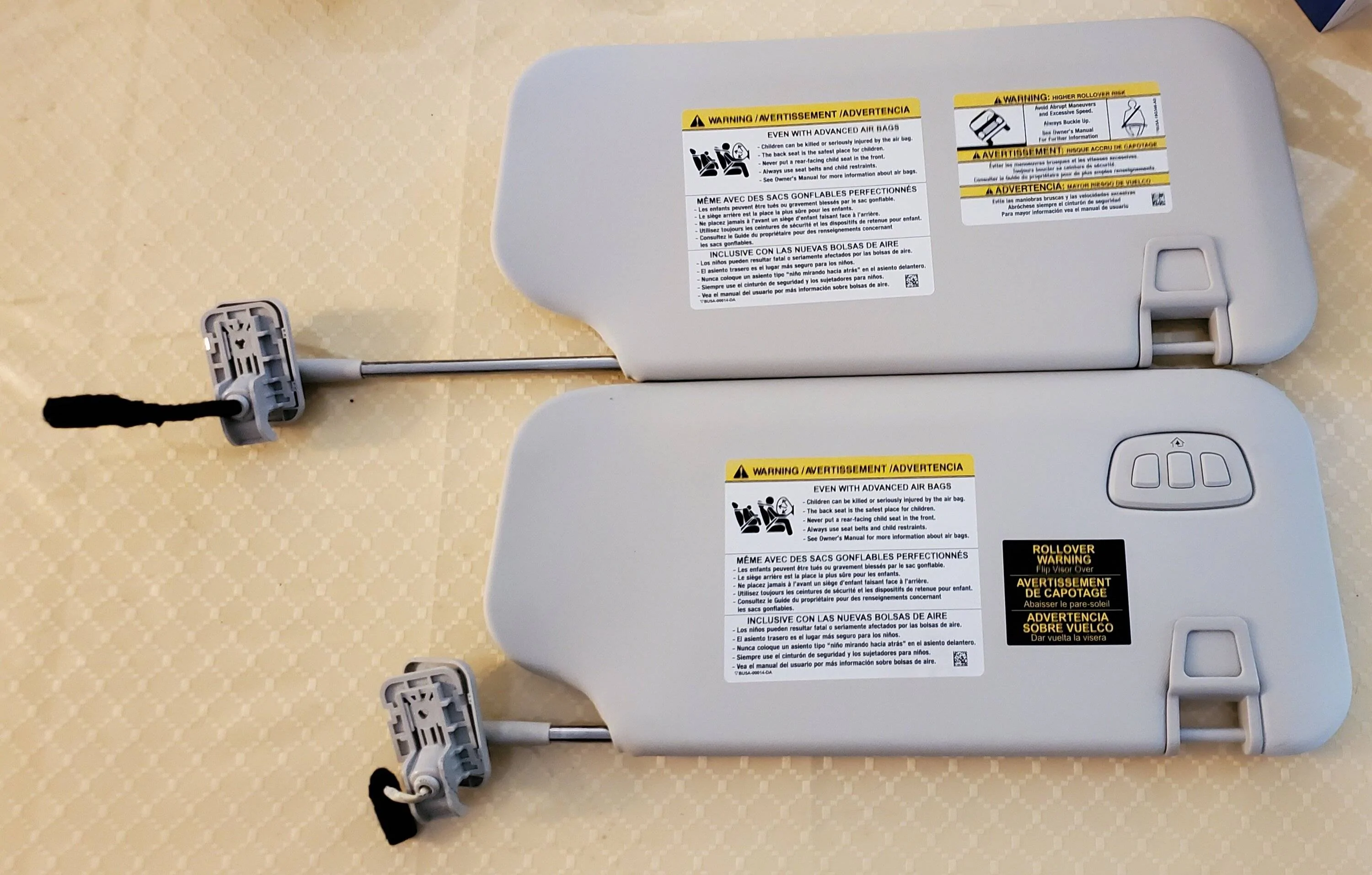

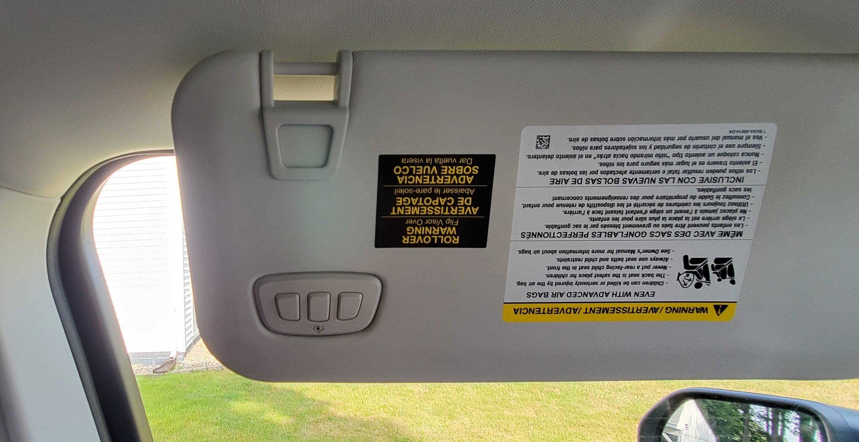

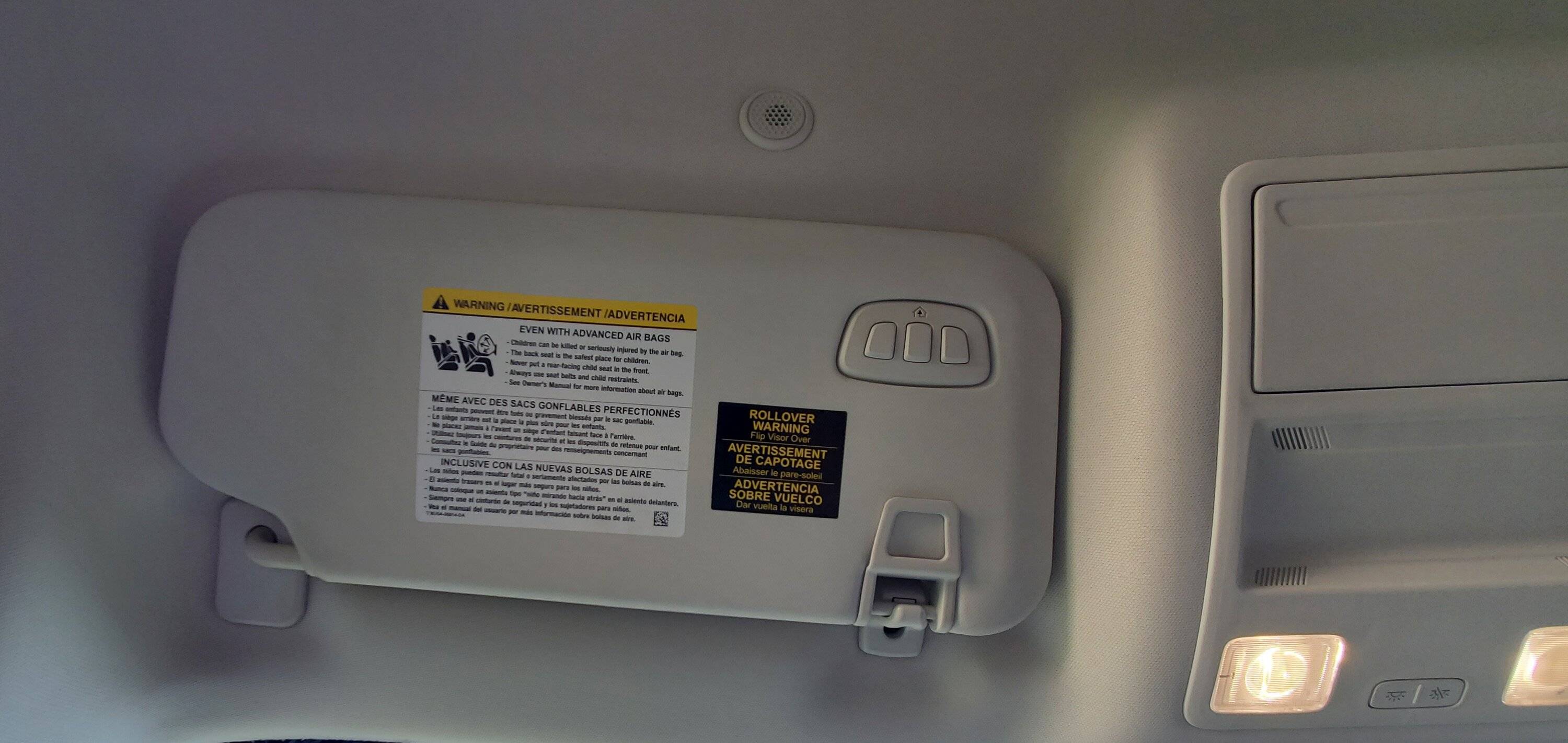

I just installed a 2000 - 2022 escape visor with homelink on my 2021 outer banks. As stated earlier, it wasn't available then. I think the color match is perfect. The replacement does have some dingy spots. They are currently un noticeable. As bjbena said, the escape visors don't extend as far when turned to face the door. This is the same as the 14 jeep patriot stock.
I spent under $100 and ordered from a salvage yard found on car-part.com.
Here are some pictures.
Programming was simple and I used the directions from the 2022 escape html manual.
https://www.fordservicecontent.com/Ford_Content/vdirsnet/OwnerManual/Home/Index?Variantid=8644&languageCode=EN&countryCode=USA&VIN=&userMarket=USA&div=f&buildtype=web
Search the manual for garage.
You will find directions to clear old remotes and re programming.
