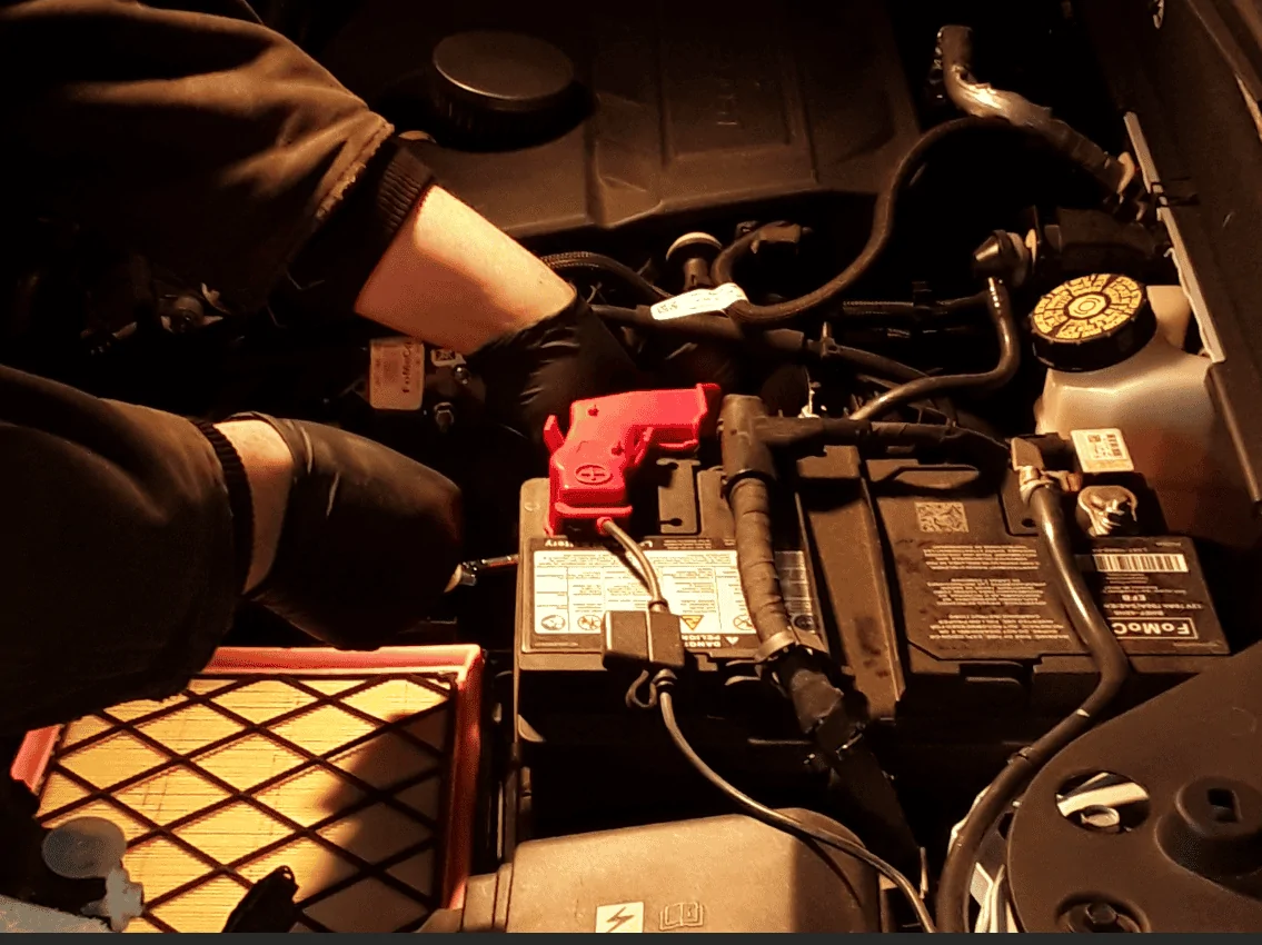

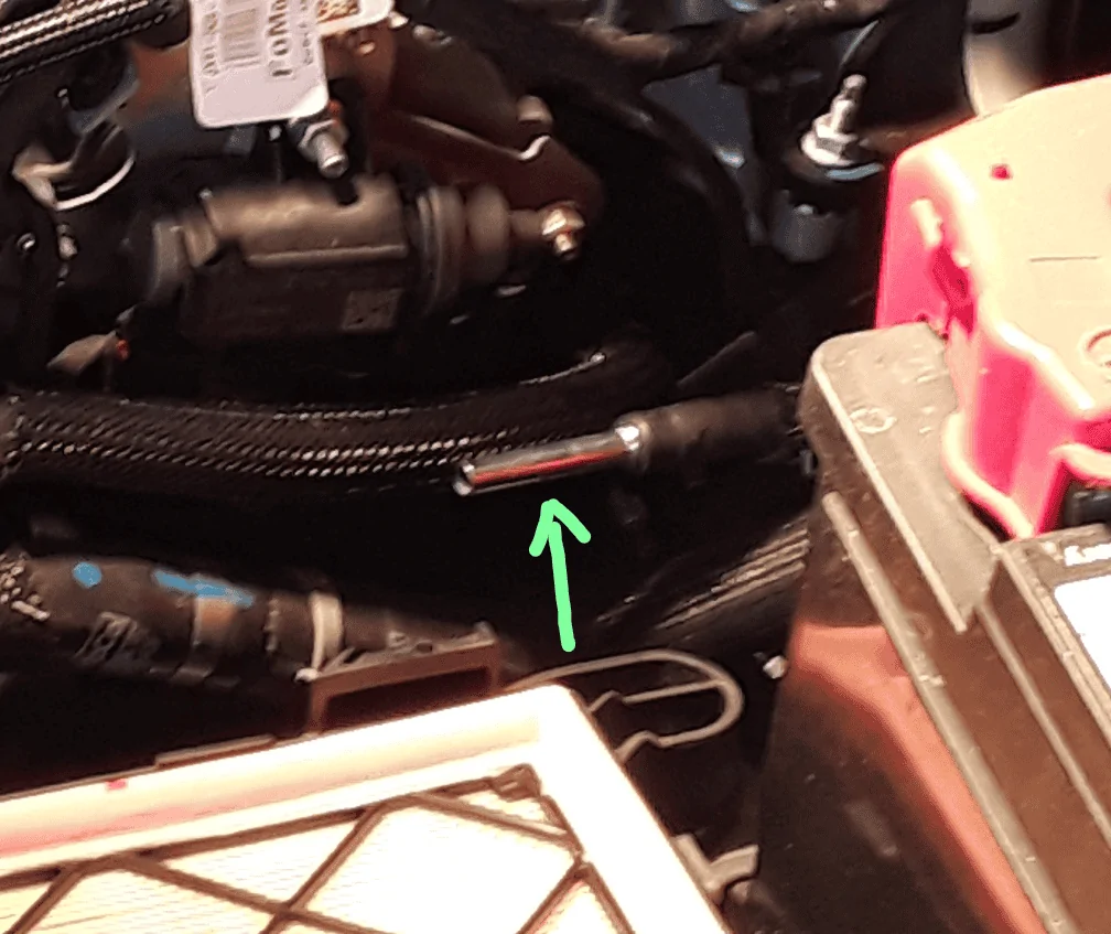

timeline aug 2023 notification of recall
march 2024 call from dealership
mobile service scheduled to resolve drain tube recall issue
well that was quick
wish me luck boys
50
2,262
3,237
Ford Bronco Sport Fuel Injector Recall 1711047038274-ca
Ford Bronco Sport Fuel Injector Recall 1711047142840-9e
Kong reporting back
thumbs up gang
no battery removal for install
modules sync'd updated and happy
