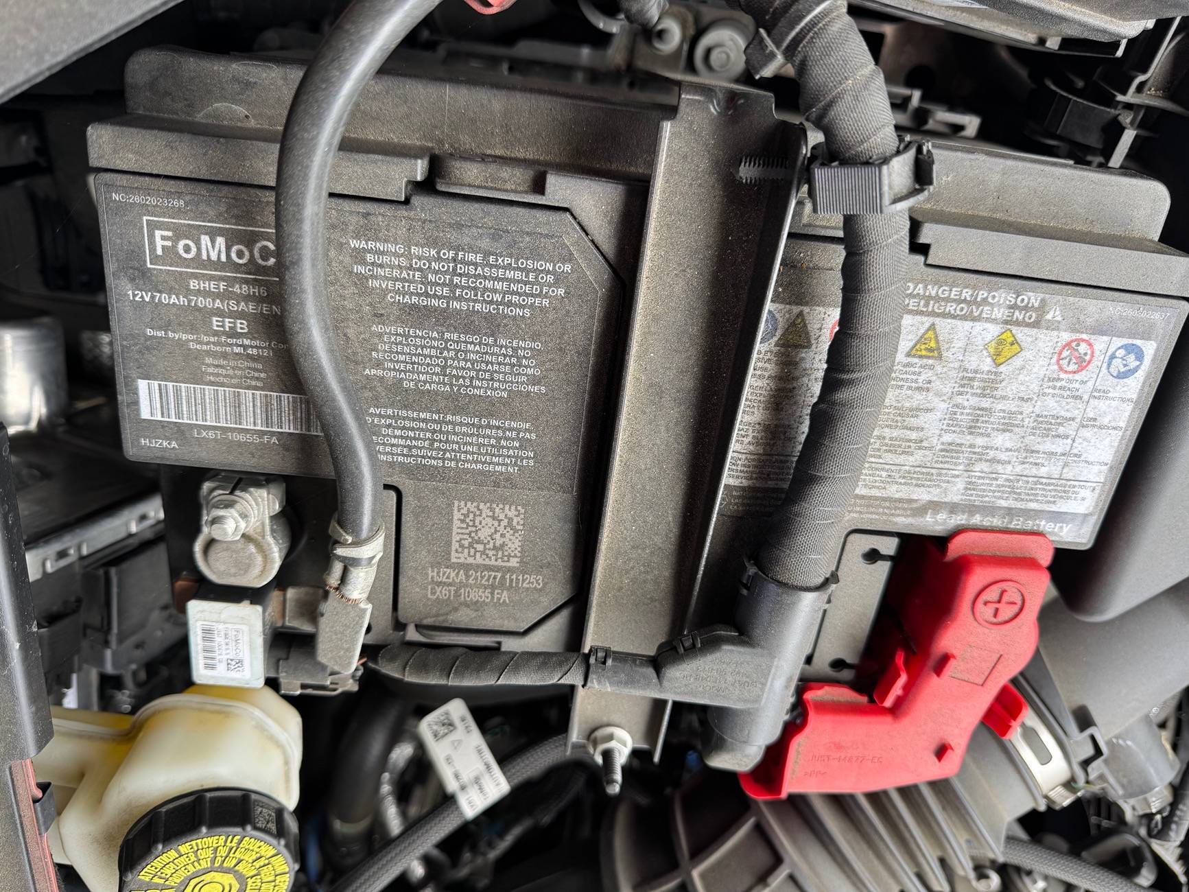

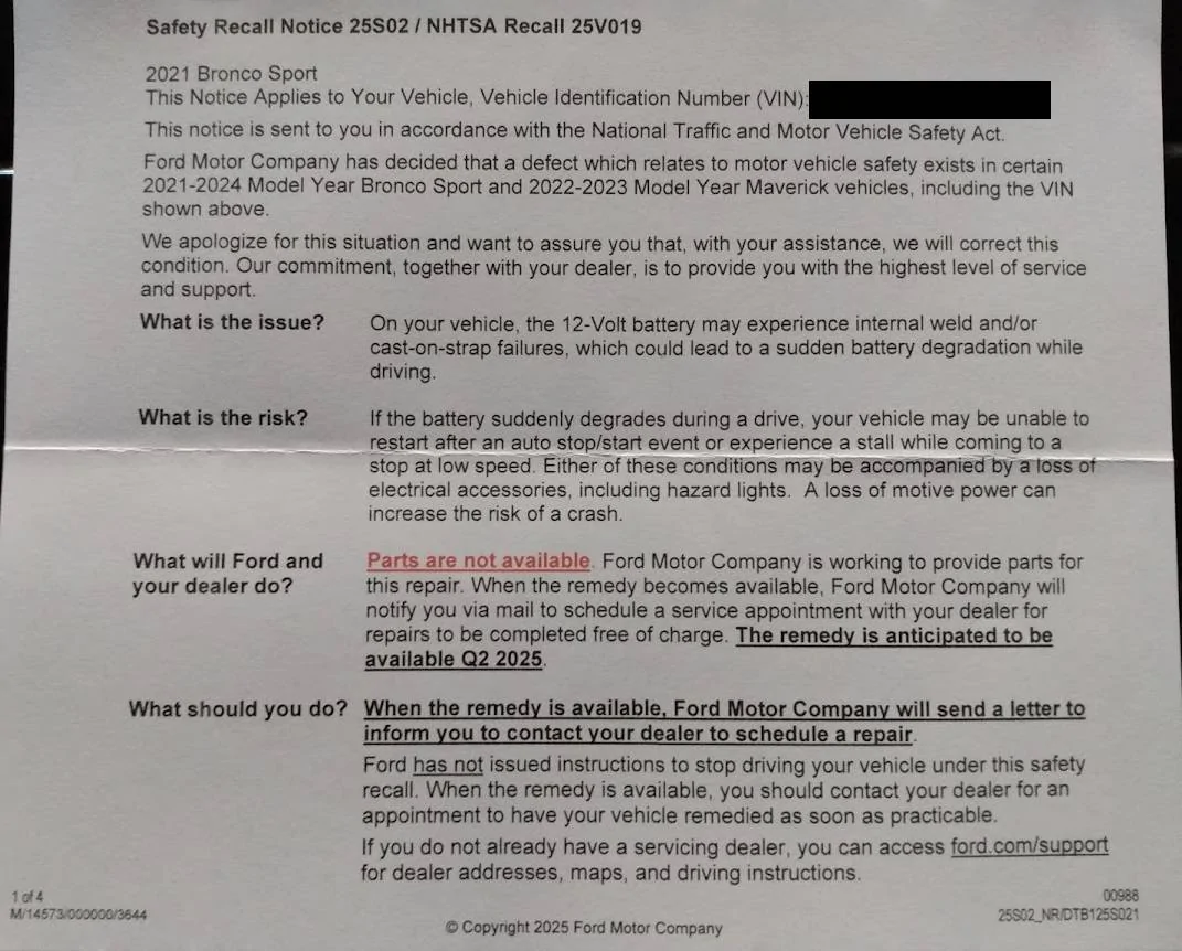

I just got the notice today. It doesn't specify what the exact remedy will be (says parts are unavailable), but I would have to think a replacement battery is in the works. I'll gladly take that after 4 years!! Mine came with a LA battery from the factory. I have not had a glaring issue, but I habitually used a battery tender to keep the battery in top shape. If I do not use the tender, the charge level goes down and the first symptom is the ASS system quits engaging. I bet the replacement will be the AGM version.
Ford Bronco Sport Ford Battery Recall - #25S02 IMG_20250211_094658529
Do you need to disconnect your battery tender before taking your BS to the dealer for the warranty replacement?
Will the dealer reconnect your battery tender after replacement?
