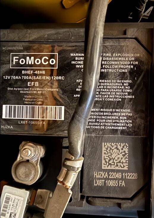

Only if your battery is one of the defective ones with Part number LX6T-10655-FA. The number is on top of the battery, easily visible.
oh oh!!!

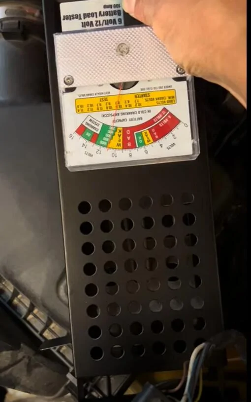

I just checked my battery and I got a LX6T-10655!! (22 Badland born on 2022 4th of July)
I have recieved a recall notice months ago and they checked my battery. appeared to be ok. I also got a simple battery load tester and it seems Ok. Tho...if I parked the car for a few days, then I plug on a trickle charger/maintainer, the indicator on the charger show it was at "80%". it took maybe 8+ hrs before it was shown charged to full again.
I have not received another recall, yet. I'm tempting to just buy an AGM battery myself and get it over with. but it ain't cheap, seems like they should be giving me a new battery.

sure is. 23k miles so far.
during the load test photo below. it is somewhat within range to be ok for 800 amp.
Ford Bronco Sport Ford Battery Recall - #25S02 1740343300941-1k

@WildFord .. sounds like your ‘22 Badlands is still in warranty if vehicle purchased new 7/4/2022 and currently at 23k miles … if your battery fails it’s replaced free under the factory warranty. A replacement battery under the factory warranty doesn’t get a new warranty - the replacement battery would be warrantied up to the original 3yr / 36k factory warranty same as the vehicle.
However … if Ford replaces the battery under Recall 25S02, you may get a longer warranty - we don’t know because Ford has not provided any details for 25S02.
