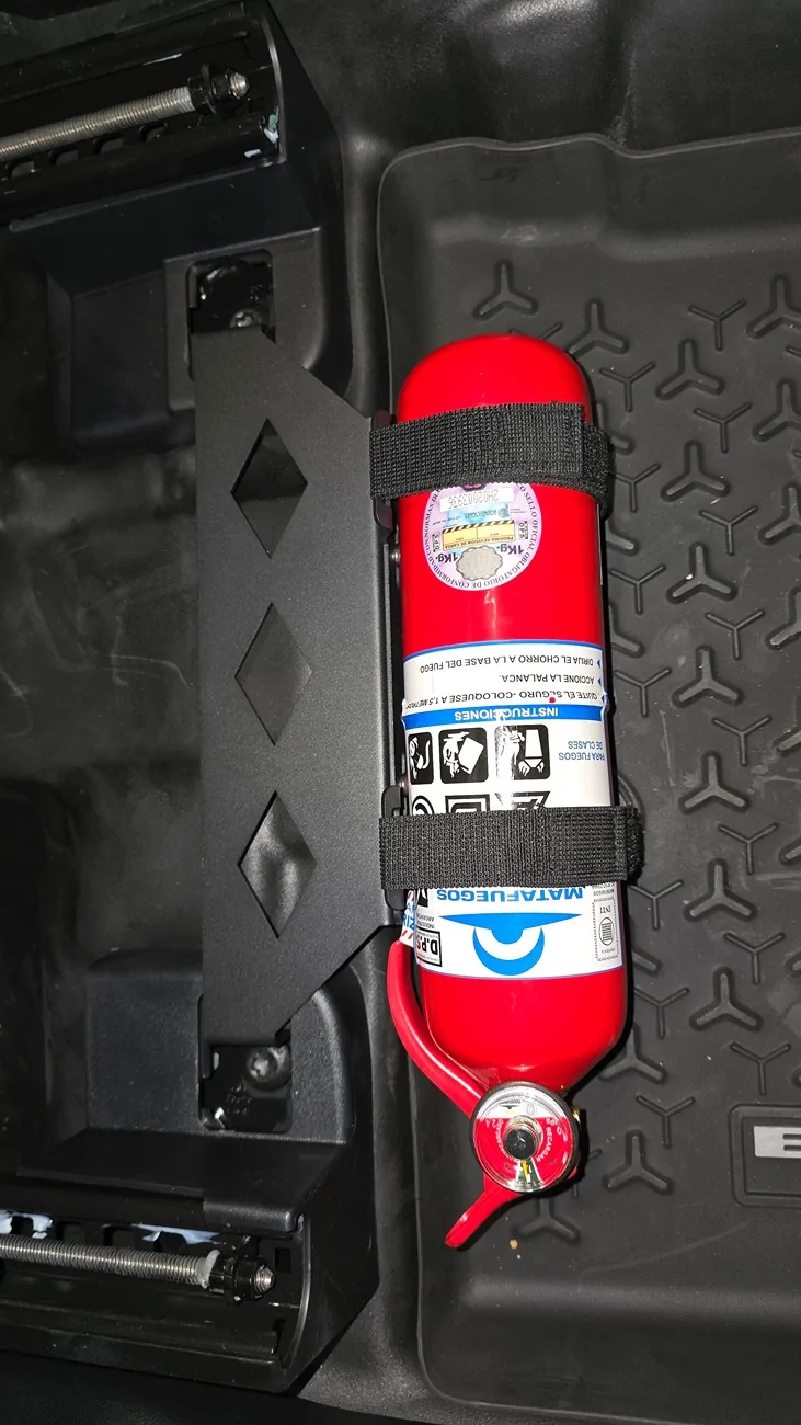

I recently installed a fire extinguisher mount under the passenger seat of my Bronco Sport and wanted to share a few photos of the process.
The mount I used is this one from Amazon:
https://www.amazon.com/dp/B0GDZQ32YJ
Installation was very straightforward and required removing only two factory seat mounting bolts.

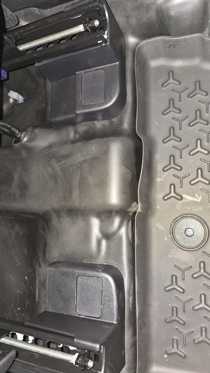

Before Starting
Ford Bronco Sport Fire Extinguisher Mount Installation 20260623_081125

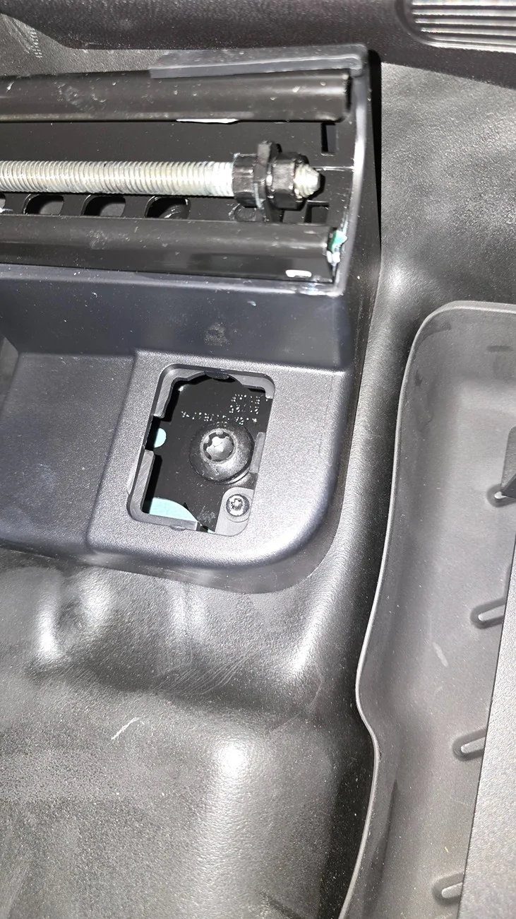

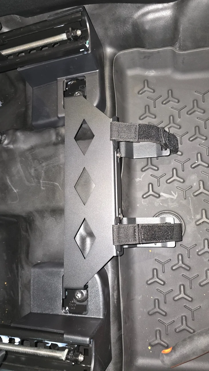

Remove the plastic covers and locate the two seat bolts that need to be removed
You'll need a T55 Torx bit for this step

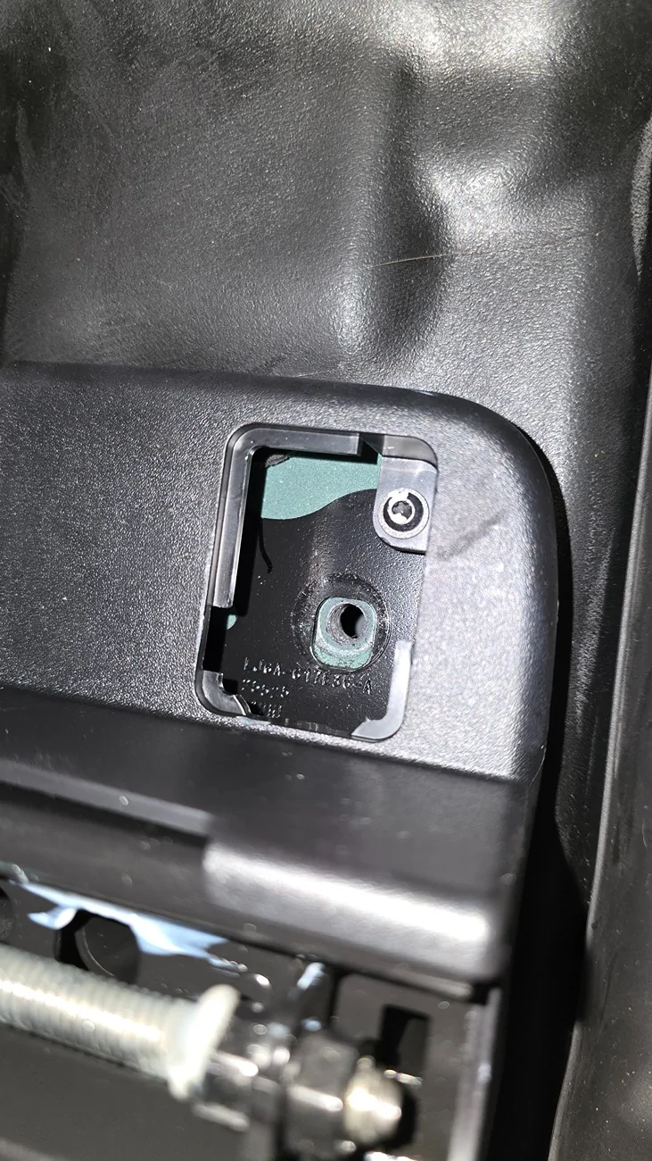

Ford Bronco Sport Fire Extinguisher Mount Installation 20260623_081807
Seat bolt removed
Ford Bronco Sport Fire Extinguisher Mount Installation 20260623_081813

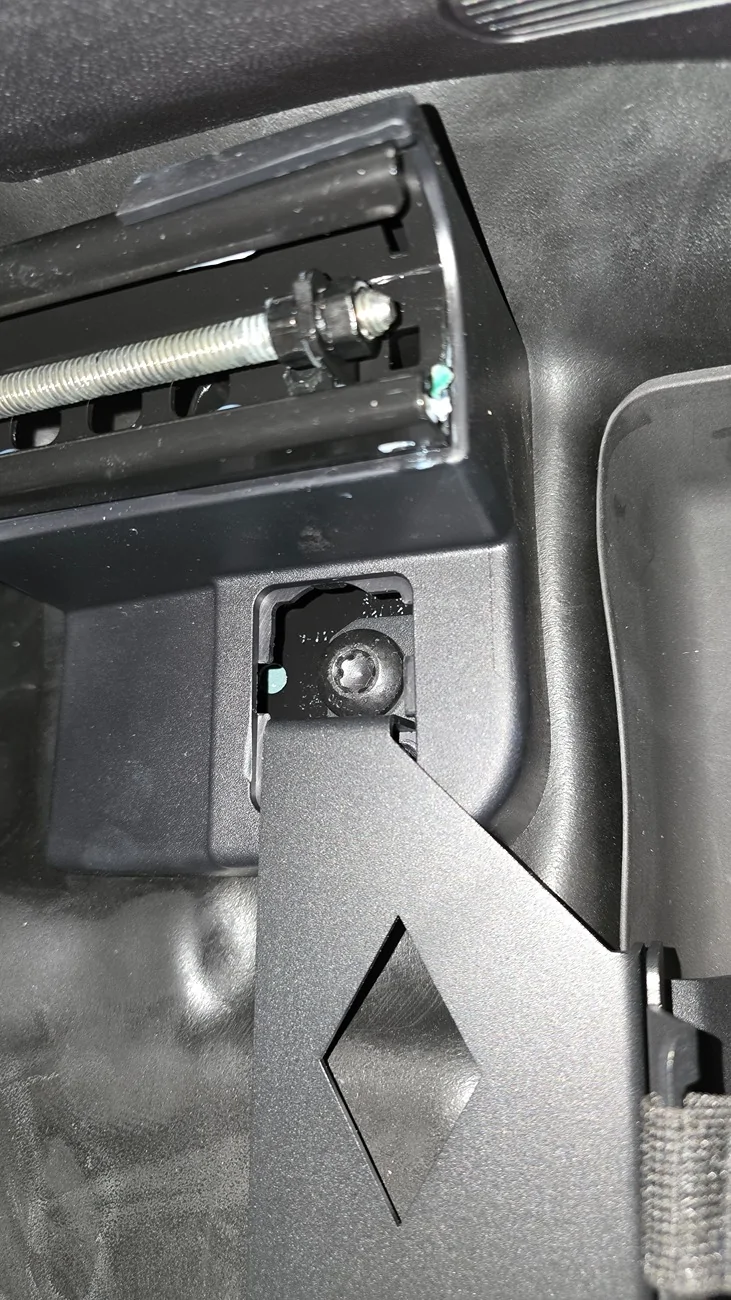

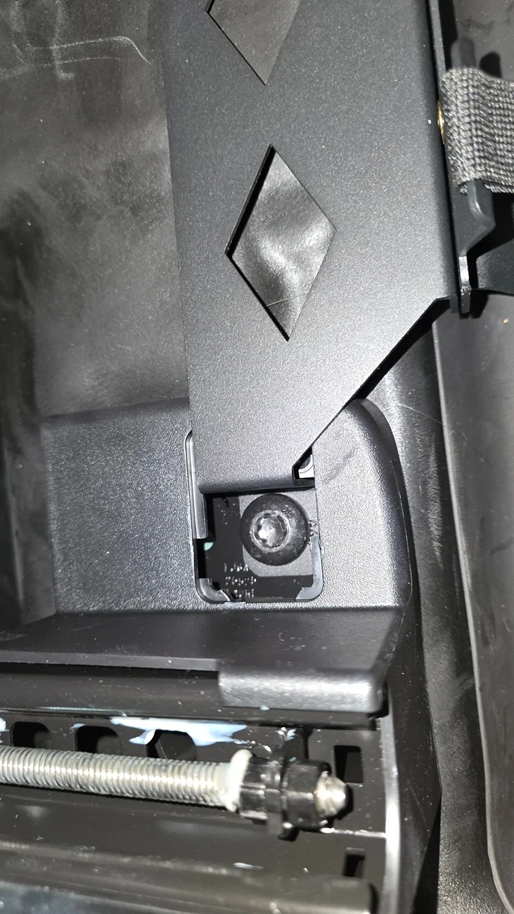

Position the bracket and reinstall/tighten the factory bolts
Ford Bronco Sport Fire Extinguisher Mount Installation 20260623_082245
Ford Bronco Sport Fire Extinguisher Mount Installation 20260623_082250
Bracket installed and ready for the extinguisher

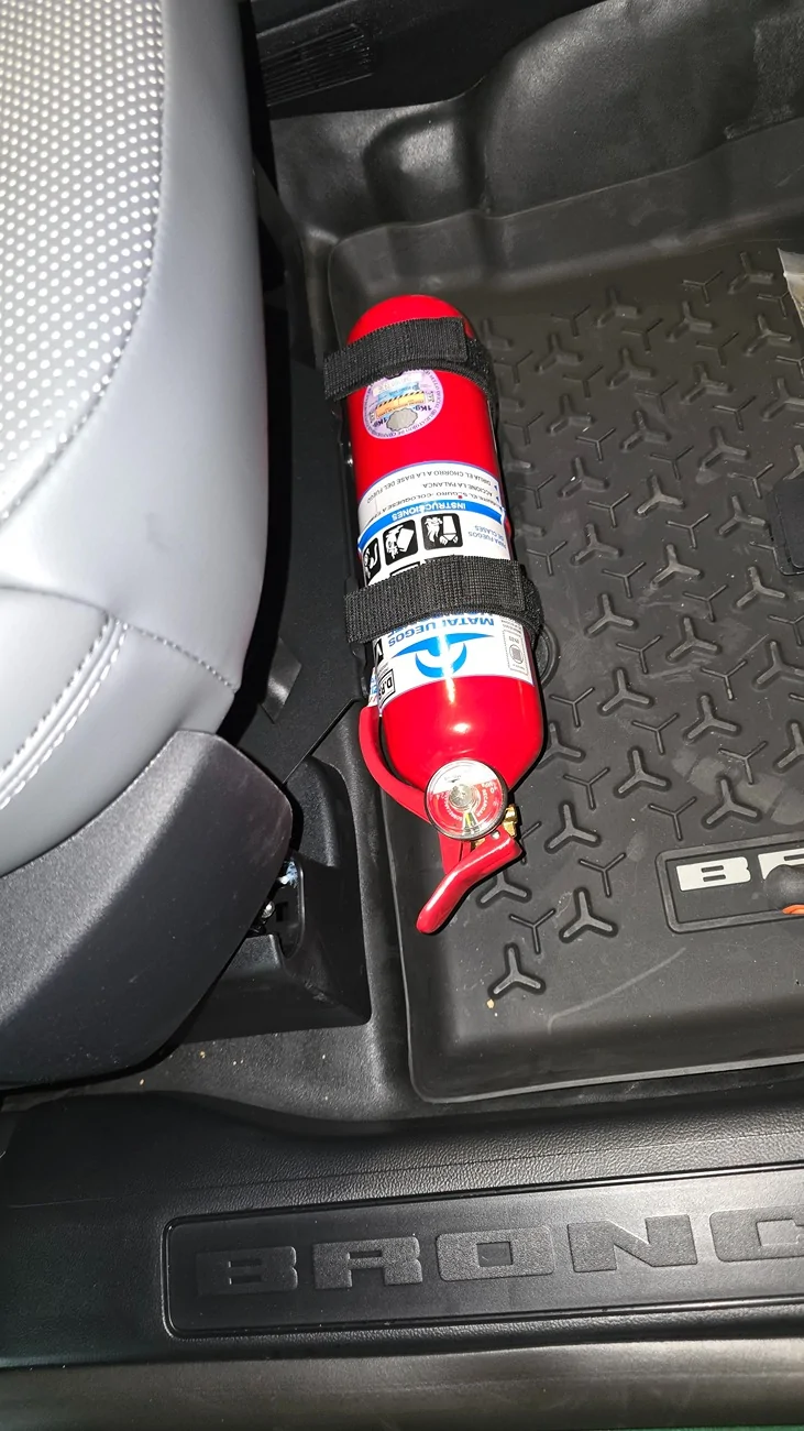

Ford Bronco Sport Fire Extinguisher Mount Installation 20260623_082257
Fire extinguisher mounted in place (seat fully moved rearward)
Ford Bronco Sport Fire Extinguisher Mount Installation 20260623_082601
Final position
Ford Bronco Sport Fire Extinguisher Mount Installation 20260623_082615
The mount feels very solid once installed and keeps the extinguisher secure while remaining easily accessible. It also doesn't seem to interfere with normal passenger seat operation.

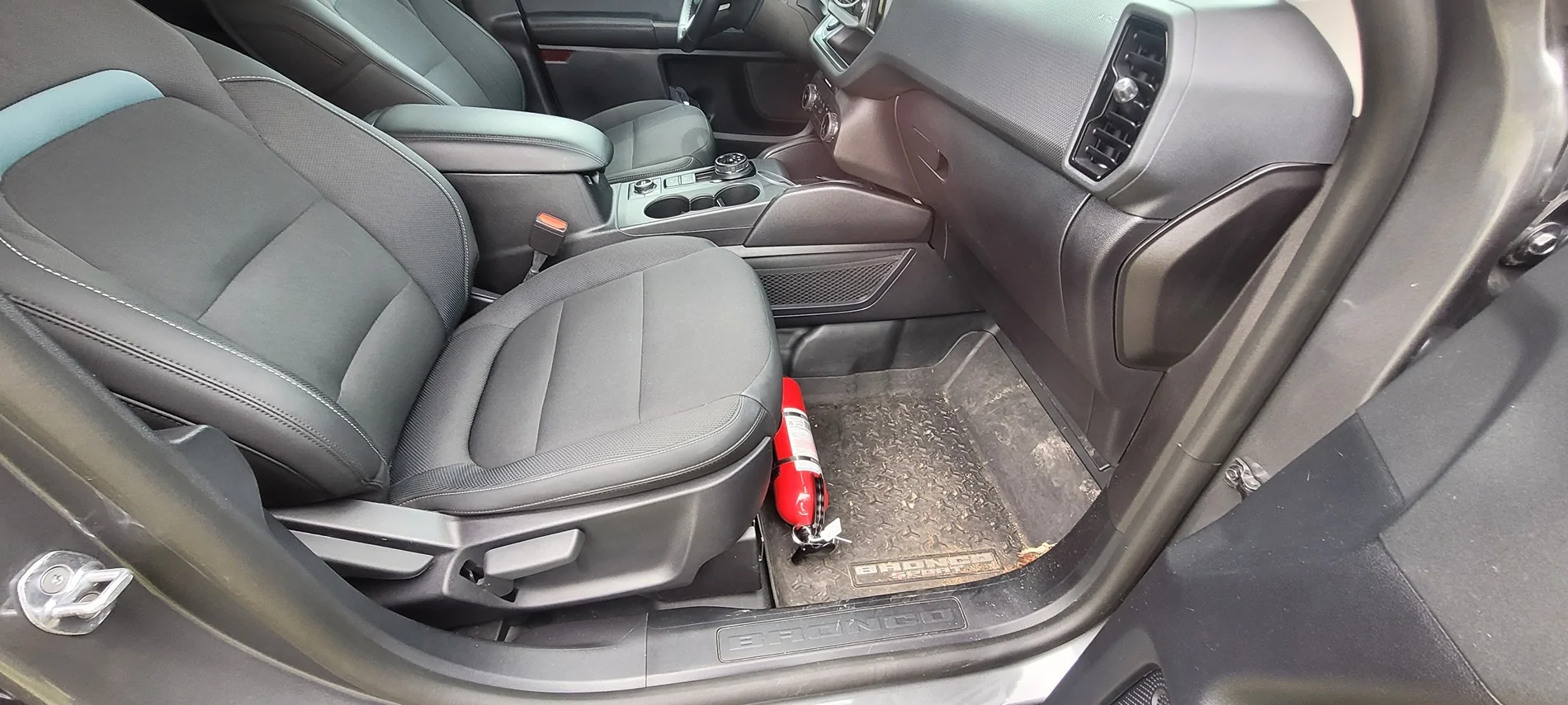

That's awesome! I've just been hanging mine from the MOLLE webbing on the seatback, and now on the seat cover (I still don't know why I got the front seat covers, the rear I got because of my dog, but had no reason for the front other than maybe to match and have an all black interior?).
The only thing I'd worry about with this is that a passenger would accidentally damage the gauge, or knock the safety pin loose.
I wonder if I could put a stiff plastic cover over the top to protect it. Seems like it shouldn't slow deployment by more than half a second.

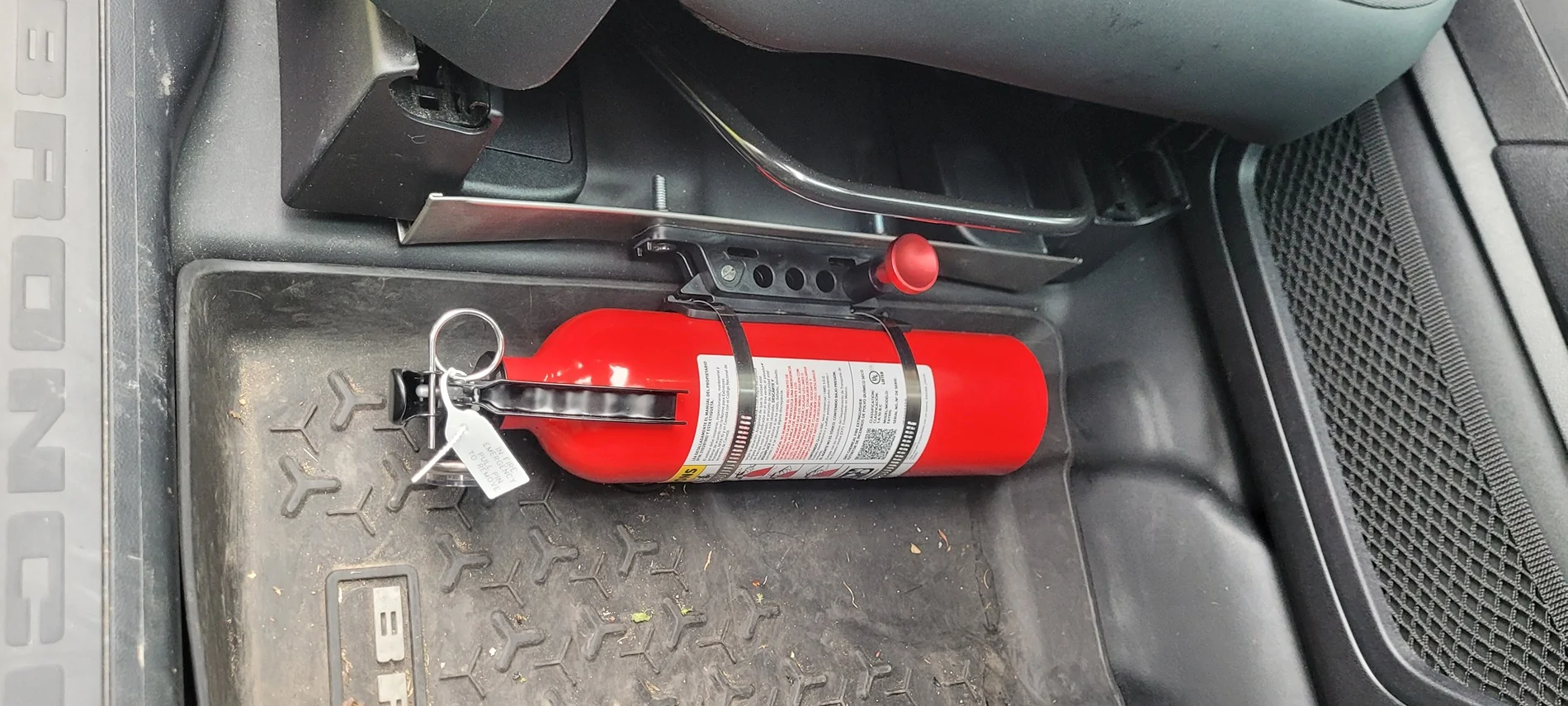

I have a similar one i built back in 2023, it doesn't rattle. (Link
(5) I built a fire extinguisher mount.(front passenger seat footwell) | 2021+ Ford Bronco Sport Forum - Broncosportforum.com
I found the key to having it not rattle is having it rest on the floor of the cabin using a light bend to keep the downward pressure, floating would rattle and lead to eventual metal fatigue as would "nearly floating" but pressure downward has caused no issues for me to this point.
That said I do want to modify mine so it has a spring loaded "eject" action(jsut add a spring below the mount to aid in one handed operations, simply pull the red knob and it pops out of the cradle. so you dont need to lift with one hand and other hand pulls red knob. I did have issues with the seat traveling full forward and backwards and bumping handle so I rotated the extinguisher so it was pointing more upwards, plus if the car is on fire it would be better for it to be "UP" vs down i figurd.
