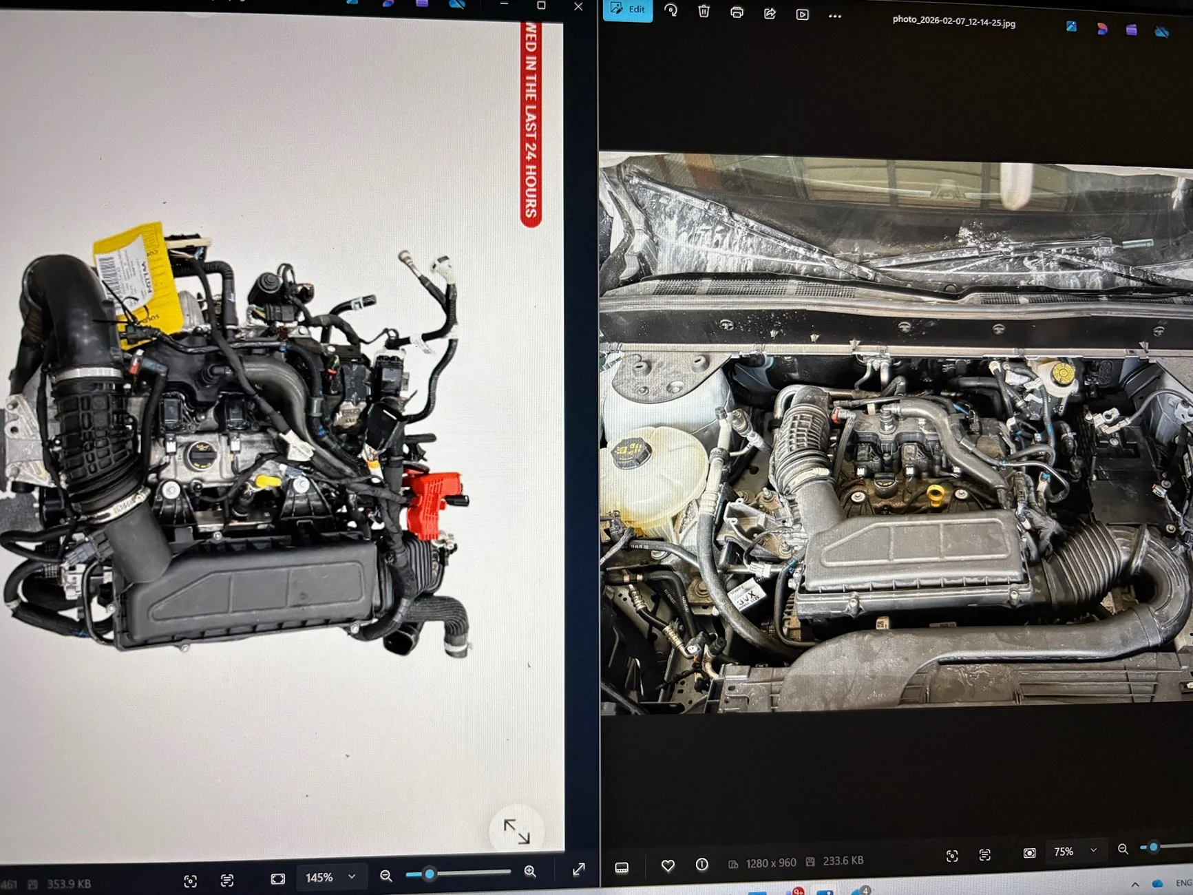

I just found out that 2023-2024 Ford Escape might have the same engine as 2025 Ford Bronco Sport and it’s cheaper.
Ford Bronco Sport Engine Swap Project: 2025 Bronco Sport IMG_4648
Ford Bronco Sport Engine Swap Project: 2025 Bronco Sport IMG_4649
Ford Bronco Sport Engine Swap Project: 2025 Bronco Sport IMG_4647
Since the 2025 You bought was wrecked and the engine is messed up IMO this would be the best swap. Since I bet the electronics are pretty close to the same or are the same as Your 2025 since the 23-24 Escape 1.5 EB is the same as what's in Your 2025.
Agree. Anything that is different can probably be swapped from the old take-out engine to the "new" Escape engine.
My good friend did this with a Focus ST 2.0L EB. Bought it with a known engine issue and found out the 2.0L EB used in the Taurus was the same basic engine, minus the cam cover and a couple sensors. He picked up a low mile used 2.0L out of a Taurus and set them next to each other. The two engines were 98% the same, and the only differences were corrected with minor bolt-ons (cam cover and crank sensor/bracket are two things that I recall) being swapped from the old to the new engine. It's been his daily driver for at least 2-3 years and he's had no issues with it.
I THINK using the Escape engine to replace the damaged BS 1.5L would be a similar situation.

I ended up getting a 2024 Ford Escape engine, and it fits perfectly. Everything is the same, and the car started right away and is running smoothly.
